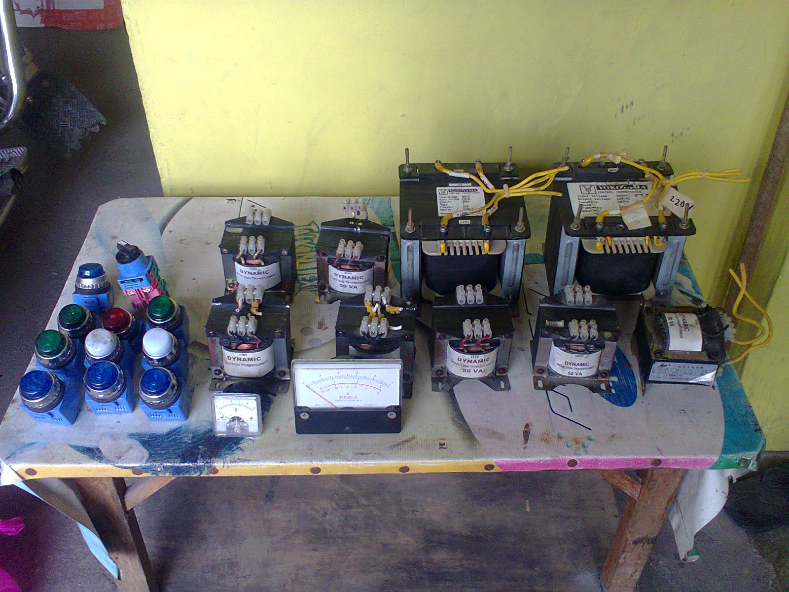

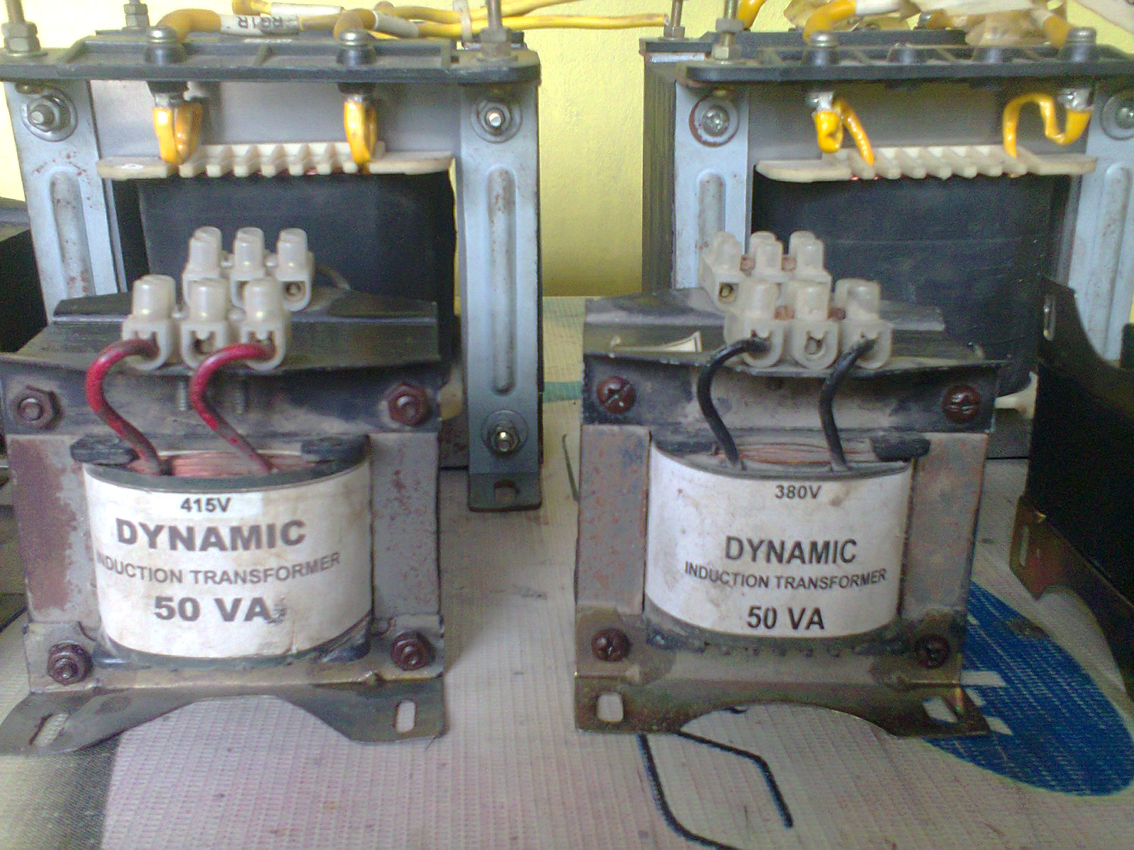

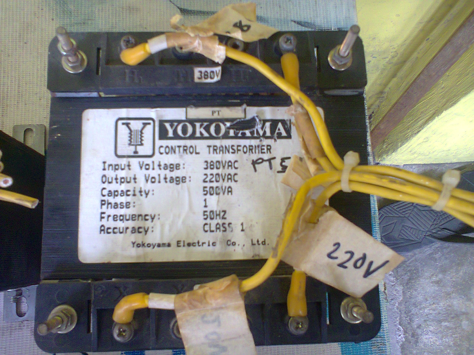

I also got this things from a local surplus store...50va (pr-380v/sec 220v), 50 va 415v pr and 110v sec at 3usd each and two 500va (380 primary and 220v secondary, 50hz) at 15usd each...
