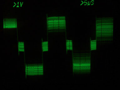

44kHz samling freq. gives 1 sample per halfwave for 20kHz sine ?
Is it true ? Looks like that on my scope.
So resolution at 20kHz is only one bit out of 16bits for each halfwave ?
4xOS gives 4 samples but only interpolated.
That's correct.
Even though it looks hideous, theoretically* your 20KHz sine wave is perfectly represented at a 44.1KHz sampling rate.
*neglecting 16-bit quantization noise, zero-order-hold attenuation, system noise/distortion, assuming a perfect reconstruction filter to eliminate images, etc.
Re: 44kHz samling freq. gives 1 sample per halfwave for 20kHz sine ?
You still have 16 bit resolution, but only 1 sample (with 16 bit resolution) for every half wave.

Indeed, in fact you should look at it as 2 samples each 16 bit for a 20kHz wave. The reconstruction filter, which is an integral part of the D-A conversion process, will make sure you get a nice sine wave. That is the background behind the Nuiquist criterium: to reconstruct a given freq you need at least 2 samples to nail down the level and phase, so you can convert frequencies up to half the sample rate.

Well, 44.1 or 192kHz gives the same reconstitued sine at 20kHz from 2 samples or 6 samples or what have you. The difference lies in the noise spectrum. The higher you sample, the higher the noise turns up in freq, so the easier it is to filter out. At 44.1 kHz you would need a brick wall filter at 22kHz to get rid of all the noise, and brick wall filters don't exist in analog. They do now, of course, in DSP implementations. So, there are different issues, that are related, but not interchangeable.
But, how counterintuitive it feels, 2 samples will nail ANY wave, provided you take care of the postfiltering.

Um, no. You have very good phase resolution. In fact if you have a full height (i.e. +32,767 to -32,768) sine wave at 20kHz you have a phase resolution of well under 1/100th of a degree. At lower amplitudes it drops proportionally. Only at an amplitude of the LSB do you lose most of your phase resolution. Think about the amount of information in the stream.

That is why the post-DAC filtering is AN INTEGRAL PART of the conversion process. It only works as advertised if you include the filtering.

I don't know exactly what the 'mostly unfiltered' DAC is, but if you skimp on the filter, you get the noise in the upper spectrum in your signal, the familiar staircase components.
Perceptually, if you are not experienced in recognising it, you will get the impression that your system is bright, clear and analytical. But, that's the perceptional side of it.

If you have 2 samples @ 20kHz you have 20 samples @ 2 kHz and you already can see the stairs on a scope.
Bernhard said:If you have 2 samples @ 20kHz you have 20 samples @ 2 kHz and you already can see the stairs on a scope.
Oh yes, that is also the reason why it is so difficult to find a good opamp for an I/V converter. That opamp has, in theory, to respond to those staircase steps with the risetime of that signal. Not easy.
