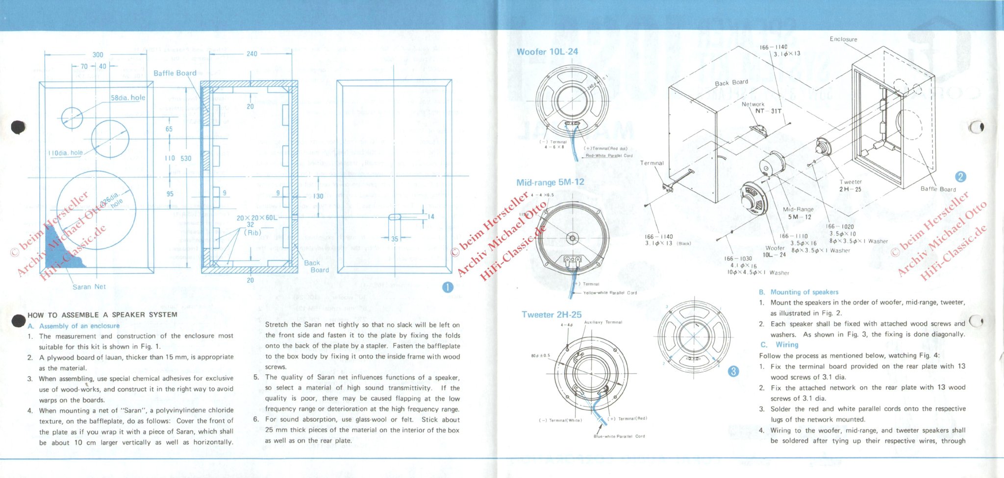

Hi! got hold of a pai of coral 3way speakers. want to design a new enclosure to maximize the potentioal of the drivers, any suggestions?

First off, we would need to get some accurate T/S parameters of your woofer. Would you know of someone close by that would have the appropriate gear to measure out this? Second, the cabinet material is "wanting"...we see here the common & inexpensive pressboard, upgrading to a seven, nine ply void-free birch plywood would be much better. Third, a differing enclosure ratio would be more aligned with "modern" styles. Forth, driver alignment along with baffle-step brainstorming should make for better imaging.

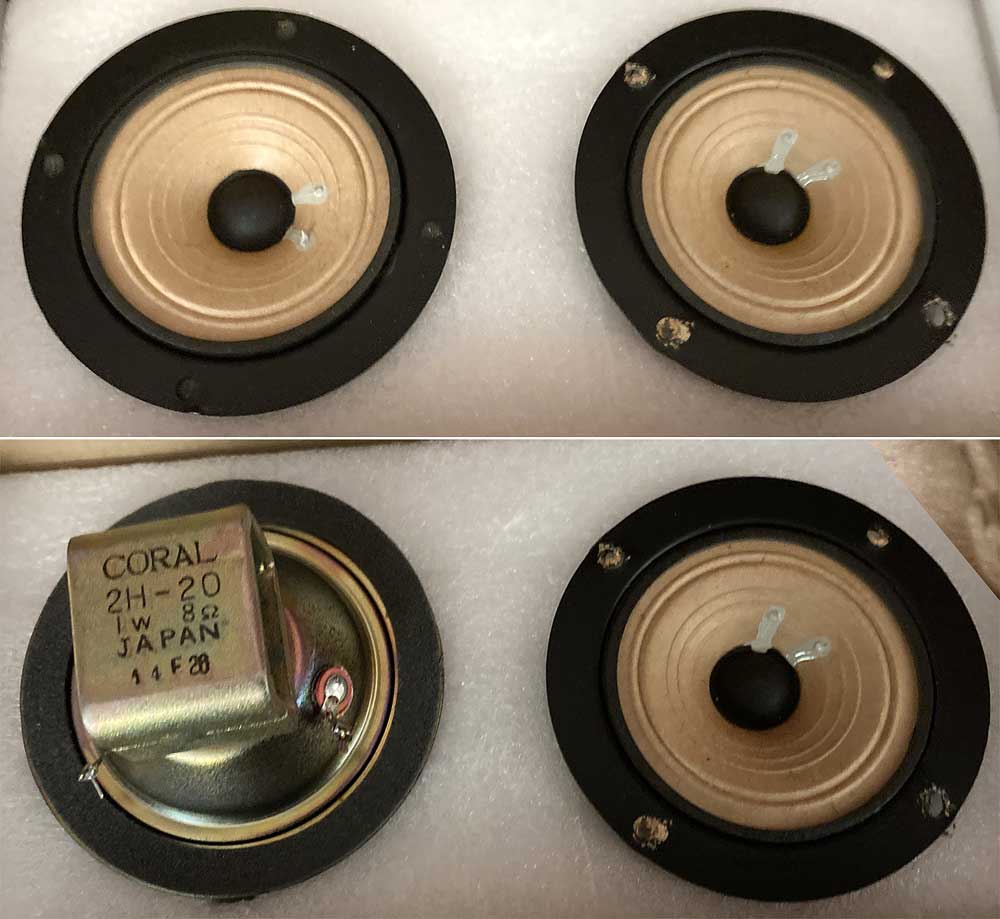

I have seen a number of 2H-20 tweeters, very nice, is this what yoyrs look like from the front?. I have also seen those woofer baskets, but OEM units with no Coral name.

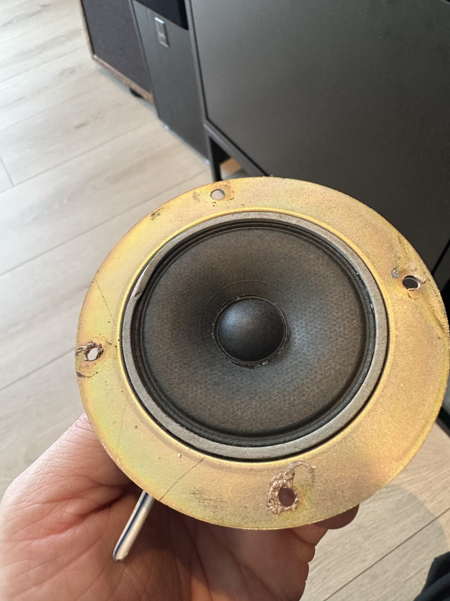

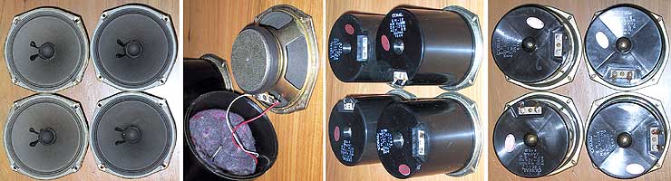

Midrange looks like this?

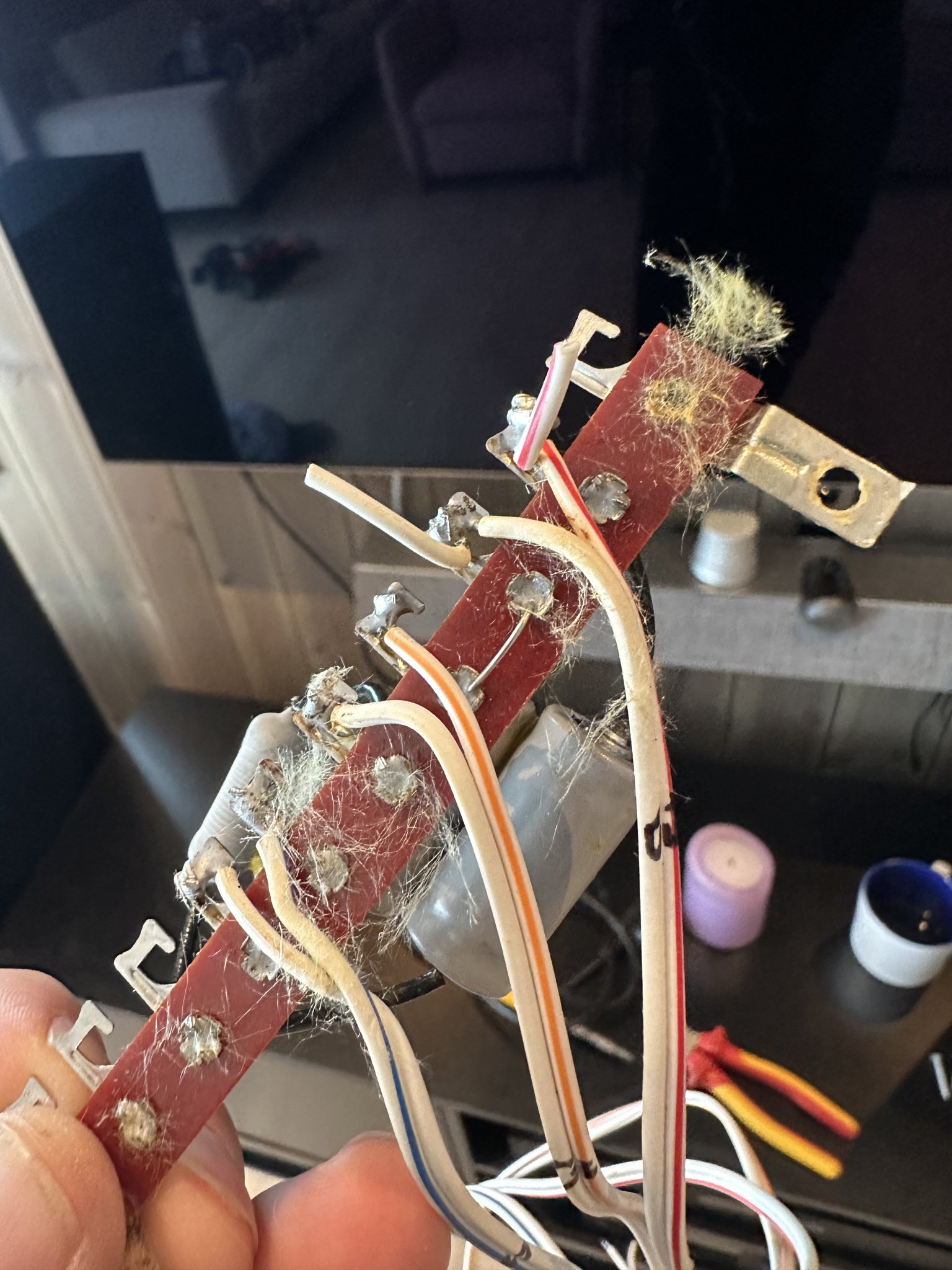

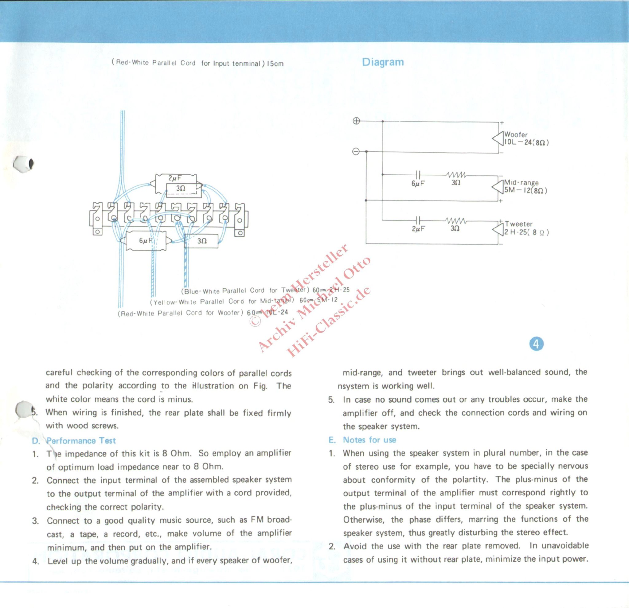

Caps will have to go, likely a new XO developed, that will take some effort. Ican likely draw the XO map just from the picture, a couple Cs to create the HP for mid & tweeter and a couple Rs to adjust levels — are both on the tweeter circy=uit or is one in the midrange circuit?

i have the space to build the speakers quite large if i want, i was thinking i could try to make a adjustable cabinet of some sort to test difrent volume and dampening solutions?
I have access to a woodworkshop and only my imagination is a limit :)
Planet10: A see the photos of resistors and caps (looks like the 10ince driver was running as a fulltone)
On photo 2: wires from right to left is
  1. INPUT AND BASS
  2. MIDRANGE DRIVER
  3. TWEETER

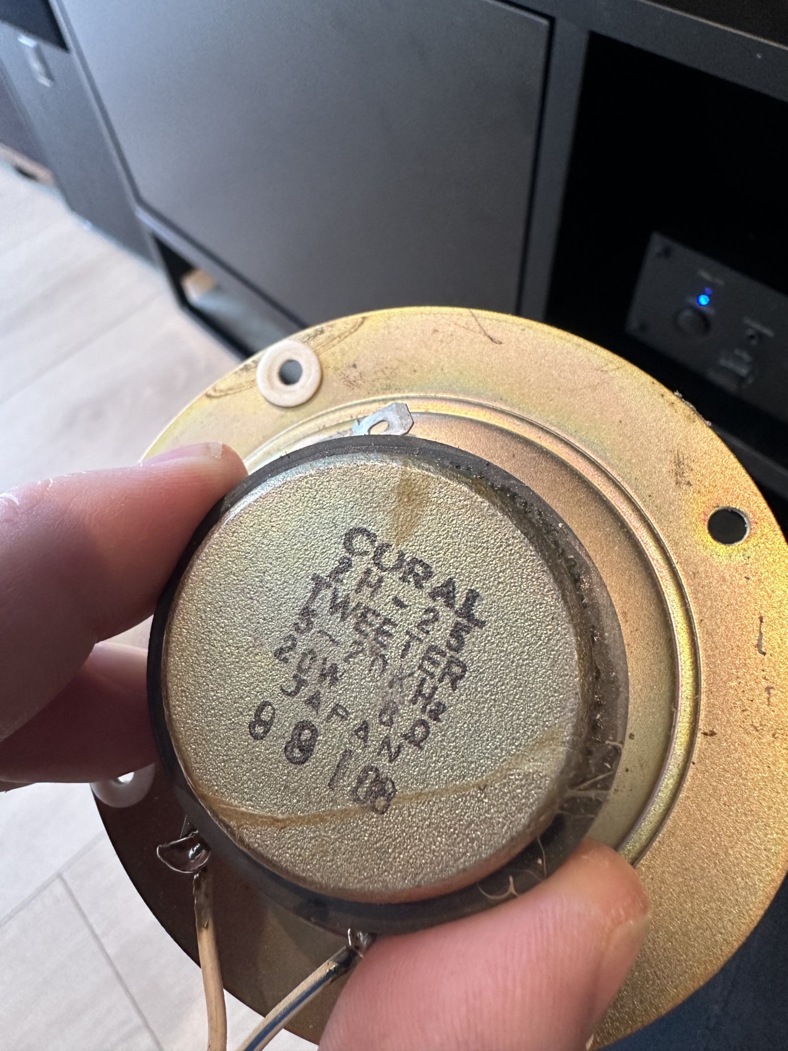

Photos of my 2H-25 Driver
