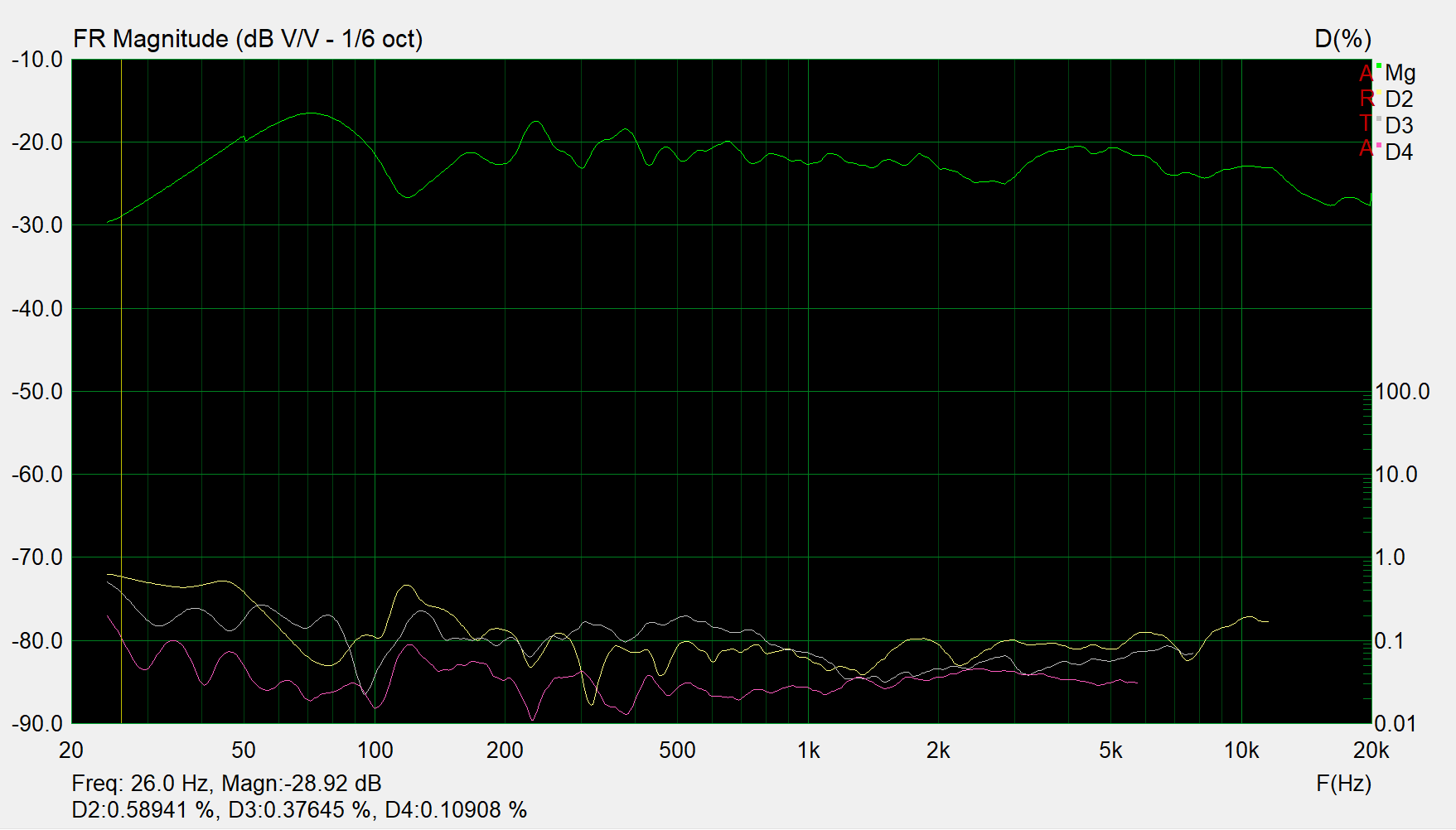

Hi, there are some things to consider. In case 2x subs are built, you have a luxury to place them at different positions in the room. This is almost always better compared to a single sub, since with two of them room resonances sort of equalize out to a degree. So, by placing at different locations sound output can be more even than what's ever possible with a single sub.
Second, with more area efficiency is incresed. Sort of free SPL.
Third, I have recently built a system with very similar peerless SLS 12" woofers in sealed boxes. Compared to other woofers I had tested distortion was low, and in general peerless SLS is a well built driver, especially for it's price IMO. It's better suited for sealed enclosures due to high Q.
Attached file with distortion measurement of whole system at 90 dB. Figure is excellent I think.

Peerless sub starts to distort heavily below 60 hz compared to even SB34NRX75-6 which is worse driver than NRXL-08.
There are extensive measurements here, distortion only starts to rise below about 40 Hz for SLS 10".
