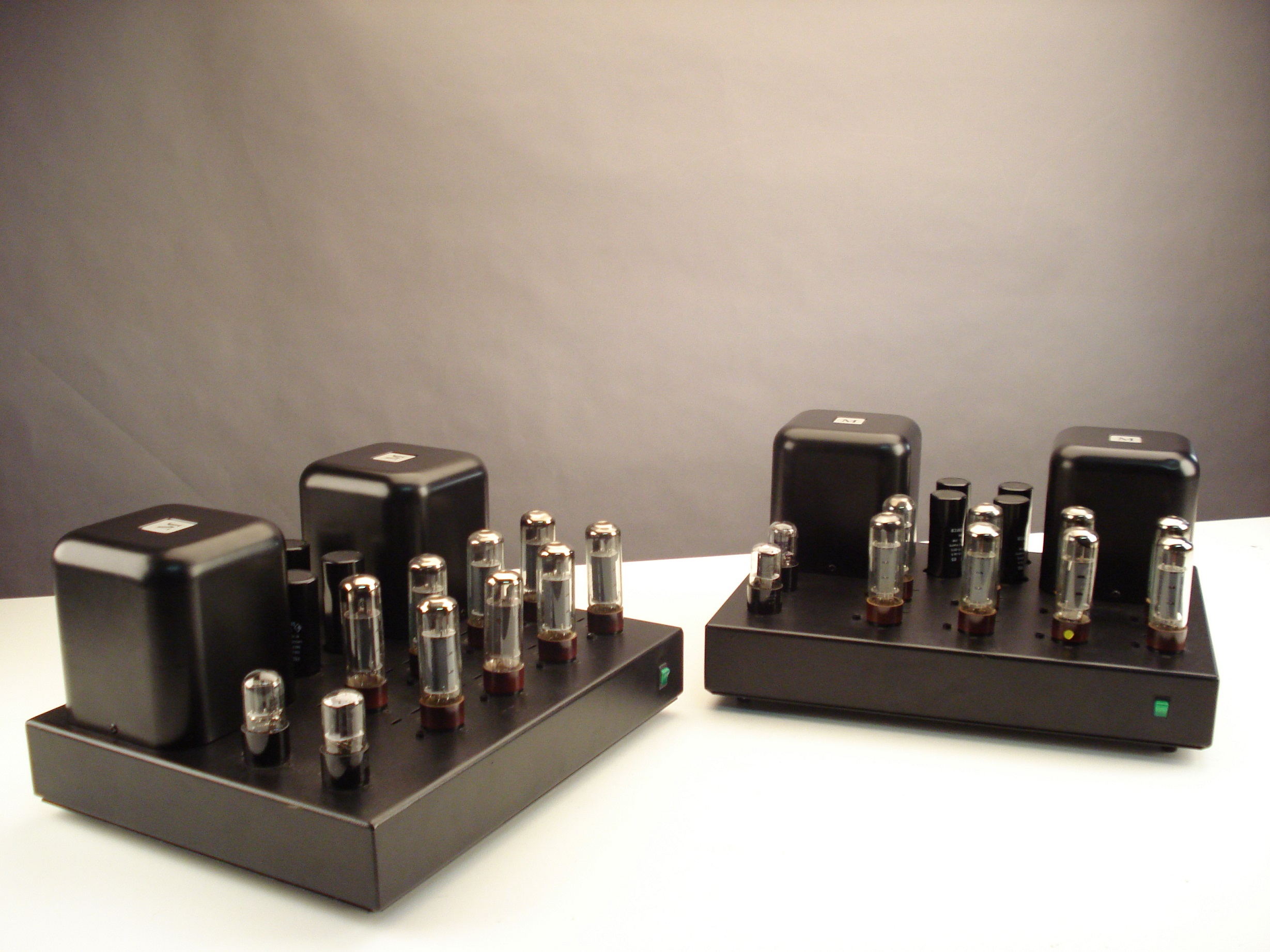

I built two monoblocks, 6 EL34 PP 120w Class AB1 using Hammond 1650TA OPT's I think. Mains power tfmrs are 650VA toroids, self wound, & over wound, so you'll need 1 x 1000VA or two 500VA at least. HT designed for 1A at 450v loaded (each amp runs at about 650mA at full whack) 500v unloaded. Filter is 1100u ish, no L. Biased at 35mA, fixed bias. Sensitivity 1.5v, though I could have made this smaller. See - 120w PP UL monoblocks
Some good ideas here - 100w-monobloc3-2014
Problems I remember running into - oscillation, so PT has some good solutions for this. Took me a while to design and build a decent driver/LTP, agian see PT's ideas. A protection circuit is a must, see PT's circuit for this. Layout is important, get it wrong, the valves lift off. Also heat is a problem, the chassis' get hot as does the mains tfmrs
Good luck, Andy.
