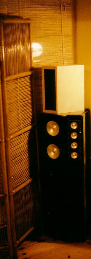

Hi There
I'm new to this forum but I thought I'd chime in here ..
I use JX 92 & I am very comfortable with them though I find they are best and more involving when driven.
The advantage of the jordan system is its modular so you can develop easily eg stage 1 92 / stage 2 add 125's / stage 3 add 53's. The whole lot can be driven reasonably well from a modest amp ~ I now use a Cyrus 1 but have used Arcam Alpha 5
Also I note you want 20 KHz ~ (regarding the frequency limitations of the JX 92 I've read about elsewhere in other threads) it is first your own hearing which is the limiting factor When I did a test I can only say i was stunned at my limit of 13.5 Khz only my 9 year old daughter could hear above 16 Khz. So can I ask how many of you have analysed your own hearing abilities?
(Takes courage to find out.)
I enclose a photo of the Linear Array JX 53 range coupled to pair JX 125
(The top box in birch ply is not part of my system .. for those that are real fans this box is 4 unit linear array & was made for the man himself Ted Jordan ~ designed for his lounge & to be wall mounted and placed about 2.4 m apart front angled 60 deg.
6 Litre enclosure for 53's & I think 60 L ported for the 125's ~
It's been my intention to redo the 125's into 45/50L sealed
My favourite set up is with the JX 92 & I use these with the 125's pictured without crossover

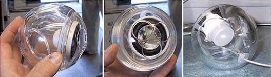

I've always liked spheres easthetically... i have a pr of Electrohome shperes loade dup with a close relative of the RS40-1197 and a set of Apple's crystal spheres with the 35mm Harmon odessey in them.
