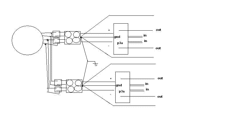

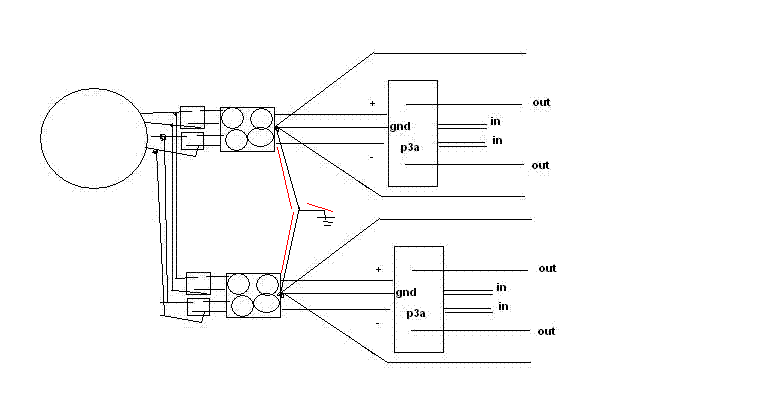

I have constructed 4 ch esp p3a using dual rectifiers and separate filter capacitor banks for each p3a board. Each board are two channels.
I'm getting buzz when connecting inputs to more than one p3a board at the same time. I guess there is some gnd loop in my system.
This only happens when I use one transformer to both ps-units and p3a boards. look at the image provided. If I'll use two transformers (one for each psu) then there is no problem at all.
If i connect both star grounds with each other (both to chassi) there a little less buzz but still to much.
how can I resolve this issue? mount a 1 ohm resistor in series of gnd and one of the p3a? will it help?

Dont connect the signal grounds to the P3A boards - connect them to the star ground, with a 1-10R resistor.
Personally I wouldn't use the seperate supplies, I don't think it's worth the hassle.

that you input leads are not connected to each other (regarding groung) and also that the set of input leads is not connected to the sassi in any possible way ( regarding ground )
meaning that the rca you use for inputs are not to be connected to eachother and also have no conection to sassi ground ....
in a few words use isolated input connectors

The red wires are OK and provide safety earth route and RFI shielding, I would not remove them.
Are you using insulated input and output sockets, i.e. insulated from the case?
Also, if you connect a fully floating source such as a battery powered CD player, do you still get the buzz?

you have at least two solutions.
Try both to hear which sounds better.
Cheap & easy:-
Connect all the PSU zero volts together.
Connect all the input signal returns (RCA terminal grounds) together.
Connect all the speaker returns together.
Now connect all three of these at one big star ground.
Use a disconnecting network to connect this star ground to mains Safety Earth.
Separate channels:-
Connect each channel up separately.
Connect speaker return + RCA return + PSU zero volt+ power decoupling together and use a disconnecting network to link to the mains Safety Earth.
Connect each channel similarly each with their own disconnecting network.
Cheap & easy:-
Separate channels:-

well not really ...if there is topology like that together with it you will find a ground lif switch ....
if not then sassi gorund has nothing to do with audio grounds ....

richie00boy said:The red wires are OK and provide safety earth route and RFI shielding, I would not remove them.
