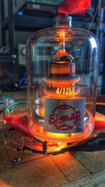

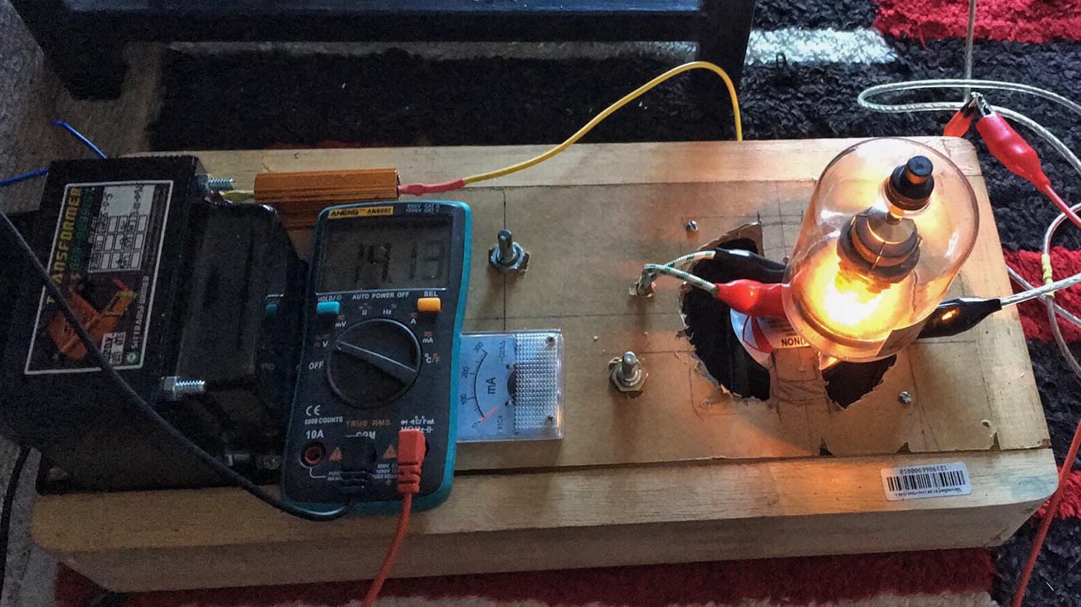

hi this is my testing 4-125a tube ht+1100v bias 50ma 6k opt
Saran audio - 4-125a class a. Test

It’s power tredtrode. Tube. I config in in tredtode mode run screen ccs controls voltage and current. Bias points don’t far away from -g 0v

What is the screen voltage ?
Grid no 2 is around 325v 25ma
Stoppers? If not, you may find you have built a high power UHF oscillator and get an RF burn.
Ho. What’s am I wrong
i design it run class a /a1 in pentode mode ? The screen grid for controls gain and the anode current or not. If i’m wrong with that what the best way i can do. Such as ground the controls grids and used grid 2 as triode mode please advise

Putting a resistor on the G2, and maybe one on the anode (Some transmitting tubes state this on the datasheet) will stop/control unwanted HF/VHF oscillation. Put the G2 stopper as cose to the vaklve base pin as far as possible, try anywhere from 220 r up, about 100r on the anode if needed.
It's usual to use a stopper on the control grid G1 too, with a 10:1 ratio in reference to G2, EG 1k on G1, 100r on G2, or better 2K2 and 220r.

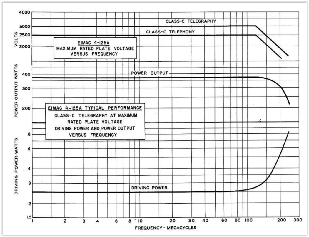

300MHz is the modern start of UHF. Back when that valve was a new design, UHF started a bit lower. Most valves can manage to oscillate at UHF in the right circuit, whether accidentally or deliberately, as oscillation is typically the easiest thing to do for any technology - useful lowish noise or reasonable power amplification is at lower frequencies.

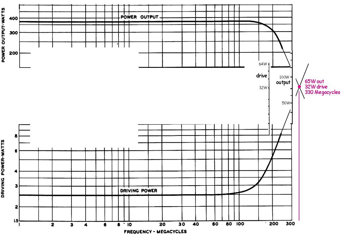

As I said, for a given technology/device the ability to oscillate usually extends to higher frequencies than any other function. That graph seems to show that at 250MHz it has a gain in the region of 14dB. You only need a bit over 0dB gain to oscillate, so I would not be surprised to find one 'singing' at 500MHz. Of course, the OP might be lucky but it would be wise to treat high power valves with respect and be aware of possible hazards.

"Ratings" don't matter, since any oscillation is an "accident", and cooking the tube just one of the consequences. (And it may be robust enough to sing >120MHz in home use, but not in 24/7 critical military work...)
Your own graph, interpreted, suggests small margin for singing at 330MC.
