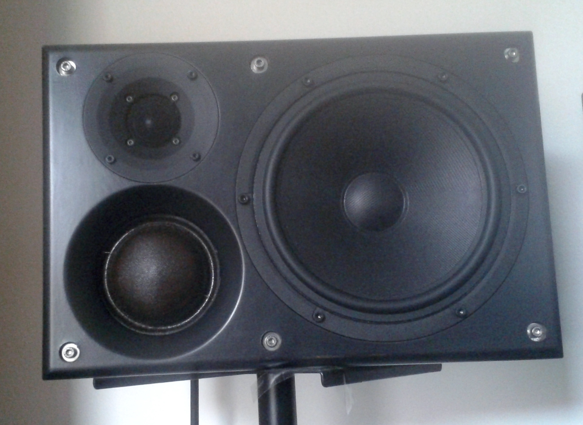

What about something like this:
Chassis:
Woofer: Scan Speak 22W4434G00
Mid: Tang Band 75-1558SE (in a small Waveguide)
Tweeter: Seas 27TBCD/GB-DXT
One Hypex AS2.100 per side.
Crossover
Woofer - Mid/Tweeter: active LR24 at 650Hz (with Hypex)
Mid/Tweeter: passive LR24 at 2500Hz

I bet that is a good sounding loudspeaker. Is that somthing that you built?? If it is it deserves a thread of it's own.
Yes it's my current studio monitor design used for amateur-mixing/-mastering - and I love them.
As I don't have any documentary of the building process I don't think a dedicated thread would be of much more additional value.
