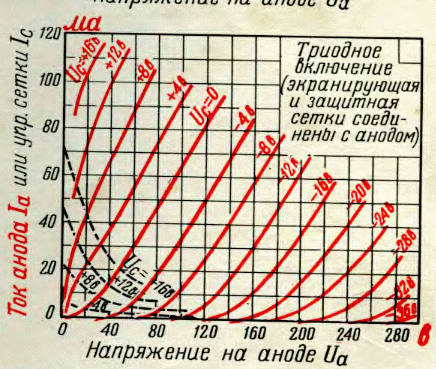

Try 4П1Л instead of 2A3, you will be surprised...
Damn! That's a linear tube. I can see why you like it...
~Tom
