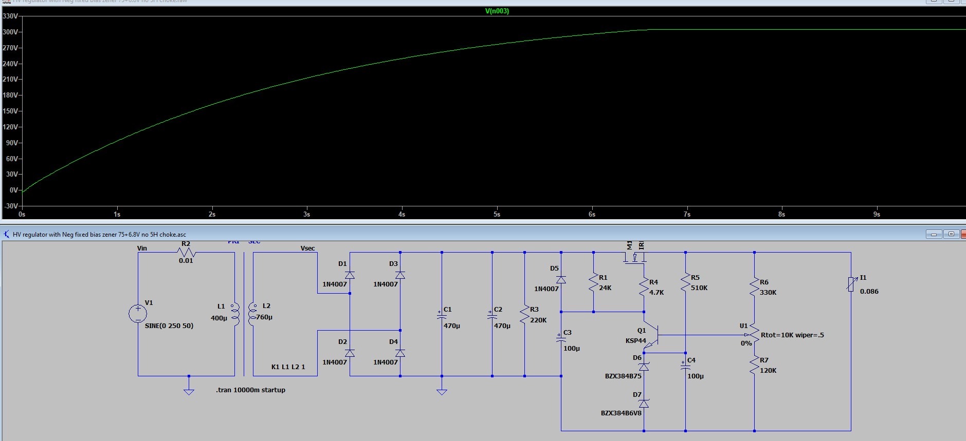

305Vdc HV regulator adjustable via zener diode too slow 7seconds
I try simulate 305VDC HV regulate supply adjust by change value of Zener diodes normally 75V zener. To use with 6sn7 and 45 total load is about 86mA
the problem is it take almost 7 seconds to get 305VDC.
How to solve problem?
if anyone can help provide 305vdc HV reg, will be much appreciate
thx

2SK3564 of Pspice not compatible to LTspice. How to convert to compatible value? Thank you.

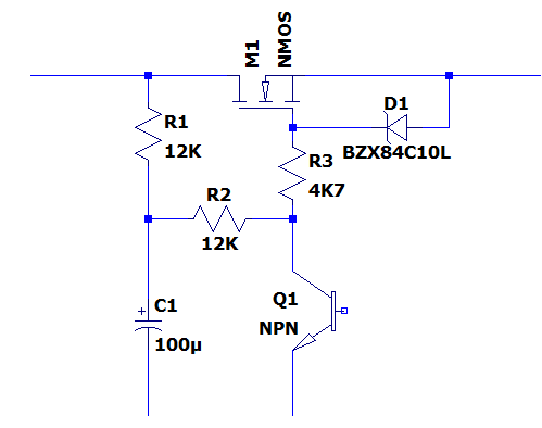

Also want a gate protection diode across the mosfet source to gate to prevent it going positive should the caps discharge at different rates.
If you want a belt and braces a 1007 across the drain-source to prevent reverse polarity and not rely on the internal diode..
How does C3 bleed? (R1+R3 I assume)
