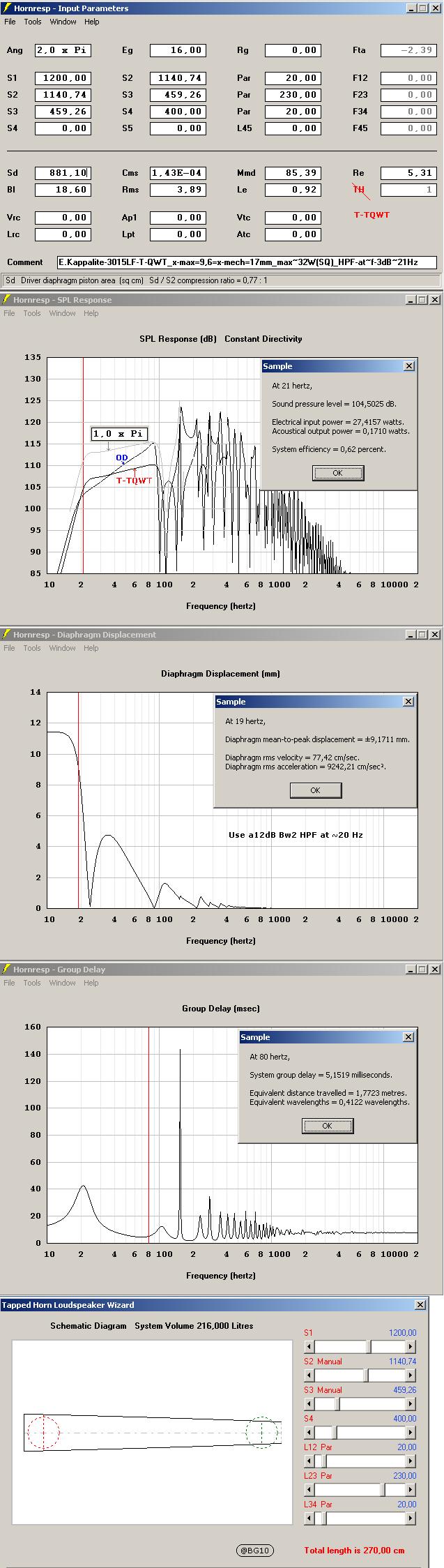

This design might fit if folded:

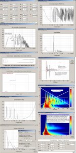

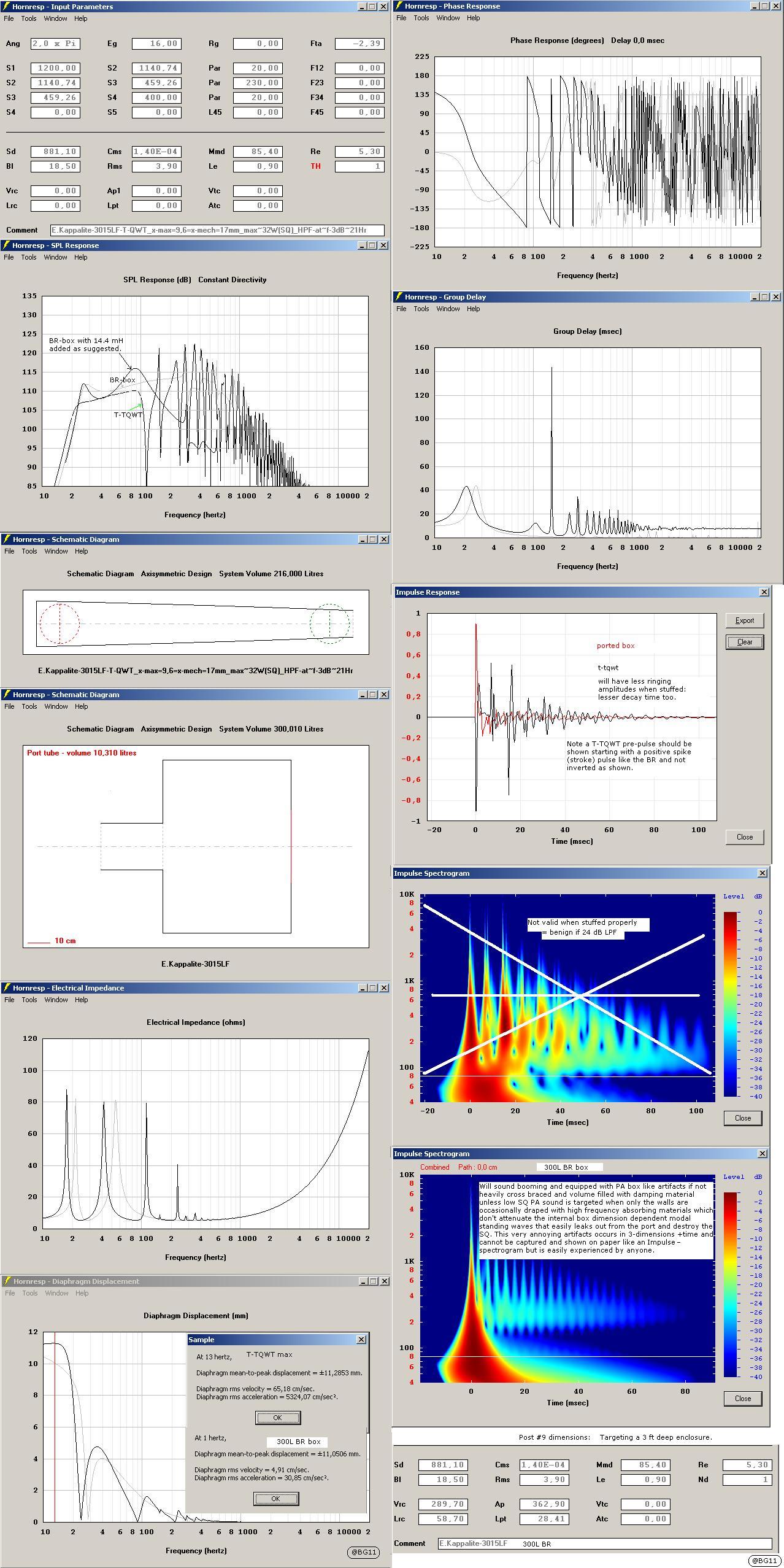

😱Why making a from the beginning a bad impulse response to be more worse:

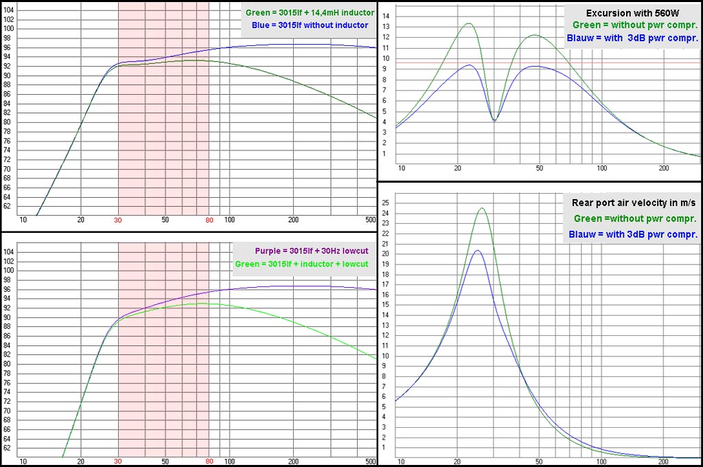

I don't like the dips/peaks of the BR with the inductor at all! I like the response curve of the quarter wave design! Is that peak/dip worse or better because of the inductor? I was under the impression that the inductor would help flatten the response, but it doesn't look like it in this case!
Edit
I didn't see the grey line. Now I see that's the BR box without an inductor and the black line is with. Looks lime the inductor hurts more than helps !
The sims don't accurately show the response of either box, but having tested various boxes with and without large inductors (which are ridiculously expensive for just some copper and iron) I have never seen them do anything like what was shown.
The TQWT sim is about 5 dB down from the ported box at 30 Hz, what is it you like about it's response, which starts low in the bottom and rises in the top ?

Although I appreciate your efforts and the enormous amounts of predictions you seem to publish I’m afraid I have to agree with Art (for once...again 😉). Comparing two different design concepts purely based on theoretical models (that are not even correct) is very questionable. If it was possible to judge purely on theoretical models from software, no serious PA manufacturer, studio monitoring manufacturer or respectable HiFi manufacturer would invest so much in time, effort and expertise in developing loudspeakers.
Like Art says your prediction from HornResp about the SPL response of the basreflex with an inductor in series, looks anything but realistic. I suppose you added the value of the inductor with the value of the voice coil. Even from a theoretical point of view that would be wrong. I’ll give you a few notes you can consider;
1.) The voice coil is moving in a magnetic field and in the same time creating a magnetic field on its own (try to imagine how many variables that produces)
2.) The voice coil is under influence of relative big temperature changes during loading (change of resistance and induction values).
3.) An external inductor has minimal temperature changes (if the right diameter of the wire and type of construction is chosen)
4.) Since HornResp has no input for room acoustics, cone damping, cone material or pwr compression levels, the impulse behaviour it predicts is just a theoretical indication and will not represent any real life measurement (or sound experience).

Art I like the fact that it's almost flat for the passband that I'll be using it. Low pass will be 80-90hz and the high pass will be 30hz. So between there the sim shows a 3 db difference. (if it's close to accurate)
MrGsR (btw do you have another more easy spelling name 🙂 ), for what it is worth I made you some theoretical predictions that speak for themselves. Although they might be theoretical more correct it still doesn't represent any real response of a build cab.
+ the 3dB that is going to be cut by the filter at 30Hz. To me that looks like 6dB difference in the bandpass 30-90hz besides the fact the wrong data of your 'new version' 3015lf is used. Also look at the max power input Vs max SPL if that suits your goal.Art I like the fact that it's almost flat for the passband that I'll be using it. Low pass will be 80-90hz and the high pass will be 30hz. So between there the sim shows a 3 db difference. (if it's close to accurate)
