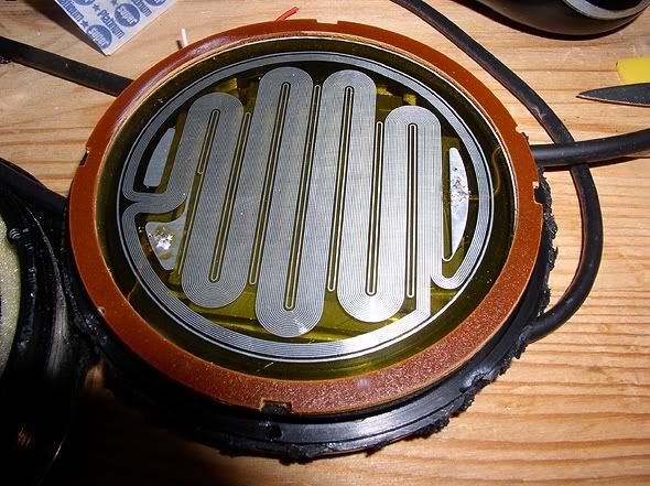

Now I am looking at the impedance curve of the Audez LCD – 2 headphones. These planer magnetic drivers have a completely flat impedance curve without a hint of resonance. That is 70 pure resistance ohms of input impedance.

To the point of this thread; planar magnetic headphones perform more like a pure resistance that the classic drivers with a huge impedance peek. I do not think that the rule of 8 need apply.
Go over to innerfidelity.com and see the test results for planar magnetic vs the other; distortion, phase and square wave.
