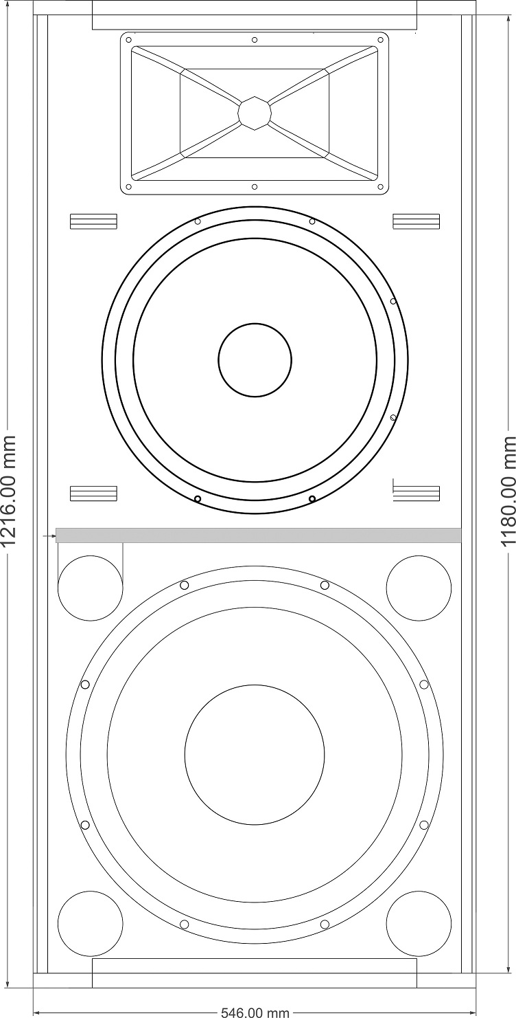

I am planning to design 3 way cabinet with 18" woofer, 12" midrange & 2" compression driver.
I will test the drivers for thielsmall, impedance graph & frequency response.
I wish to use 18" upto 250 hz, then 250hz ~ 2500 hz will be midrange.
I need to use 3 way passive crossover due to some requirement.
Now where to set test microphone for woofer to test frequency response?
In the center of the box or in the center of woofer?
For midrange & cd horn i will put at the center of midrange & horn.
Then i will take the frequency response,
for combined frequency response of the all drivers, what will be the mic setting requirement.
waiting for guidance from fellow members.

Standard is 1 meter.
This isn't the situation in listening position with a MLS measurement you can do it also on 3 or 5 meter to see how the wave front mixed on distance. In fact I think this is the more practice than on short distance.

2" driver can be crossed 800-1000Hz.

I respectfully disagree. A 12 or even 15 can be used as a mid when correctly matched to the right CD/horn.Hi, 12" is far too big for a "midrange". rgds, sreten.
the 12" can be attenuated according to requirement. So no problem of stupidly loud.
My impression is also that a 12 or 15 - or even an 18 can be excellent in the midrange, perhaps with a little help from a well-placed crossover notch.

In terms of the extent to which a 12" driver is beaming at (the cross-over frequency of ) 2500 Hz, conventional wisdom says that 12" is too big. But this can be OK if the one listener is on axis with the pair of speaker systems. My current pair of stereo speakers are two-way with a 12" woofer, and I really like them. However the vast majority of time, I am the only one listening to them, and I have the pair toed-in to my in-the-middle listening position.
For more than one listener listening to stereo speakers simultaneously, a 12" mid-range driver radiates too narrowly over much of its pass-band to give good reproduction to any listener off-axis.
Pete
My understanding is that a 12" woofer typically has a 6 db down at 90 degrees at about 1200 Hz. This is the optimum crossover point for a 12" midrange.
Also, my understanding is that a 2" compression driver with a 3" diaphragm starts to break up at about 8 kHz. For a 1200 Hz crossover point, a 1" exit driver is more approprate if you do not want a super-tweeter/ 4 way.

if it were me, I would consider 2.5way with double 12" instead, and use 12" midbass with adequate Xmax, and add active sub if needed
10 inch better at 2.5KHz crossover
IMO You will get better results using a 10 inch rather than 12 inch if you need / want to crossover as high as 2,500 Hz.
I would only go up to 1KHz or so crossover with a 12 inch.

What is overkill on a 10" copared to a 12.IMO You will get better results using a 10 inch rather than 12 inch if you need / want to crossover as high as 2,500 Hz.
seems like its easier to find a good smooth 12" than a 10"
is the 10" a somewhat 'more unlucky' size for midrange
at 2500hz
I don't think it matters which...10" or 12", they will both strugle with the same problem
