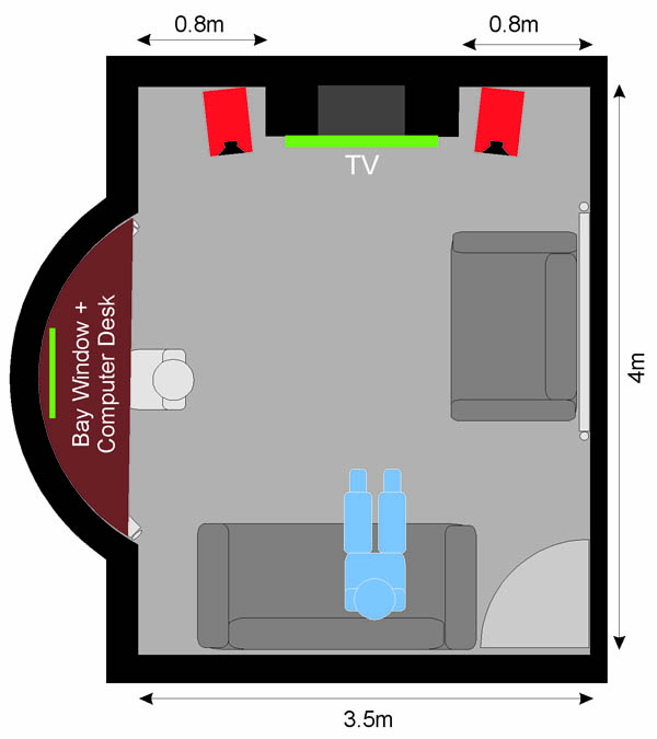

It seems that amongst the many cans of worms I'm naively opening with my intended 3-way project is the room layout, so i thought i'd start a thread on that to add to all the other issues being juggled.
Its a standard living room, rather than a dedicated cinema or listening room, and has a number of compromises. In particular my speakers are either side of the TV, which is mounted on the chimney-breast - which means they are stuck in alcoves less than 1m wide and around 35cm deep. This clearly isn't ideal but doesn't seem to be 'too' bad with my current modest bookshelf speakers, theres a little boominess occasionally but then they aren't noted for their impressive bass.. my 3-way project is partly intended to correct that so i woulkd expect to have more of an issue. I don't want to bring the speakers out into the room - partly to keep them at the same distance as the TV and partly because its a small room and space is limited, but they could probably come forward several inches if necessary.
(see image below)
I've started reading The Acoustics and Psychoacoustics of Loudspeakers and Rooms by Floyd Toole. Its pretty wide ranging and so not the fastest to get to the point, but he has a section comparing a bookshelf speaker sitting in a sort of shelf-type recess vs packed in with insulation vs flush with the wall (such as in a hard flush panel covering the recess), and its clear that the recess does unfortunate things to the smooth propagation of sound. The conclusion appears to be that its better to have it either flush mounted in a panel or failing that on a panel (where reflections are close enough to be < half a wavelength) rather then in a recess.
If its a problem I was considering bridging the alcoves flush with the chimney and having the speakers flush with it and the cabinets behind - possibly the whole speaker or perhaps just for the bass driver (in which case I would disguise it as a sort of built-in cupboard with the mid and tweeter appearing to be a two-way sitting on top, just above the bass driver). Or alternatively, I could look at a wide baffle design of enclosure like Troel's Poor mans Strad or the Stradivari placed a few inches forward, and hope this would push the sound into 2pi space before it has much chance to interact with the alcove.
So what I'm interested in knowing is if I will actually have a likely problem here, as I believe, and if so are my ideas any good or are there better ways of dealing with it?

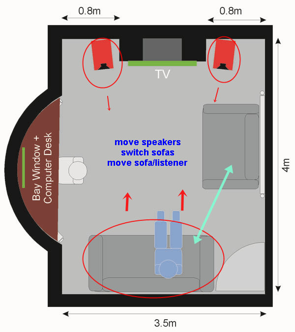

Some quick and easy changes that I suggest are in the pic. Others than sofa switching can be done only when listening "seriously" 😎 Obviously the room should have some half-filled bookshelves, thick carpet, wall clothes to reduce reverberations (I guess there are but not drawn to pic).
Please study/simulate positioning of speakers and mic/listener here (enable Java) hunecke.de | Loudspeakers Calculator
Juha

It looks like you have the opposite of a problem: you have the option to soffit mount speakers which is pretty much ideal.So what I'm interested in knowing is if I will actually have a likely problem here, as I believe, and if so are my ideas any good or are there better ways of dealing with it?
I would echo Juhazi's point about moving your head away from the back wall when settling in for a good listen.
Soffit mounting the speakers will efficiently drive the lengthwise room mode (but so will the current location pretty much) putting room treatment behind your head fairly high on the list of things to consider. But only do this after measuring what your room is doing.
Many thanks chaps! Yes my head being too close to the rear wall is one of the deficiencies (of the room, not my head!). It wouldn't be practical to move the sofa forward permanently but I hadn't actually thought that I could move forward temporarily for serious listening sessions - of course I could; doh!

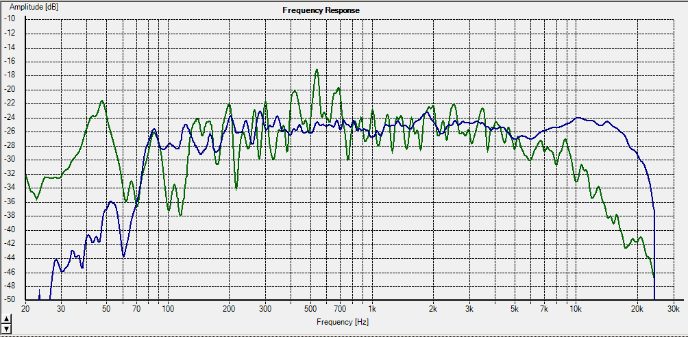

Hi Kev, thinking about the room is probably going to put other things into perspective somewhat 😉 I did some measurements in room recently to try and work out whether there was anything (simple) I could do to improve things.

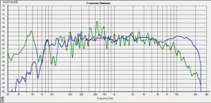

I ended up repositioning the speakers a bit and got a slight improvement. The main problem is the 4M length of my room. It causes some big nodes, I suspect you will see the same. Using the simulator in REW shows what I should expect and it certainly looks a lot like what the in room FR curve looks like.
I've attached a plot. Blue is the FR of one of my speakers measured outside. Green is both speakers playing taken at the listening position (with mic carefully positioned to be almost exactly equidistant from each speaker).
As you can see the room changes things a bit!
The graph looks a bit scarier than it really is due to the 40db scale, and it is only 1/16th octave smoothed.
There wasn't much I could do with speaker positioning with my particular room. It is nominally 4 X 5M but one side of that is a walk through area so it is more like 4 X 4 for where the funiture can go. I think in reality some sort of absorbtion on the wall behind the sofa would be the most effective thing for me, and certainly when I have put big cushions behind my head on the sofa it seems to make a bit of a difference.

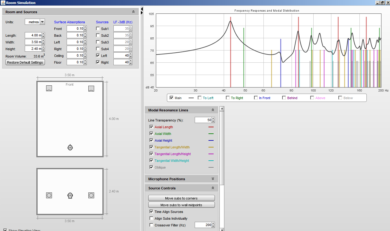

About that sim, It is a great learning tool to study "what if". It acccepts only a rectangular room. The sims don't match my HT room very well, but generally rather close. The effect of moving the mic/head is often more important than moving the speaker! some 10cm difference in height means a lot too! Actually it made me a little frustrated, because many of the "best" positions were impossible/impravtical for people in the room, eg. placing the sub in the middle of floor!
Happy simulation sessions!

Hi Kev, the big spike at a bit below 50Hz is the mode from the room length. I think that the asymmetry of the room throws it off a little bit from the Sim (only by a few Hz) I only get that problem with the right speaker, measurement on the left speaker doesn't have the big peak because it is beside the walk-through so to the left of the speaker is actually a cavity of at least 4 square M behind.
I would think in your room the sims will be more accurate, though the bay window may have some interesting effects, working like a parabolic reflector potentially?!
Since I still had the sim from my room open I just changed it slightly to match your room and the result is attached. I put in an arbitrary 40Hz f3 and 2.4M for ceiling height.

I got the plug-in working now and tried the online simulator. Obviously its quite simplistic and I can't get very close to my intended speaker designs but it is still very interesting to quickly/easily see how the speaker and mic locations change things. I also do get a 20dB spike in SPL at between 30 and 50hz, as you mentioned, Tony. This diminishes as I move the mic forwards to the centre of the room and increases again if I continue on towards the front of the room. My current speakers start to crap out before they get that low, but my intended 3-ways certainly shouldn't, so that may be something to consider 🙁
Thanks very much for testing out my room too - I've not tried that simulator but it looks very useful! The peak is still there but not quite so scarily large as with the more general online sim above.
