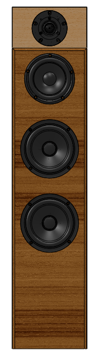

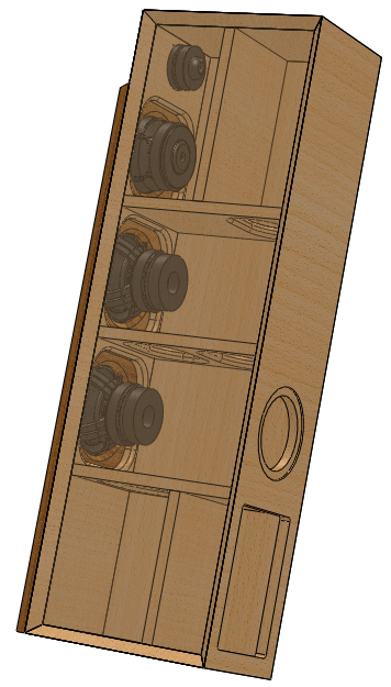

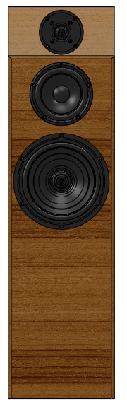

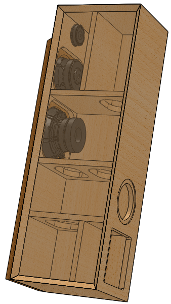

Some time ago, i was concepting a design around revelator 15M/8631G00 i wanted to use; also with flat LR2 XO and therefore tweeter phase alignment (never build, and no plan to do so at the moment):
1st attemp, with D2608/913000 and 22W/8534G00:
2nd attemp, with D2604/833000 and 2x SB17NRX2C35-8:
Just my 2cents. 🙂
Just my 2cents. 🙂
In general - without further simulations - your plan may work out pretty well dependent on the execution.
Best regards
Peter

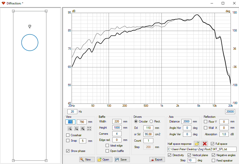

Some addition:
Especially with a LR2 XO concept, it is worth paying attention to get a smooth response by the driver FRs + the baffle geometry to keep the filtering easy.
Here an example of the midrange FR; dottet line is 15M halfspace rsponse from the manufacturers datasheet, thick line is the simulated 4pi response on the shown baffle of the 2nd attemp:
The baffle diffraction effects/baffle step compensates the drivers FR linearity error very well, the result may need only 1 coil in series for the lowpass.
My advice is to study a bit the builds of Troels especially from the last 3-4 years (do not look at the "old" stuff), he collected may experience with such LR2, tweeter phase aligned conceps. I did, and his baffle constructions+ driver positioning have reasons, and his XO architectures look well tought regarding many aspects (i.e. he trims lowpasses with just series, and without parallel components to keep the backwards impedance the driver sees high; this keeps out-of-band distortion components in the current surpressed...).
Best regards
Peter
P.S.: You don't need such expensive XO components like Troels uses, he makes money by selling them. Air coils and foil capacitors are perfect and worth their money, but you don't need the fancy stuff. Maybe an Alumen Z or Mundorf Evo/Oil for the tweeter series capacitor when it makes you sleep better....
