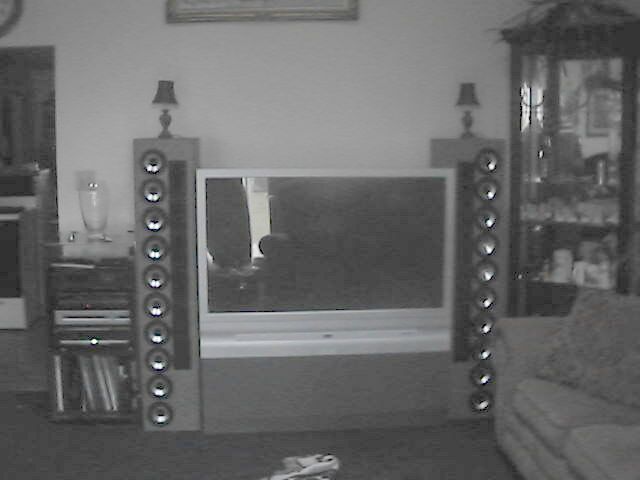

4th order Bessel is a crossover slope of 24 db per octave.
All metal cone speakers have a breakup mode at higher frequencys.
If you look at the frequency response for the Dayton 5 1/4" Aluminum speaker you will see it start falling at 2000 hz. It finally hits a low point at 3800 hz. Then you'll see some erratic & jagged peaks starting at 4000 hz and up. The jagged part is what you want to supress with a crossover. I don't think 3000 hz 2nd order (12db) will do it. You'll need a steeper slope like a 3rd (18db) or 4th (24db) order crossover to supress that breakup mode.
You'll have to make your own crossover. I don't think they make prebuilt crossovers with steeper slopes.
Also a three way speaker design is very complicated to assemble from scratch. It's far easier to build a two way with a subwoofer.
The three ways you see as projects by other diy'ers are by people with very good modeling software and speaker testing equiptment. There are free modeling software and testing software (Speaker Workshop), but it still takes a fair bit of knowledge and a lot of experimenting to get a feel or handle how speakers can be built from scratch.
You can either dive in and start to learn the craft or you can start with a predesigned speaker by one of the online guru's. I just dove in and learned as I went. Theres alot of good and knowledgable people out here to help you along the way.
Those line arrays were my first project. I went through 5 subwoofer enclosures to see and hear how they sounded. I finally settled on a Mass Loaded Transmission Line and I've also built 3 different MTM's to see how they sounded. As far as crossover work I use the free spreadsheet program by Jeff Bagby and I use the Radio Shack Decibel Meter to calibrate my crossovers.
I don't know how far or how deeply you want to get involved, but we're here to gladly help you along the way.
Rudy
Rudy
