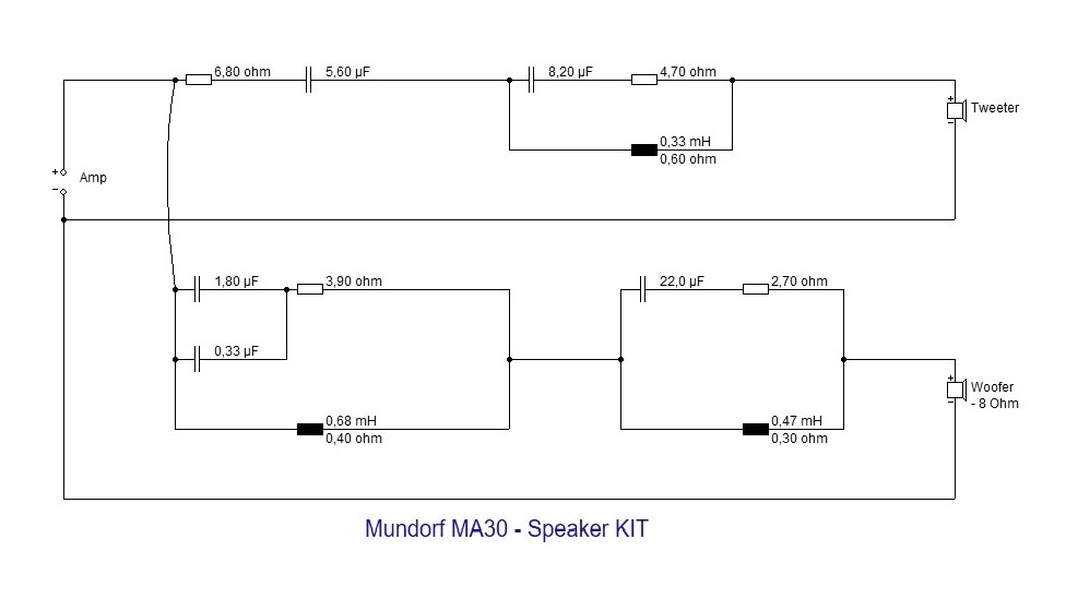

all pretty cool ideas, ty. however i think 2 MA30s is probably the way to go for me, my room is just ~20m^2, a bass extension seems kinda overkill :/ i might just resell the other drivers or just get 2 c-158s...
now i will try to recreate the crossover mundorf designed for the ma30... seems to be a -6db x-over at 3450Hz with 2 notch-filters (1 at 3450 for the tweeter and one at ~3200 for the midbass)
i found this partlist and diagram:
https://i.imgur.com/hz0HAOW.jpg
i don't understand the wiring of the components yet, will try to figure this out now, any help would be appreciated... the only other info i have is : "Elektrotechnisch ist das Layout der MA30 Frequenz-Weiche ohne parallel verschaltete Bauteile rein seriell und für Bi-Wiring bzw. Bi_Amping ausgelegt", which translates into something like "the layout of the x-over comes without parallel parts in a serial layout for bi-wiring/bi-amping"
cheers, lisette
when i design a simple series crossover with 2 notch filters i use 3 capacitors, 3 coils and 2 resistors. probably another resistor to dampen the tweeter... mundorf used an extra coil and 3 extra resistors. any idea how they could be used in this crossover?

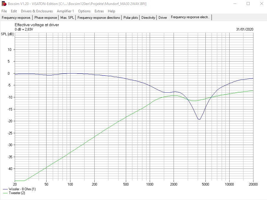

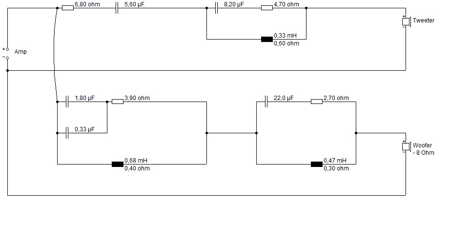

Mundorf MA30
It must be something close to this.
one more question: im pretty sure i can see a 5.6 μF condensator on the board but not in your diagram... are your numbers slightly different maybe?
cheers, lisette
EDIT: ah i'm stupid, forget what i just wrote XD
