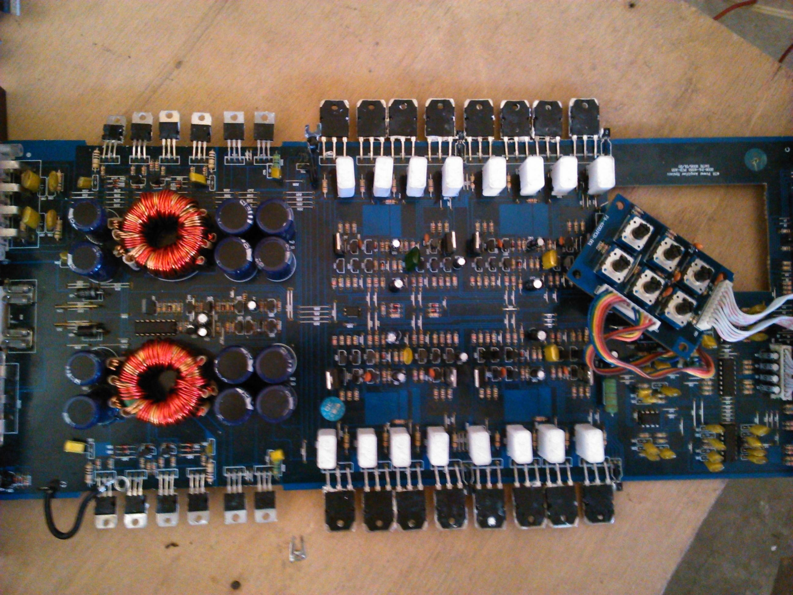

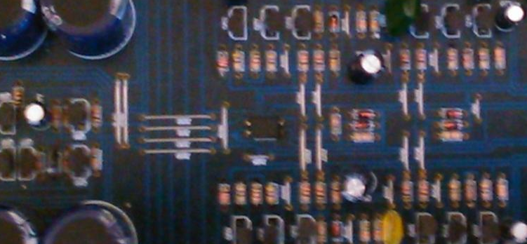

I have 4 channels generic class AB amplifier. The problem is distorted channels intermittently. I've tested the functionality of output BJT transistors, preamp, and biases everything seems normal.
I have some observation, If I crank the amp loud, the distortions on some channels went out but if the amp become cold the distortion comes back.
Do you have any opinions?
Thank you and appreciated all your responses. i've attached picture.

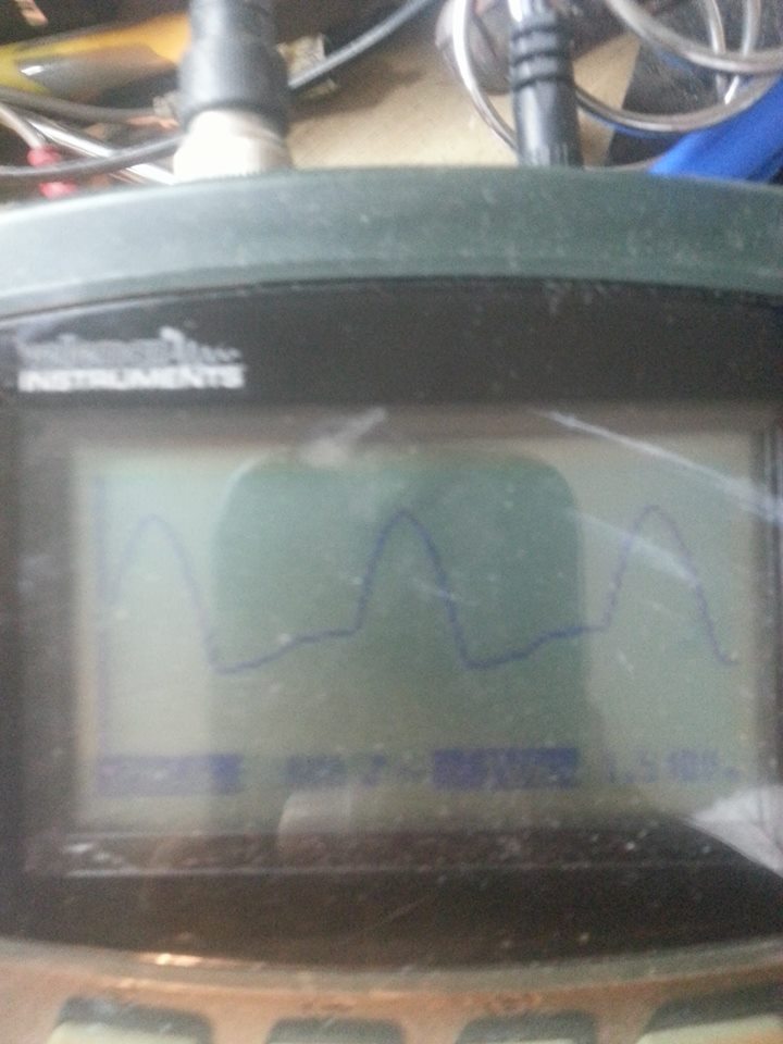

Post a photo of the distorted signal with a sine wave.
Hi Perry,
Here are couple of screenshots of two channels. I measured again the bias resistor, transistors and some capacitors they seems within tolerance. 3 out of 4 channels behave like this.
Thank you!

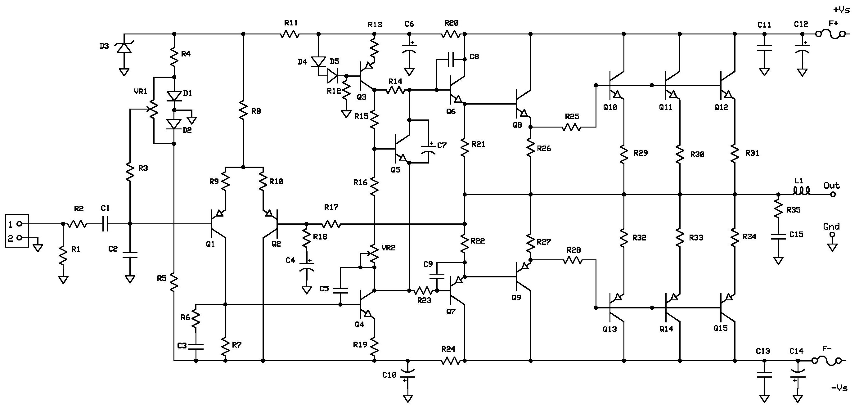

Thank you 90s. Yes this is cheap designed amp. I definitely do that but where is the bias resistor you are referring? Any clue where this connected? i suspect the pre driver are under bias.
I downloaded a schematic and most of them are similar. So Q5 on this one is the bias and R15, R16 and VR2 make up the bias of Q5.
If you look at schematics online of different models, you should see a similarity. The ones I messed with, the resistors were on the base to emitter side that I adjusted to a different value.
This is what I do for bias adjust.... http://www.diyaudio.com/forums/car-audio/261670-bias-adjust-one-way-many-worked-me.html

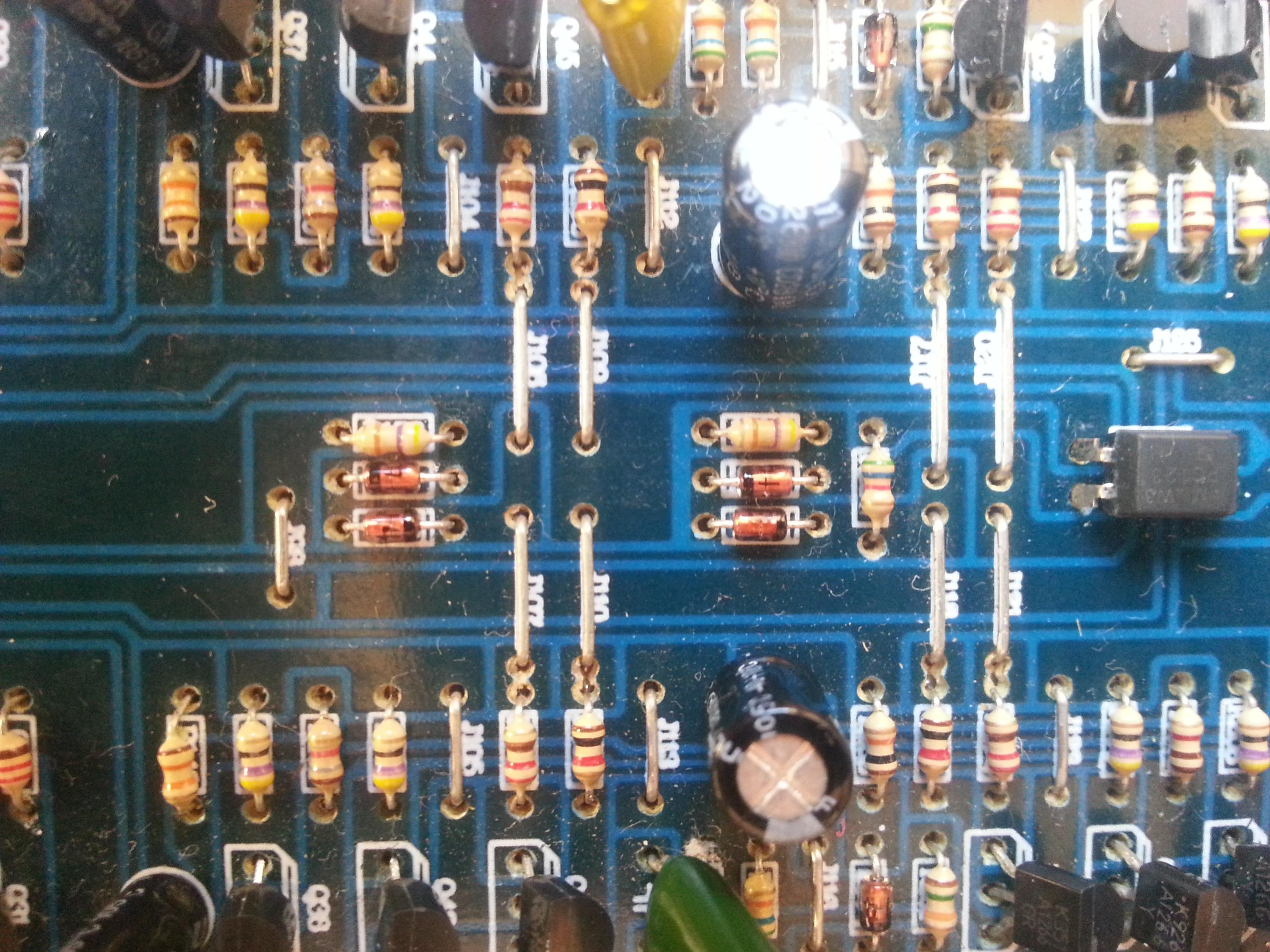

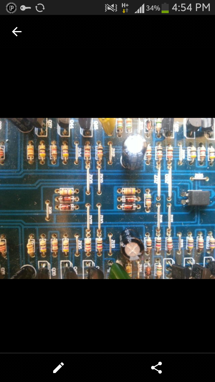

Can you post a good quality photo of the area in the attached image?

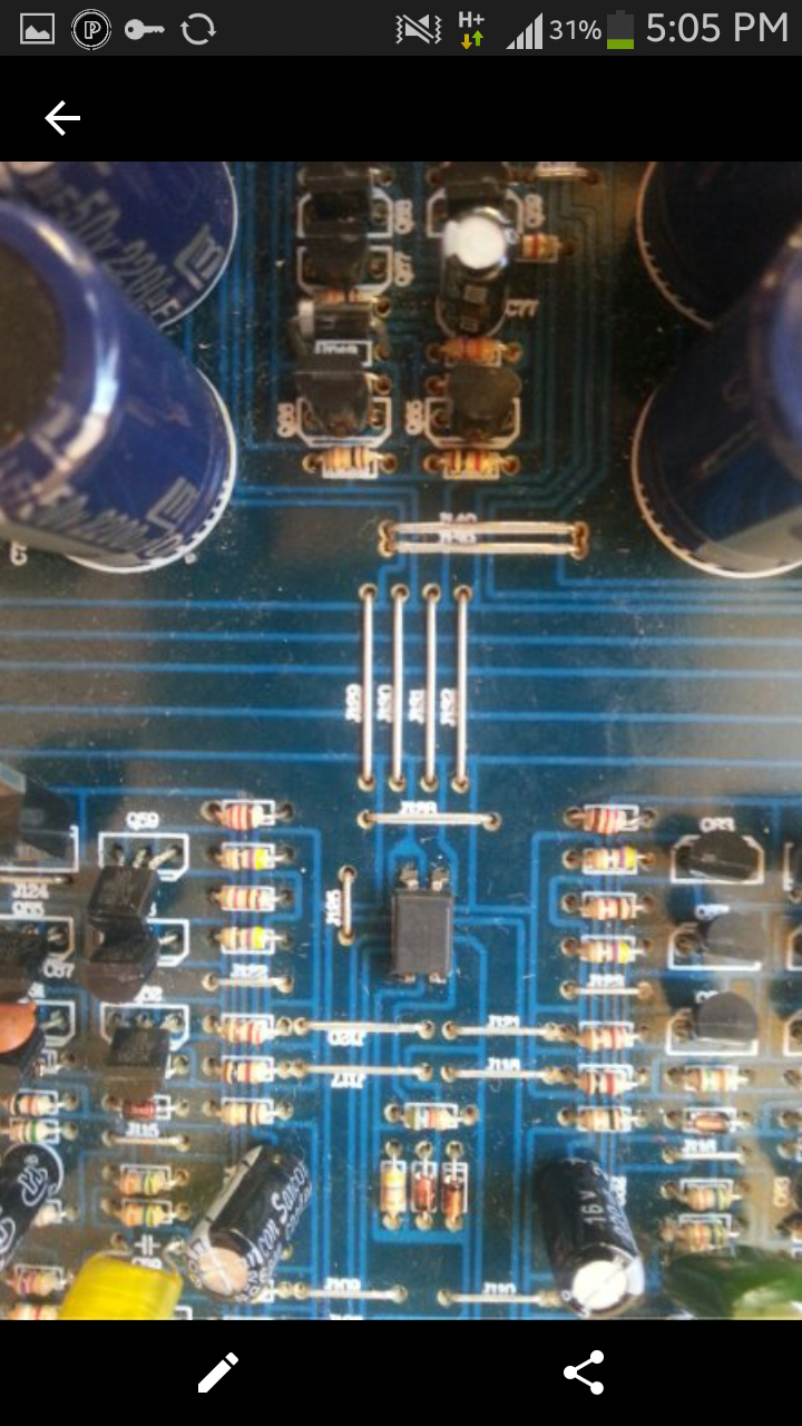

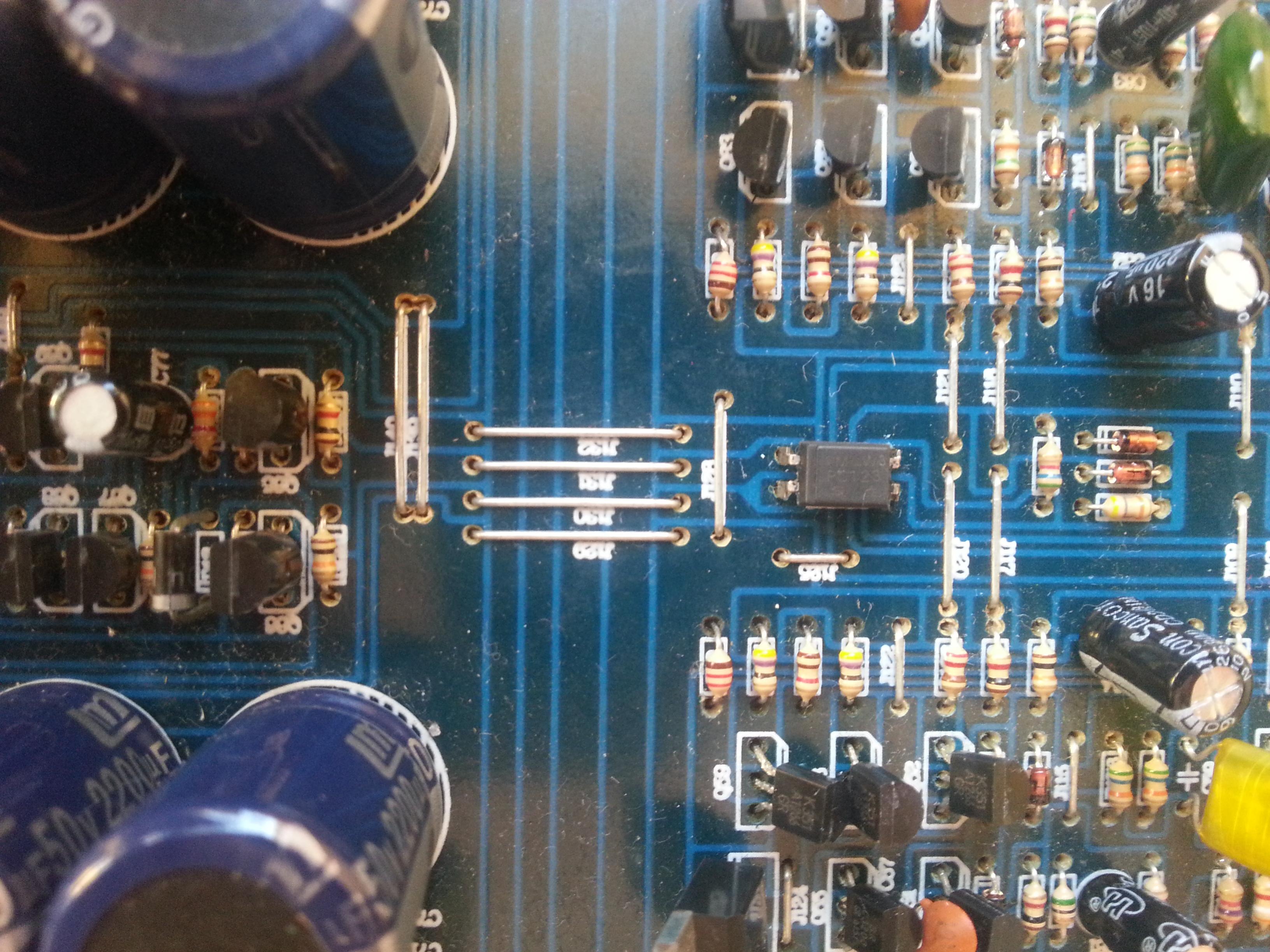

Perry,
You almost right! there something to do with the mute lines. One mute transistor is shorting the adjacent lead and affects the other 3 channels. They go at mute threshold why they are intermittent.
I have one more question how did you know by seeing the scope shot that there is a muting problem?

I initially thought it was a bias problem. After seeing the scope image, it seemed to be more of a power supply problem. I've seen muting circuits distort the signal so that was one of the things to check when you stated that all of the supply voltage were OK.
The opto-coupler switches the power supply for the differential amplifiers. This isn't a conventional muting circuit where the audio is clamped to ground. It disables the first stage of the amplifier.
If shorting pins 3 and 4 of the opto-coupler makes the amp work properly, the problem is that the opto-coupler isn't being driven fully on. The capacitor on the base of the transistors that drive the LED for the opto-coupler has been leaky in other amps and when leaky doesn't allow the opto-coupler to be driven on fully.
