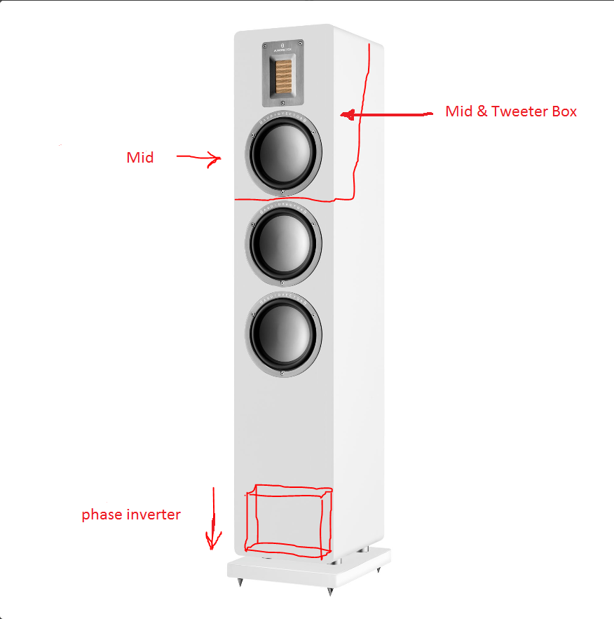

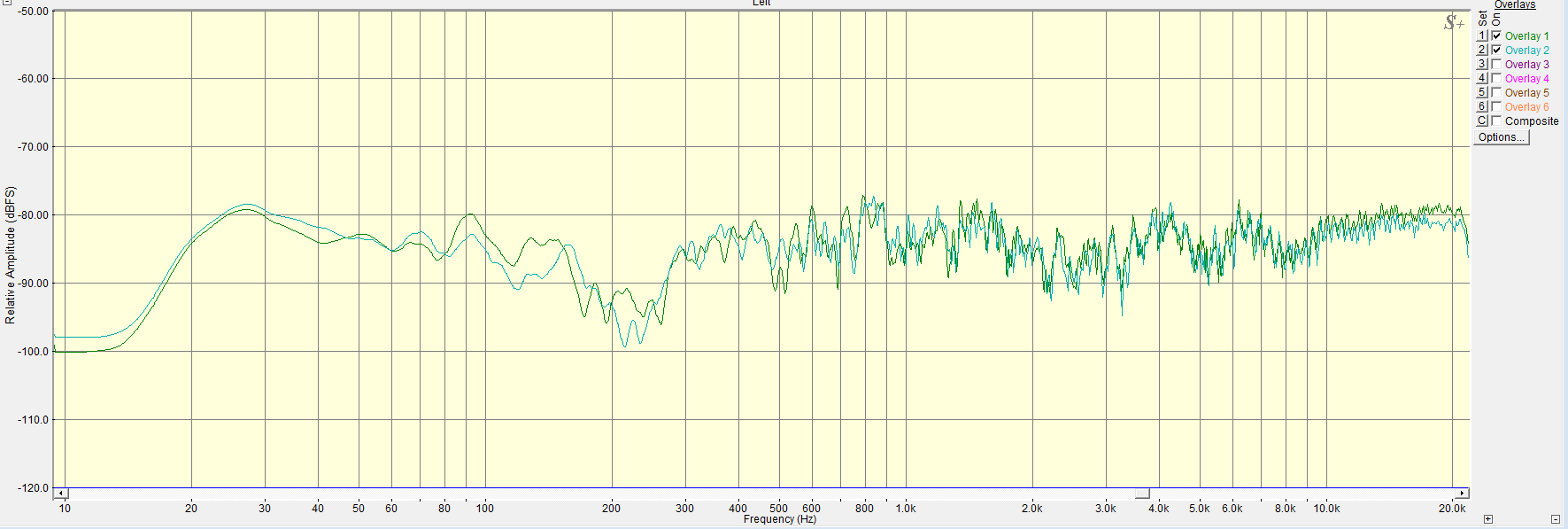

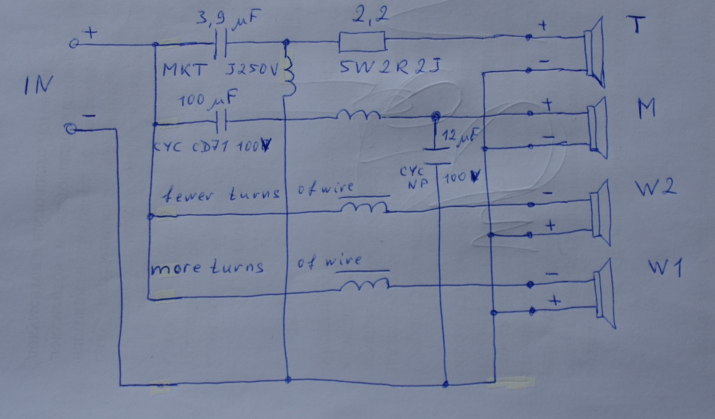

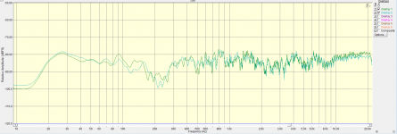

AllenB, hello. There are a few questions about my acoustics. This is an open box with a phase inverter with a rectangular output. Two midbasses, one mid and tweeter. I want to redo the crossover. In the initial state, the manufacturer claims the midbass-mid-400 Hz section frequency, mid-tweeter 3 kHz. With this crossover, the lower middle is in the hollow to - 20 dB from 100 Hz to 300 Hz. The lower midbass is trimmed by a larger inductance coil, the upper midbass is slightly smaller. These are the first orders. The middle from the bottom is cut off in the first order, from the top in the second. Tweeter second. It is a tape. Midbass are turned on in reverse polarity, and the middle and tweeter are in right polarity. When I switch midbass to right polarity, and the middle and tweeter also stay in right polarity, the middle gets better, the bass gets smaller. Which way to go to get a normal lower middle and normal bass? I took measurements of the impedance and phase of the whole system as a whole, the frequency response for each speaker without a filter, with filters and the whole system. The speakers were in regular places.

I'd want to know why you have a dip at 100-300Hz. Maybe it is the crossover but maybe it is your box.
Please explain, or photograph your box. You say open box with a phase inverter with a rectangular output. Is this cardioid? Is it an open baffle?
The crossover circuit will be a little later.

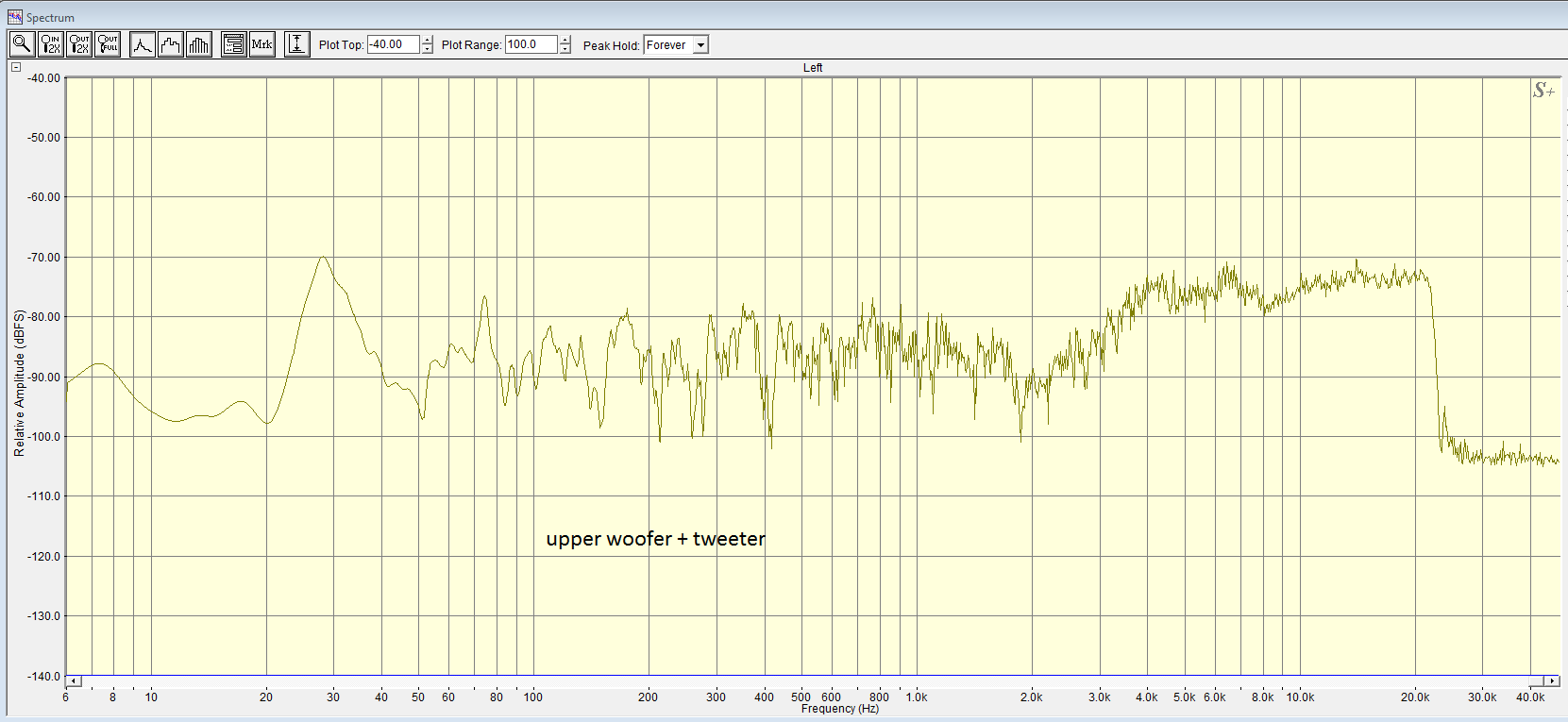

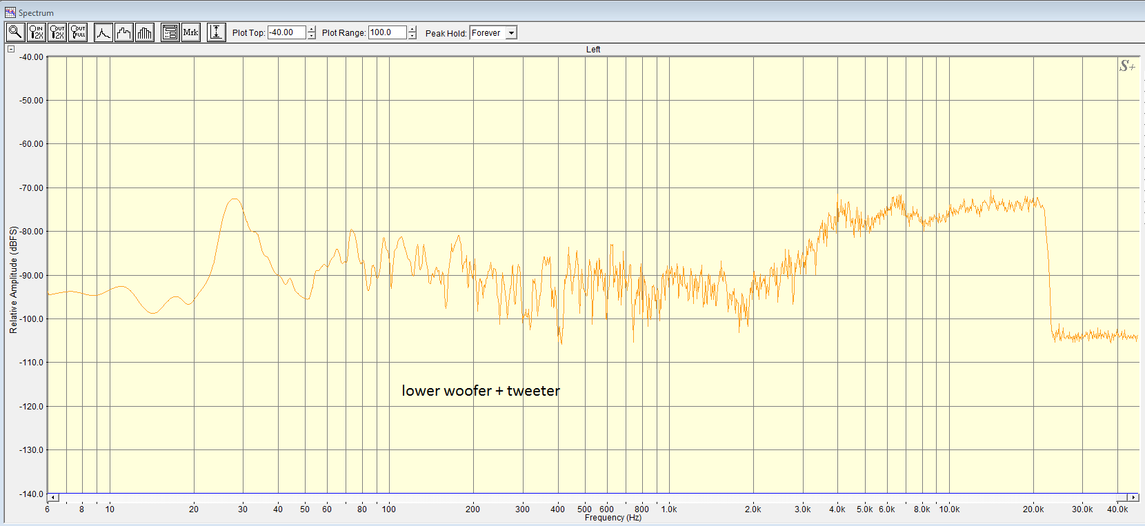

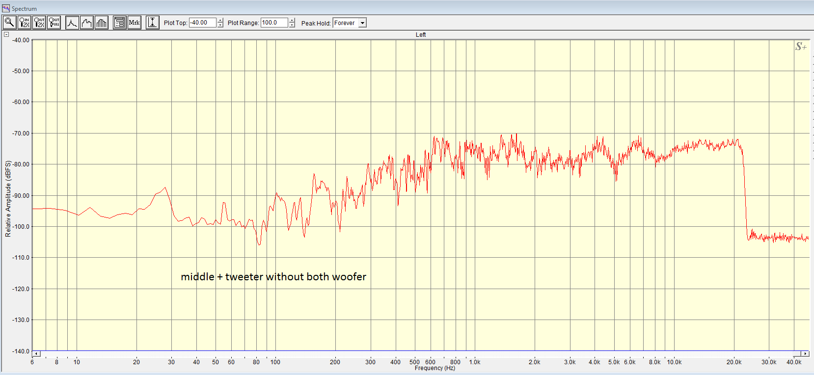

Can you show the response with two woofers disconnected, with lower woofer and mid disconnected, and with upper woofer and mid disconnected. (only one channel is necessary, and the tweeter doesn't matter)

I see three things happening in the 170Hz-270Hz region. The lower woofer is cutting out, the midrange is cutting out and the upper woofer is offering some dips which may be related to room reflections.
I also notice they don't add up the way they would if they had a better phase relationship. The quick answer would be to try reversing the phase of some of the drivers.
Since you are measuring, it would be worth getting quasi-anechoic measurements and using a simulator. Maybe you could start a thread to that effect. The levels, response shapes and phase relationships could be adjusted. There is some tweaking of the upper crossover that could be done as well.

Measuring at a distance will give a better account of the baffle, and your issue is below or around this region. Can you take the speaker outside so you can lift it off the ground and test for the floor reflection?
I think I learned how to do Quasi anechoic loudspeaker measurements. Something has already been measured. For example, lower woofer + tweeter + port. But I'm not sure that is right. It may be necessary during the measurement to work all the speakers. They exert their influence, and if they are excluded from the measurement, there will be an inaccurate picture. What is your opinion?
While I was typing a message, you added a response. But I still want to know the answer to my question. Because during measuring in a very near field, I saw that the port of the bass reflex has peaks in the range up to 1000 Hz, which have a level as the main signal. but in antiphase. Maybe it needs to be fixed. And then I can get any speaker out of the case. And measure what need.
Sometimes no, sometimes yes. I would want to identify something along the lines of the following..
Yes, this could be important. What have you done to stop this? Can you describe the box stuffing? Do the two woofers work into the same part of the box?
In the picture in post No. 3 3.5 Way Crossover with Measurements I drew a box for the midrange and treble. The rest of the space inside is for two woofers. Behind the woofers is one space. At the bottom is the port. There are reinforcing partitions, but they are close to the walls and have a distance of 2-3 cm from the walls. Air can freely move throughout the housing, except for a separate box for the mid-high frequency. Inside on the walls absorber except the front.
