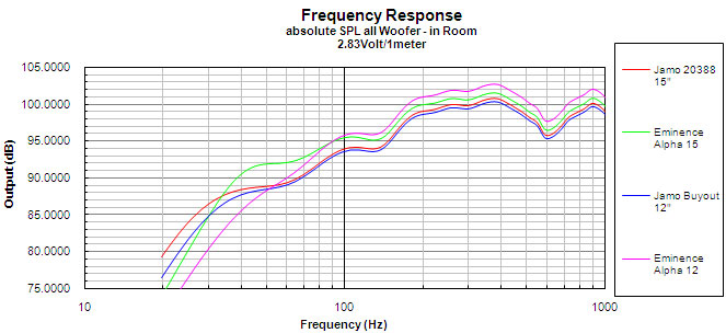

Here's a sim on open baffle. I don't have much experience interpreting sims on ob but did this to see how the curves looked to compare. If we can assume the Alpha 15 is a 'good choice' in an H-frame based on the curves i would estimate both Jamo's follow it's curve whereas the Alpha 12 does not, especially in the deepest bass that it can reproduce. This is just a guess as to whether the Jamo's or the Alpha 12 might work well in H-frames.
Based on what i see, either Jamo would work if using a dedicated amp to power them. This way their lower sensitivity would not be an issue. The Alpha 12 does not look like a good choice to me because its response continues to dip.
This chart must look funny but understanding that the H-frame response will be cut out around 200hz and equalization circuits are applied (my amp has a variable crossover which i think is set to around 60hz) the response balances out from around 30hz thru 200hz.
Maybe someone could shed more light on this?
