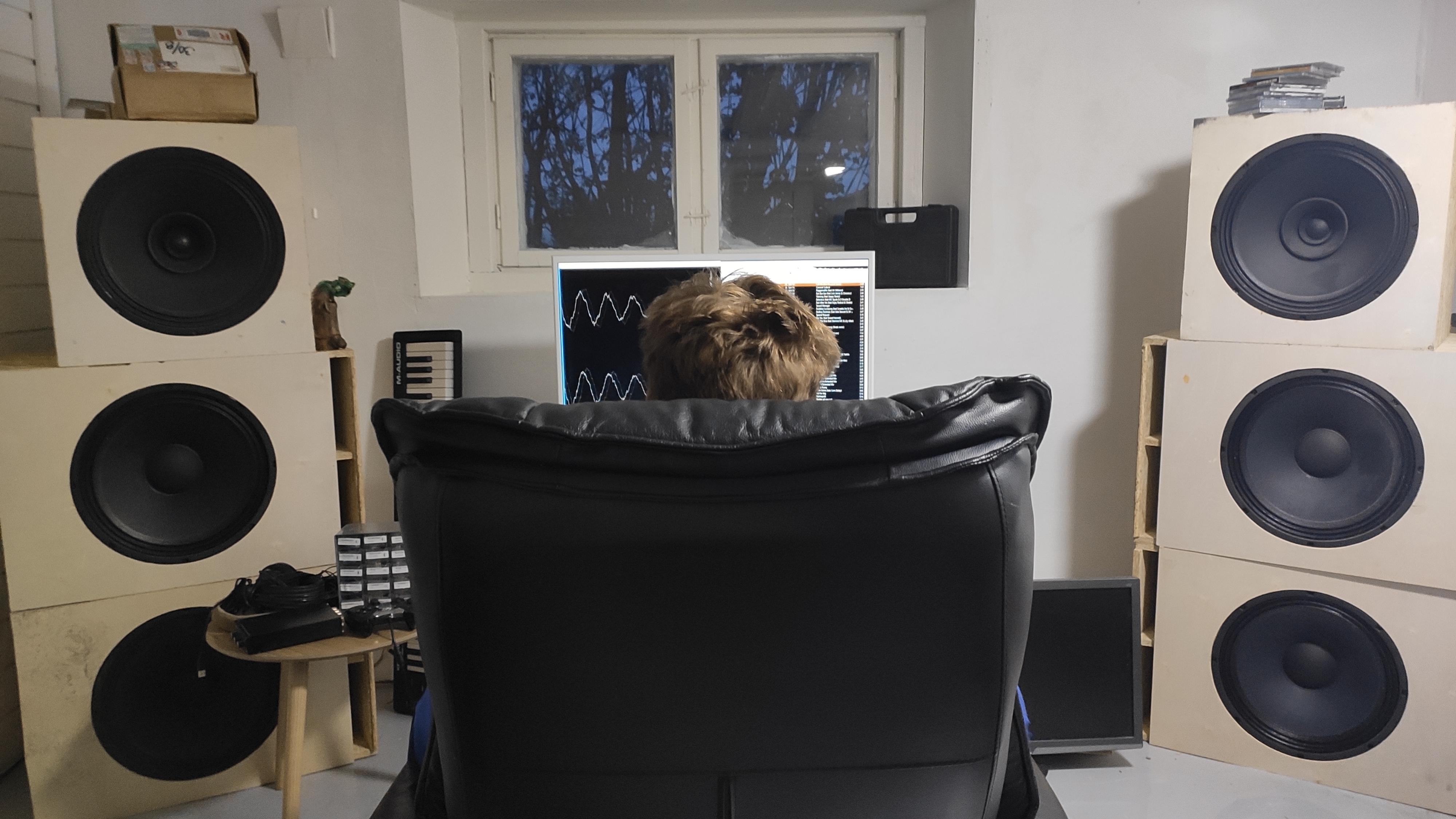

I think best value for money if most of europe would be a couple Beyma 12BR70 in closed boxes.
My almost 9 year old daughter has 2 in her room, not in closed boxes, about 120 liter T-TQWT each.
A couple closed boxes 55-60 liters each would probably be more than enough.

If you want something that uses a box the width of ca 13", get the Beyma 12BR70 and make a closed box. Cheaper than two W6-1139 and easier to build, more displacement.
This one can go down to 30 hz in a smallish box. speaker trade - mivoc AWM 104 10" (25 cm) Tieftonsystem

Me listening to one of my systems. "There's no replacement for displacement"
