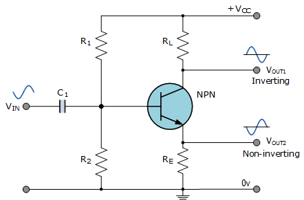

Does anyone know if the single transistor inverting circuit will work for line level mono going into the amp.
Also am I right that the phase inversion is on the input?

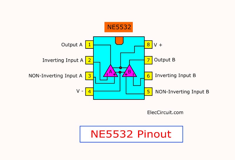

Ok, I have a ne5532 opamp chip that I found
Using my two supplies I can give the ne5532 +-6v. Could I have my audio signal coming in on pin 6 for it to then come out inverted on pin 7?

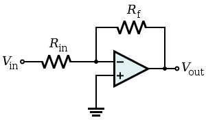

Or Would I need to set up a circuit around the opamp like the one below

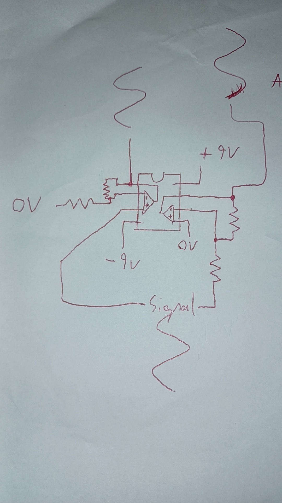

Currently got this with a 4558d dual opamp, I think it's OK?
I don't have any equipment to generatr or measure the sine wave output, but it did manage to take mono audio signal and play it through a small 2" driver connected to the inverted(sp-) and non inverted(sp+)output (not sure if this is really an effective test)

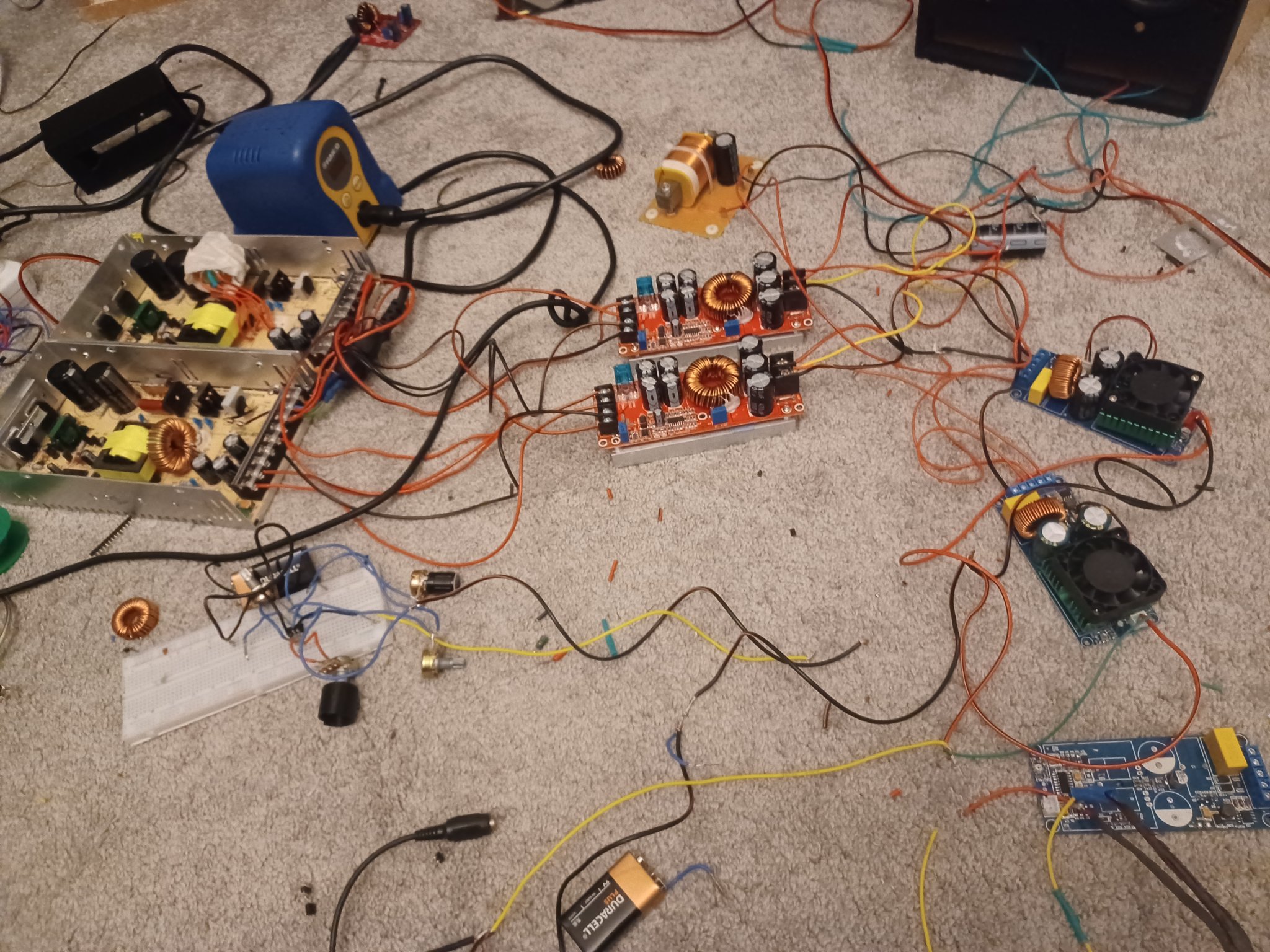

Ok, I wired the dual op amp phase inverter, non inverted to one amp and inverted to to the other amp.
Speaker is wired to each amplifiers positive output
Began playing music, at low volume there is alot of background noise, but it works, especially once the volume is turned up the background noise goes, hopefully just my breadboard op amp circuit
I've got a big issue in that my two irs2092s amplifiers are very slightly different to eachover, one uses different transistors, different heatsink, and has a potentiometer for adjusting the amplifier switching frequency. This one stops working correctly at high volume, it begins to cut in and out? The other one doesn't have this issue but can't really go as loud, can't find this variant anywhere.
I think there's a few possibilities for why the odd irs2092s one is cutting out.
Maybe it could be to do with the switching frequency the amplifier is set to? The one that works has a fixed switching frequency, the odd one has this adjustable potentiometer.
I don't think it's my power supply, as one of the amps works perfectly from it at full volume
