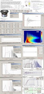

Agree, Here is a suggestion that doesn't need much power but would stay within a maximum requirement of ~10 W:
b

Bjorno, I jus't can't read the image you attached...too small !
