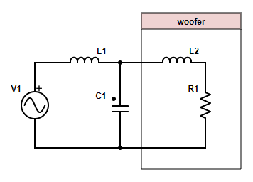

Shown is an idealized representation of a woofer with its 2nd-order low pass crossover. It is oversimplified for 2 main reasons: 1, the impedance peak at resonance is completely ignored, and 2, the gradual impedance rise with frequency is not owing to voice coil inductance alone and as such it is not simple first order -6dB/octave, but approximately -3dB/octave or thereabouts depending on driver.
If the driver is purely resistive, or an appropriate impedance stabilization network has been applied, L1 and C1 could take on a wide range of values, keeping the crossover frequency fixed, corresponding to the wide range of possible alignments (LR, BW, Bessel, etc.)
Together with the inductive component L2 of the idealized driver it looks like a 3rd-order filter. No claims are made here that the driver's response corresponds to the response across R1 (far from it) or that the idealized model captures adequately what a real driver does. If anything both R1 and L2 varies with frequency. At certain frequencies the load isn't even inductive.
First observation: L2 and R1 can be (and should have been) measured, preferably mounted in the intended enclosure (cause the impedance certainly changes with the enclosure, although if the crossover frequency is high enough it makes little difference). If the impedance measurement includes phase measurement then L2 and R1 can be calculated from the impedance and the phase angle.
Second observation: if L1, C1 and L2 form a Butterworth filter there would be 3 equidistant poles on a perfect circle on the s-plane. Now we don't get to decide L2 - you can't have everything and if we are not keeping the impedance fixed something else will have to be variable and in this case it will be filter alignment.
So, there must be an ellipse on the s-plane, corresponding to a Chebyshev filter, and we can fix the 3 poles on the eclipse so that L2 equals to the value we measured, assuming L2 at the crossover point is the value to use. Butterworth is but one special case of Chebyshev filters just as a perfect circle is a special case of an ellipse.
I am working on the math to calculate L1 and C1 now and I will see if they simulate well in XSim.

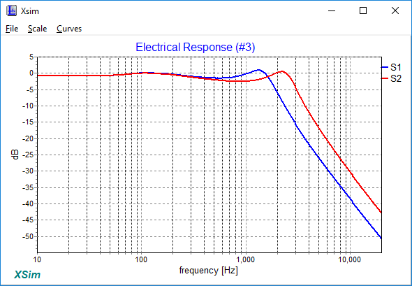

Whether a zobel is needed has to do with the ideal vs actual electrical transfer function, as in this image from one of my blog posts:
The same filter is used for S1 and S2, but S2 has a Zobel applied.
So maybe you can take the approach of the intended -3dB , and the ideal vs. actual driver impedance at that location? The other thing I am thinking of is that if there is variation below -20 dB, we also don't care very much. For these reasons I'm tempted to imagine a "rule of thumb" that involves the LP filter Hz, and slope along with something about the driver's Z - R at the filter knee.

In this example, I am aiming for a crossover point of 1.7kHz. S1 and S2 are the same woofer fed the same impedance data measured by REW. S2 uses L1 and C1 values from an online Linkwitz-Riley second-order calculator with the woofer's nominal impedance which is 4 ohm. S1 uses the Chebyshev method I outlined above. In both cases component values are rounded to the next nearest common value but this does not and should not make any noteworthy difference.
It is obvious from the graph that S2 ends up being way off its intended filter response. This demonstrates the perils of oversimplifying the driver to be resistive, using the nominal impedance for calculation but not applying an impedance stabilization network.

Discussion: there is a ripple in the filter response. If you had used a Zobel network and a traditional audio filter you would be able to get rid of the ripple. However, the LR2 network also had the ripple - the combined response of LR2 and the woofer's inductance does not look like LR2 at all, so the peak is not an issue of this method per se but an issue with not using impedance stabilization in general.
Both curves are steeper than 2nd-order.

I think I will have to get back to the point Erik. In principle we are not in any way in disagreement: there is worthless math which give rise to inaudible results that we can safely ignore.
But to get back to the point, alignment is not pure math, it is audible. There is another thread running right now about the power response and on-axis response of LR vs Butterworth. Power response is clearly audible don't tell me otherwise. It is illuminating read and I learned a lot from that.
Note I didn't even have to invoke any concept that had dubious audibility like phase change/group delay.
It dawned on me that some of the words I spoke had potential of a major misunderstanding (and that huge misunderstanding may have already happened). When repeatedly challenged why I defined "the best" in a certain way, I answered that it was to placate the religious zealot. It suffices to say that that person has not appeared yet, and is not any of the participants of this thread.
The religious zealot is the "audiophile" who rely on measurements to the micro-ohm. This profile clearly did NOT fit any of you. I spoke of this imaginary person in a very derogatory manner. If there were a scale where one end was the irrational "audiophile" and the other end was rationality, I was closer to the "audiophile" end than any of you. I couldn't have been insulting myself so I could not have been insulting you.
Hope this clears things up. I apologize if anyone misunderstood and got offended. It was not my intent but I regret to have said what I said if you misunderstood and felt offended.

It came to me, without surprise, that I am merely reinventing the wheel. Everything I did was itself a simplification of Wright's empirical model. There is a Wavecor document about it: http://www.wavecor.com/Transducer_equivalent_circuit.pdf
It expressly states that the Res and Les parameters on the spec sheet are usually unsuitable for crossover design, but the Wright model could.
