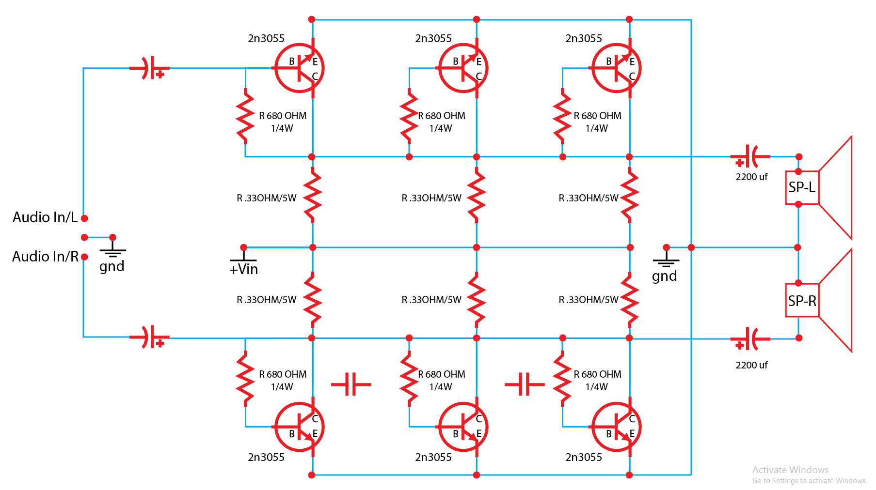

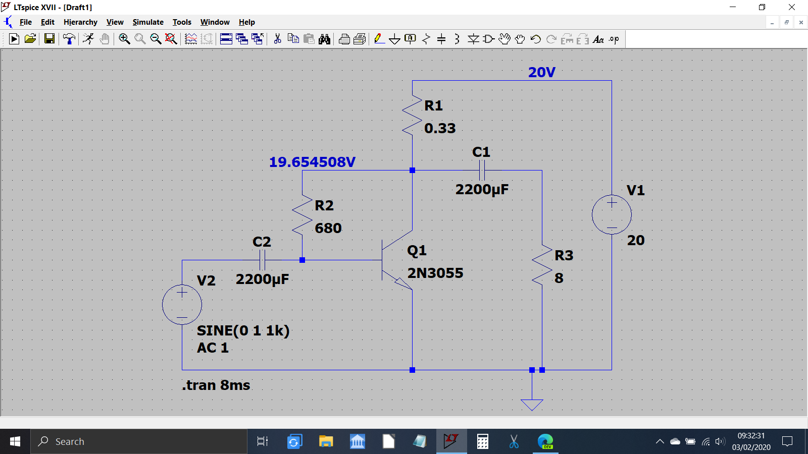

I think probably easiest to just say no, it will not work as an audio amplifier.
If you had sufficient base bias current (you probably don't with 680 ohm although it is supply dependent as well) then all that will happen is that each transistor will conduct heavily and get very hot.
There is no significant signal voltage (what you want) developed across the 0.33 ohm resistors.

Thank you for the advise i thought it works as a ampI think probably easiest to just say no, it will not work as an audio amplifier.

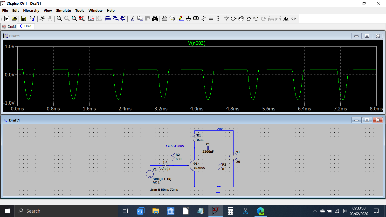

This is what would happen. The output voltage would be very distorted and of very limited level.

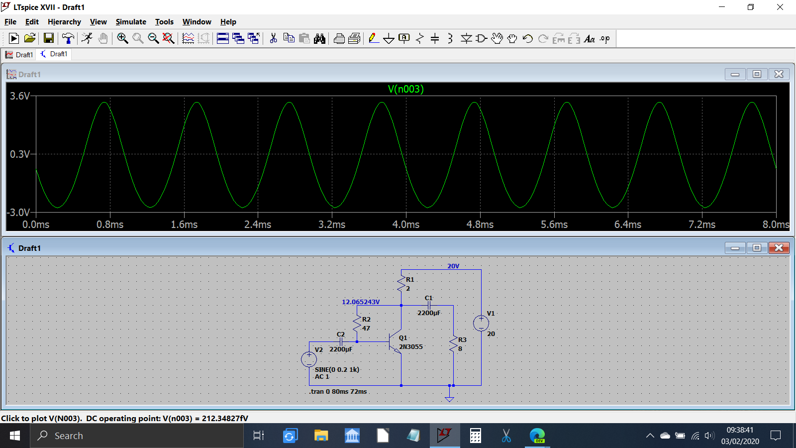

Assuming the gain of the transistors allowed this we could alter values and get something like this but it is still very poor and very inefficient. With a 20 volt supply we have 4 amps flowing and the transistor is dissipating nearly 50 watts. There is a bit more output voltage available now and the distortion is lower but still very poor.

150W RMS from a couple TIP142/147?
You guys are really redefining Physics Laws

2n3055 needs driver circuit and Vbe multiplier.
The problem isn't actually the transistor ... it's the design the OP put up.
While it would do something, it would not work as an audio amplifier.

The gain on the 2n3055 is very low. So is Vce . So is bandwidth.

All the more reason to start with something expendable, like surplus 3055’s and low voltage power supplies. That circuit wouldn’t work with the latest and greatest $14 apiece 80 MHz fT sustained beta devices from Sanken. The values that Mooly suggested would get something working, albeit not well. You’d still be better off with cheap expendable parts for experiments like these. A lab power supply with a 3 or 4 amp fast acting current limit would also go a long way towards preventing instant charcoal.
Apex AX6 has the same # of transistors, 6, and works very well. Retro Amp 50W Single Supply - Page 22 - diyAudio
This needs the 0.33 resistors in the emitter leg instead of collector leg, to prevent thermal runaway. Need about a half amp of base drive to get 2.5 amps out, about max for a 2n3055. The 680 ohm base resistor won't allow that. AX6 uses 10 ohm OT base resistors. You'd have to have an audio amp as the source of the input to produce the half amp drive, too. Plus a 1000-2200 uf input cap. The driver transistors on the AX6 make the half amp drive, the vas transistor the voltage to drive them, and the input transistor gets drive current required to drive VAS down to what the earphone jack of a portable radio, CD player, mixer or preamp will provide. There is a diode stack between the drivers of AX6 to prevent the output transistors from switching on and off every time the input goes through zero - which sounds awful. Called "crossover distortion".
