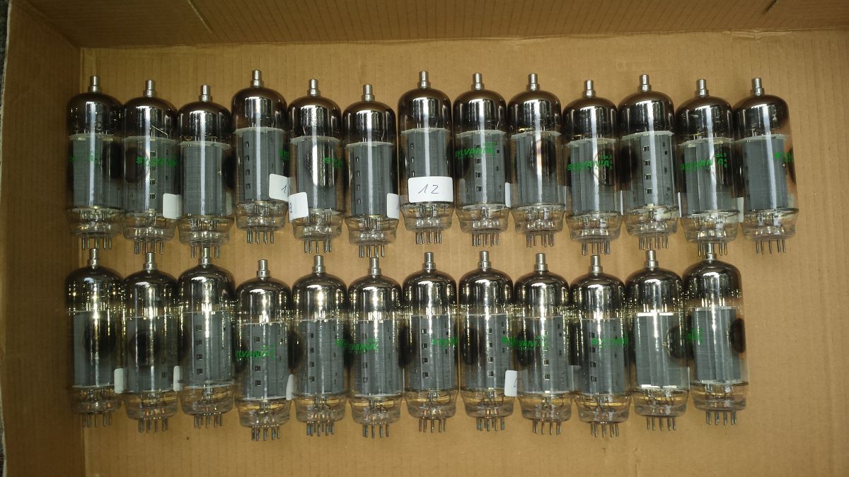

Good Friday everyone,
Taking inventory of all the stuff (wife calls it junk!) I have, I've come across 20 new Sylvania 20LF6 tubes. Putting ~500v or so on the plate and ~150v on the screen, any thoughts on transformer impedance for the balance between power and distortion? I have 4K transformers on hand, but if 3.3K or 2.2K are better choices, I'll buy them.
Ray

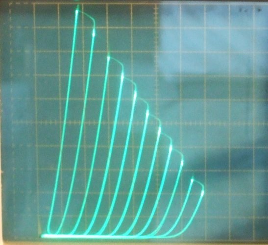

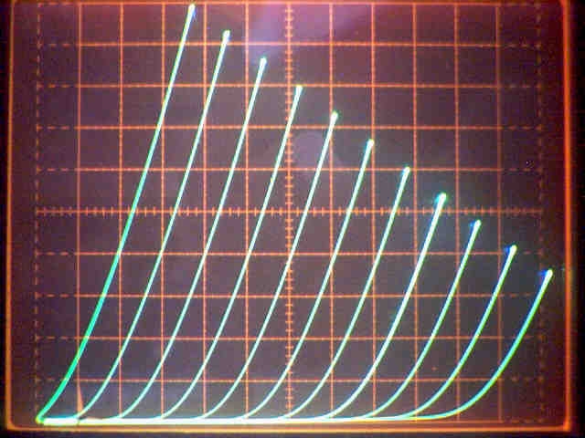

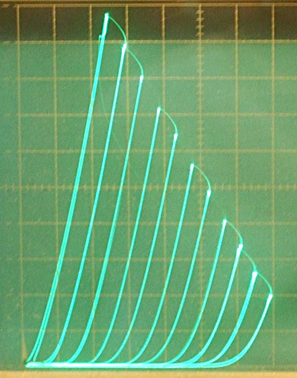

The quality of an -individual tube- for low distortion is most evident when configured for triode mode and curve traced. You will find that this selection method will give results far better (reduced 3rd and higher harmonics for pentode use!) than just picking an audio class versus a non audio class tube. Take a look at the selected 36MC6 sweep tube in triode mode below (1st pic). Or a selected 12HL7 in triode mode (2nd pic). Competitive with a 300B.
One can get even fancier and use emulation models to control the output tubes behavior with local N Fdbks. 1E7G would be a great triode model (in triode mode) to make TV sweeps emulate. Better than the 300B! (see pic3) One uses a differential driver for -each- output tube, with the model tube in the local N Fdbk path to its plate. A frame grid 12HL7 used for the other half of the diffl. driver stage will provide plenty of gm to enforce mirror performance between the model and the output tube.
