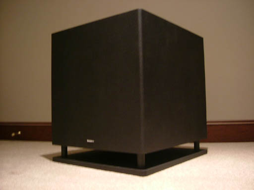

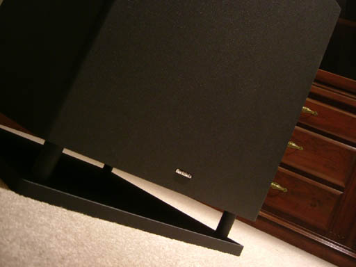

And for Brion55, here are a couple pics of my sub. I took more, but they all came out blurry when I opened them on my comp
But anyhow, here's how it turned out. I even made my own custom label for a true finished look 😀

edit: nice work on the sub btw 🙂
