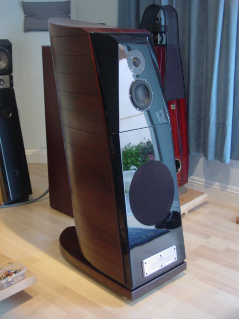

If you already plan to use stands with your 2-way design, you should also give some consideration to a 3-way tower speaker. Same floor space. A sexy cabinet is often more attractive than a simple stand.
Yes, a 3-way is more complicated, but it also allows using a smaller diameter midrange offering lower Mms and superior polar response, which is a good marriage partner to a Be tweeter's high'ish xover frequency.
Usher speakers now offer both Be tweeter and midrange in a sexy cabinet.
