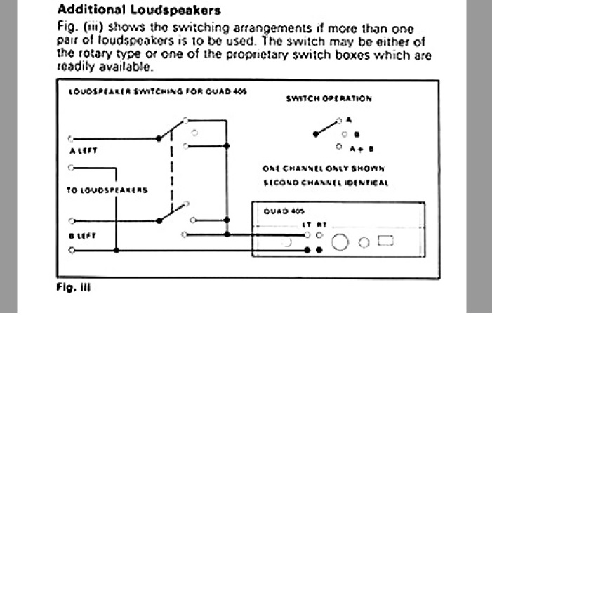

Can I wire 2 pairs of ditton 25's into a Quad 405 ? the amp has no output info on the back .. with one set of speaker out puts .. and the dittons say 4 to 8 ohms 60w on the back.
I recently found the online manual for the 405 with a section that would make me think its no problem .. but I need a 2nd opinion from some one with more knowledge .
Will I damage any thing ?
T.I.A . Dom

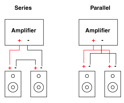

I would not run the Quad 405 into a low speaker impedance like 4 ohm - I'd go no lower than 8 ohm.
(The 405-2 was an improved version better able to run into low impedance speaker loads.)
If you want to run two Ditton 25s from each channel of your 405, then wire each pair in series (not in parallel) to ensure a high impedance load (nominally 12 ohm).
The 405 is powerful enough (100W into 8 ohm) to go very loud with the 12 ohm series combination.
You will almost certainly damage the 405 by connecting each pair of Dittons in parallel, as that would result in a load impedance as low as 2 ohm on each channel.Will I damage any thing?
Wire each pair in series only as I indicated in my prevous post.

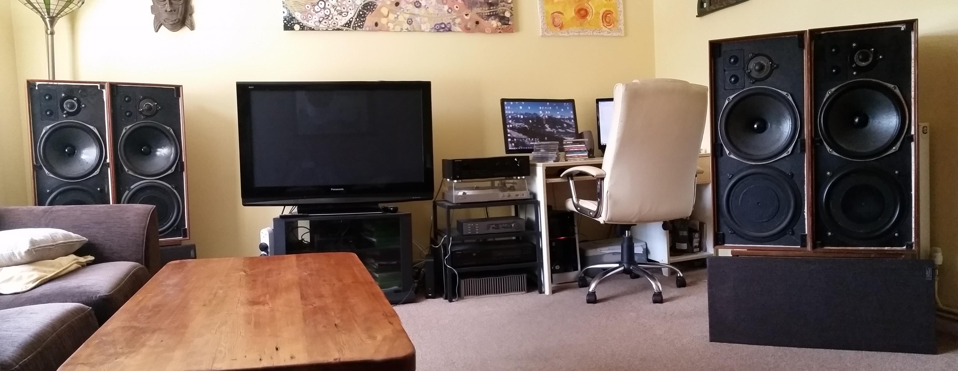

Thanks for your help Galu ... I've set them up ... 1st impresion is ... WOW ... But it might be a bit of a heavy load when turning it up really LOUD .. The sound has lost a little of its tightness of the bottom end . the attack seems a little stilted and a maybe a bit blurry on the decay at very loud .
I've been listening at just loud
volume and messing about with the settings for a few hours now ... Its a great sound .. when you don't over work the 405 .. its alot of weight for it to move .. I think ?
I've only recapped one pair so this might also be a factor . . I'll probaby leave it like that for a month then go back to the single pair for retest ..

If you're worried about the higher impedance when a pair of Dittons are wired in series then don't be.Its a great sound .. when you don't over work the 405 .. its a lot of weight for it to move .. I think ?
Rated at 4 to 8ohm per speaker, you're getting 8 to 16 ohm per series pair, the latter being a more comfortable load for the 405, if anything.

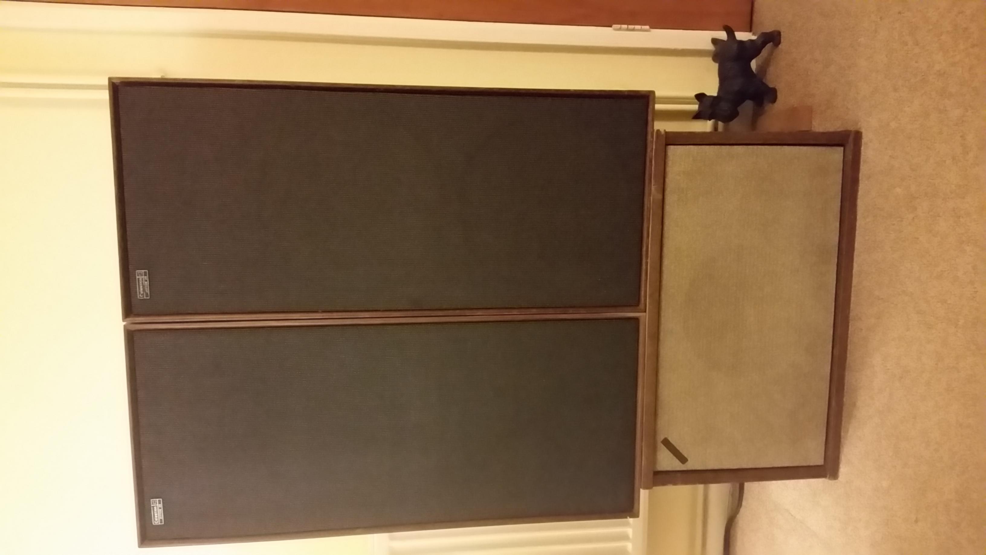

P.S. Like the speaker overkill look!
I've got them sitting on a pair of Tannoy 10" LZ -111 .. they need recapping too .. but they act as an extra bass reflex .. I was wondering what would happen if i closed the circuit on the tannoys with the energy being tranfered from the 25s on to the coil of the tannoys .. would it make any difference ?
