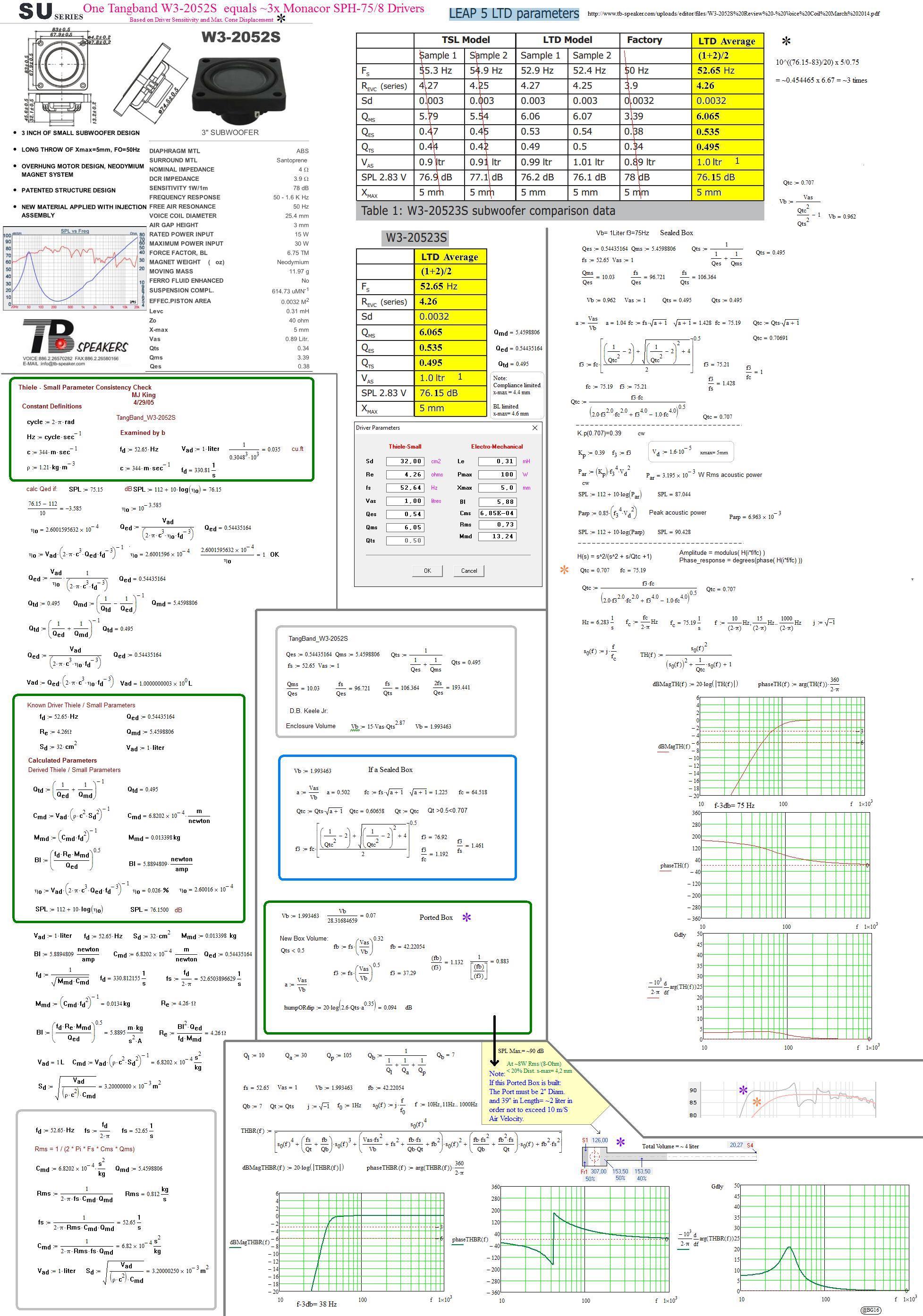

I returned that Monacor driver because it was not good. I might be able to get the Tang Band W3-2052S driver in a few weeks and I am also wondering if using the Peerless by Tymphany 830878 3-1/2" passive radiator could also help this compact sub-woofer.
How would things change if I add this passive radiator?
Also, is there any problem if I mount the passive radiator at a 90° angle?
