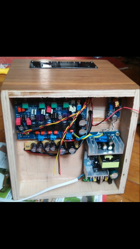

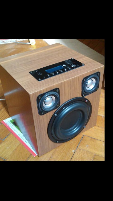

friend and I are planning to do something similar to what you decided to do; and choose exactly the same drivers (1xW5-1138 & 2xFR58ex - planning to xover them at cca. 250Hz). I decided to use some 2.1 tpa3116 based amplifier and 24v switcher PS. Bluetooth car media players also look suitable. I hope to pack everything in 25cm cube.

The way I am designing mine may well end up being close to a cube. The speakers will be on either side of the sub as close as I can fit them. The idea is to keep it as small and as portable as possible within reason. I know it is not perfect but it will still blow any off the shelf Bluetooth out of the water.
