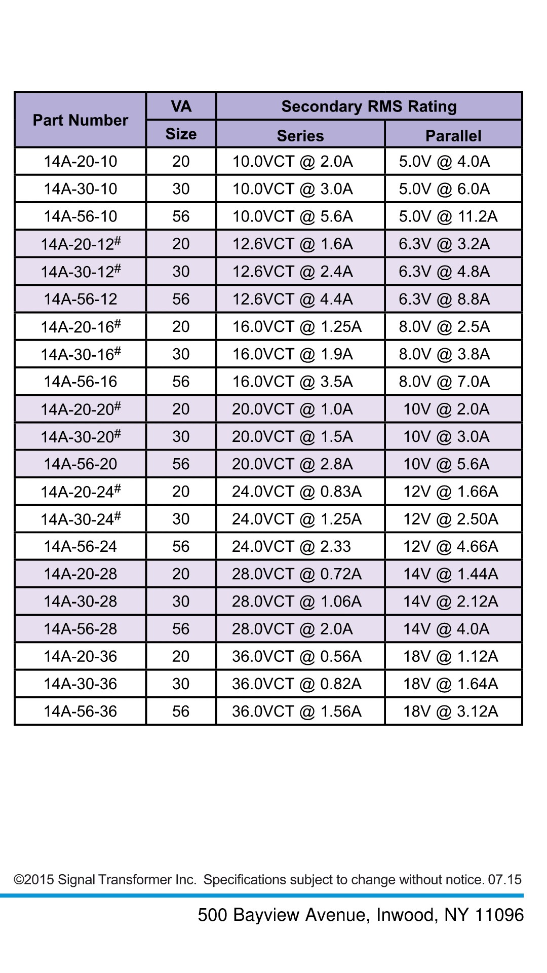

Hello I need some help with the 1977 nelson pass 20w amplifier.
I am confused about the transformer.
In schematic it's 14v +- and in bom its writed signal 56-12
Signal 56-12 is 2x6.3v......

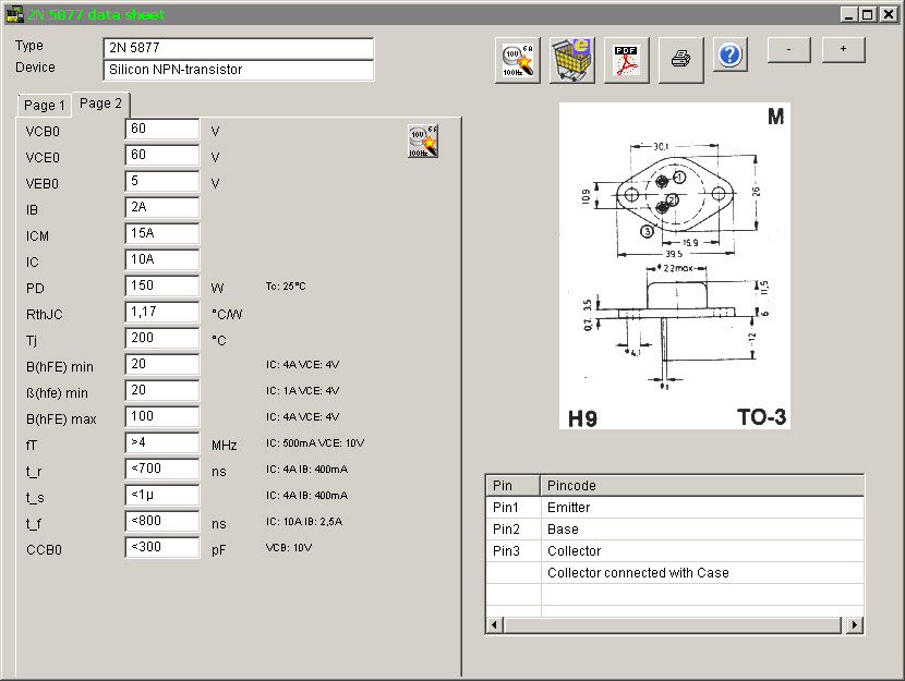

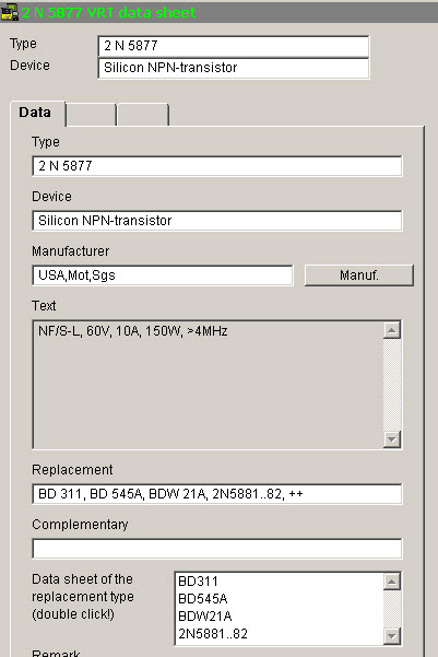

And someone can say me if I can use 2n5878 in place of 2n5877 because I don't find enough 2n5877 from the same brand....
The 2n5878 are PMC brand anyone have experience with this brand ?

you have picture/schematic of PSU , why on earth you need BOM specification of xformer?
xformer secondaries are 28Vac center tapped , per picture on top of page 5
so , two independent secondaries of 28Vac (CT) , where one goes per channel
that will give you something around +/-17Vdc for rails
and say that you need 250VA xformer
2N5878 is same part as 2N5877 , with higher voltage breakdown
PMC - dunno , doesn't ring a bell ...... but I'm probably younger than these parts
edit: you can probably use decent 2N3055 instead

Sorry for asking.... You mean PCM transistors are good one for amplifier ?PMC = Lambda Semiconductors > Lambda Advanced Analog > International Rectifier
IRC = International Resistive Corporation > TRW > TT Electronics
Milspec parts- one small step for aerospace... one giant leap for Class A amps
no need for excuses , we all started somewhere
however - you need to be more careful in few things :
- xformer itself is not having +/- voltages (think AC !)
-look here : 56-12 Signal Transformer | Transformers | DigiKey
paraphrase of - one small step for a man , one giant step for mankind
About transformer yes I know they are two secondar or one center taped.
28v ac with middle point or two 14v ac.

I saw beta around 20 and up in my ECA VRT
