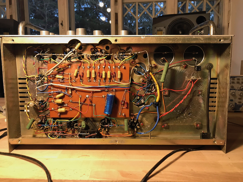

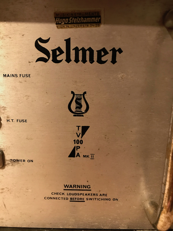

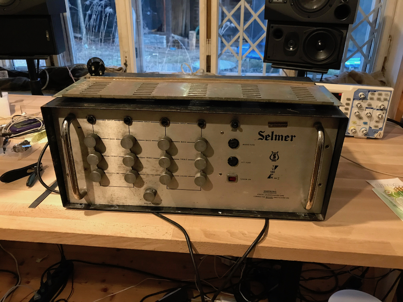

I just bought a stock 1969 Selmer TV 100 MKII PA head in original condition including four original Mullard Xf2 EL34s and ECC83 (UK factory)!
The amp is in full working condition (one channel has some noise, I suspect a failing preamp tube) and I will start cleaning and testing it soon.
Since it is not a real beauty or of historic value (?) and it is too heavy and big and loud to use it as an instrument amplifier (I play guitar and also build guitar amps) my first thougths were to use the giant PT plus output tubes to build a PP HIFI amp around them and take the rest of the parts (ie original Mustard caps and OT) to build a slightly less powerfull and big vintage Marshall style guitar amp.

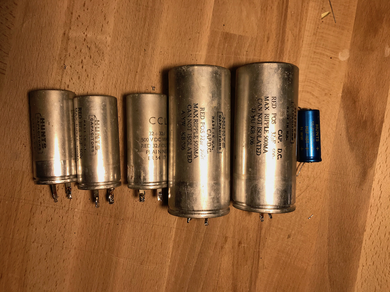

The big PS filter caps tested as leaky, the others tested fine, but to be safe I‘ll replace them as well as the bias supply cap.

So I replaced the powersupply filter caps and bias filter cap (just a safety measure), cleaned the tubesockets and fired it up slowly with a variac yesterday. The voltages all checked out close to the schematic. Had only tiome for a short checkup, but everthing works fine, the Mullards are all still sounding good!
The treble tone control of the first channel does not do a lot, I will check the caps later...and also the bias of the EL34s... (Maybe I will add a bias pot.)

Here you go...

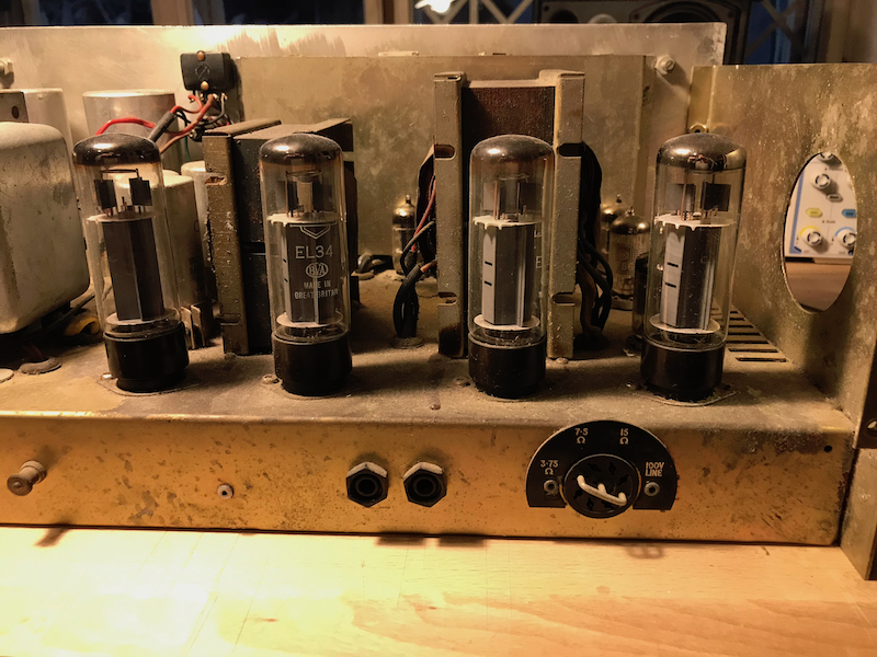

I took some measurements, the EL34 plate voltages are a bit higher than in the schematic (460VDC), the bias supply voltage is -45VDC (-34 in the schematic), so it is biased pretty cold. The other voltages are almost spot on.
Unfortunately the EL34s are not in good shape, I first measured the bias through the OT primary resistance/voltage drop and got very low values. I thought I made some mistake and took out a bias probe.
I got 8/11/0!/17mV drop (through 1 Ohm resistor) readings on the powertubes.
With 460V on the plates I get 3,6/5,6/0/7,82W from the tubes. So only about 15W! Strangely, it sounds much stronger and louder than that, but that may be because of the big iron.
I have ordered a quad of new EL34s, so I will see if the original tubes are really on their last breath when those arrive...

The original schematic voltages may have been measured by an Avometer, so a DMM will give slightly higher readings. Not enough to explain your differences I expect.

If the bias is too negative, it could be some components are out of spec.
I'd change it to adjustable bias anyways, preferably individual or per pair so you can dial in a better idle current.
By the way, the total displayed heat isn't a measure for the max output power.
You can bias them all the way in class B with no idle current at all and still get 100W output power.

Good points. I just never had a case before that a powertube had no idle current at all gong through it.
I will probably first check the resistors in the bias supply and then try lower the resistance before putting in a bias control.
