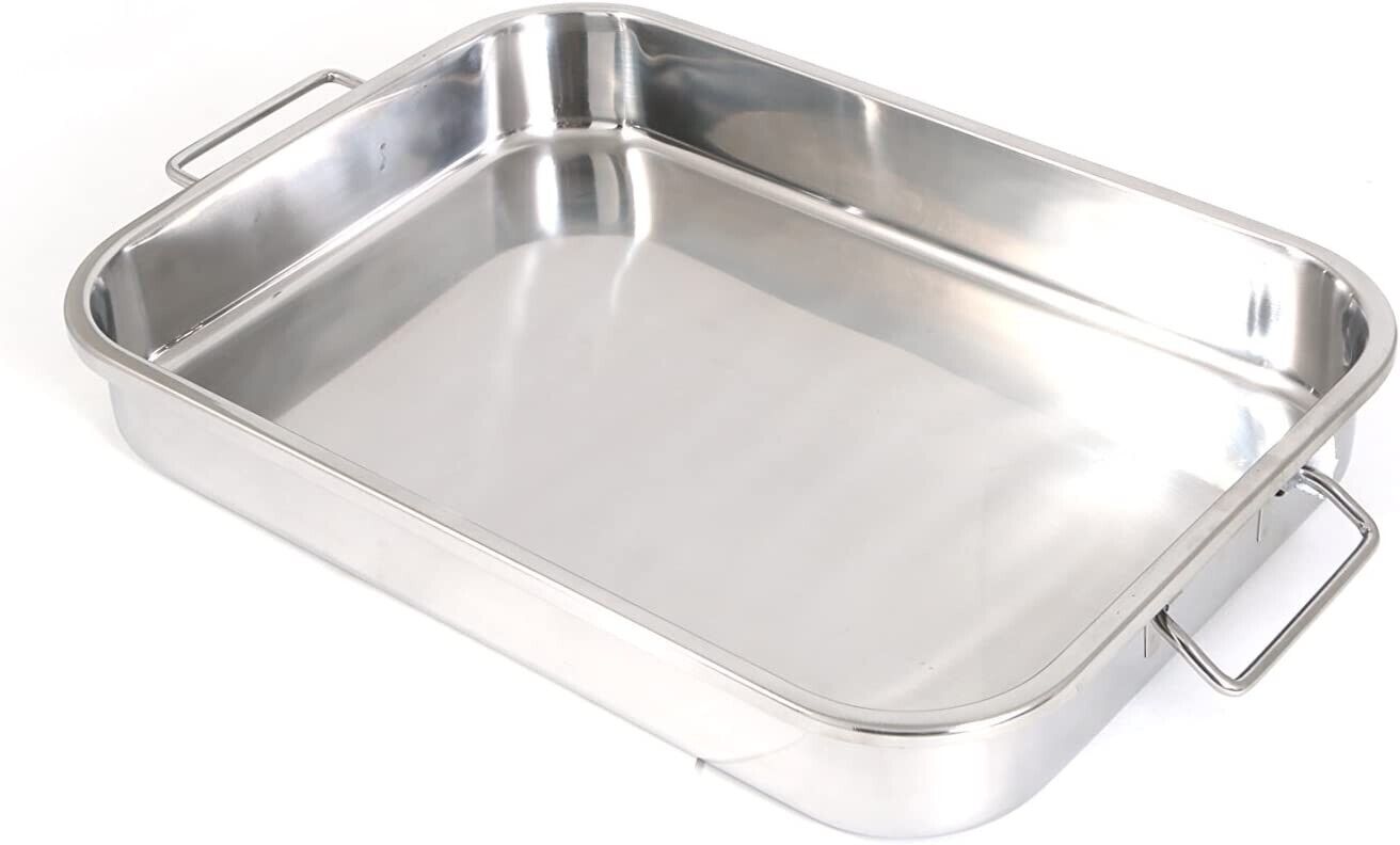

Have you looked into the "Broiler-pan" school of way way sturdy chassis? A hop down to one of those giant kitchen outlets...colors abound, & the ever present stainless steel.
-----------------------------------------------------------------------------------------------------------------------------------------------------------------------------------------Rick...
Ha, broiler pan. Looks good, don't temp me. I had my sights on a 1U x 10" x 10-12" typical rackmount chassis because I could fit it with other 19" rackmount fx units. Figured it would be nice to just have them all together and in close proximity for hookup and interface. Of course, it won't be the most agile thing to haul around but, I'm willing to make that concession.
I do like the broiler pan idea though, could imagine building a 2-channel tube Hi Fi amp for the kitchen with that. And I 'm not being facetious. For a while now its been something I've thought about - a nice castle of transformers and hot tube sitting at the other end of the kitchen table with a couple of nice 2-ways hanging on the walls, (or on a couple of stands). I think the broiler pan would be a perfect mounting fixture structurally and aesthetically.
