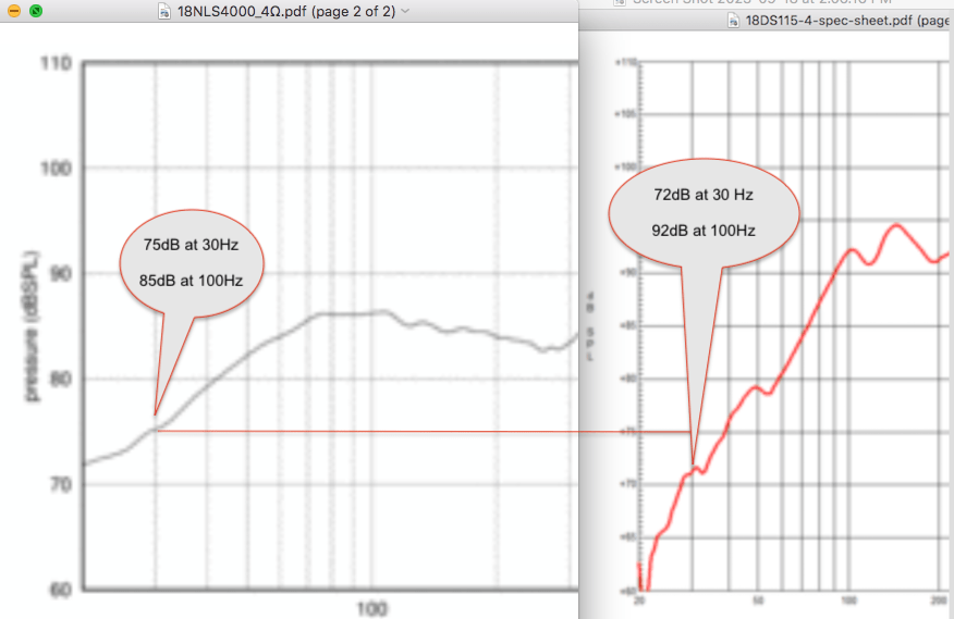

A "one number" sensitivity number for a subwoofer rating is pretty useless, the 18NLS4000 is 75dB at 30 Hz, 85 dB at 100Hz, while the 18DS115 is 72dB at 30 Hz, 92 dB at 100Hz.
The Xvar (70% of Bl) specification is not useless, the 18NLS4000 has 25mm compared to the 18DS115 at 14mm excursion.
The 18NLS4000 is capable of far more output in the excursion limited 30 Hz range, the 18DS115 more output in the thermally limited upper sub range, different horses for kicking different assets
