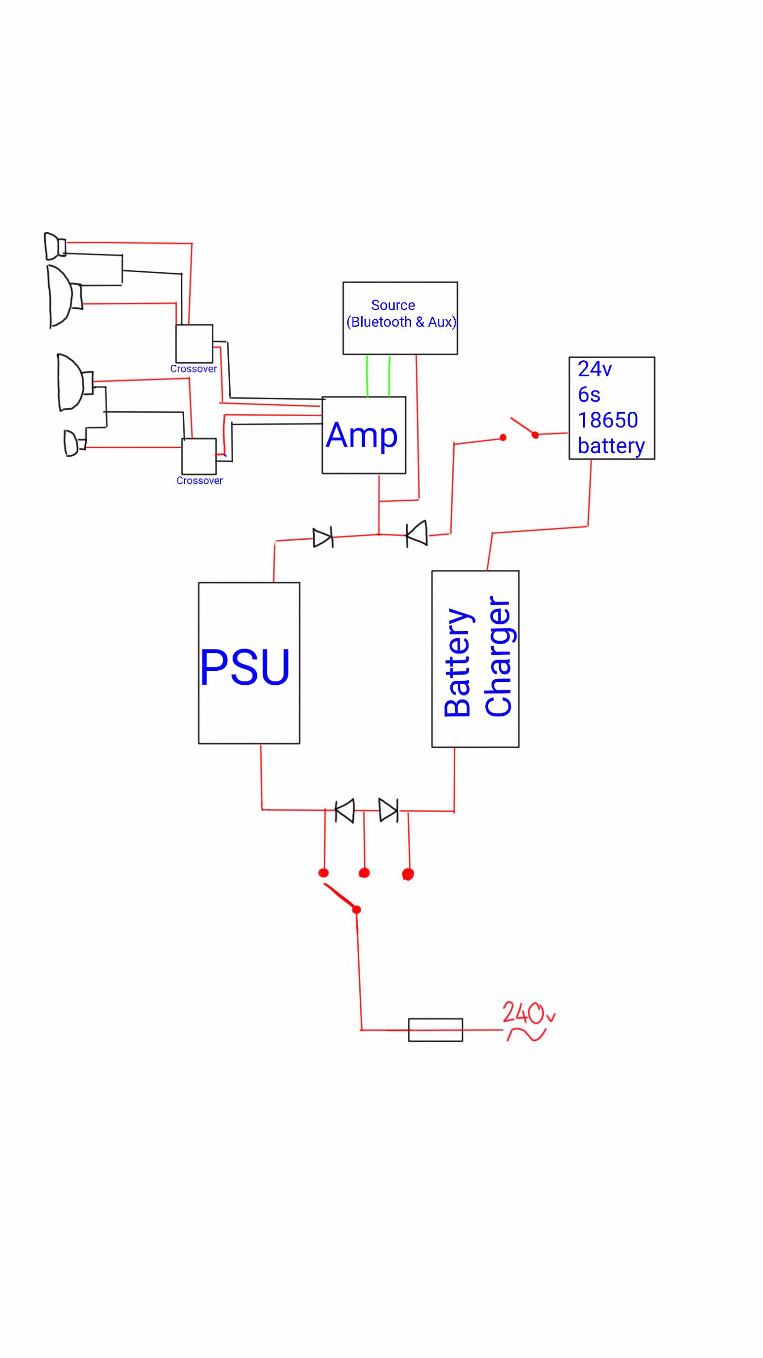

Also can anyone please look at my schematic and advise me if it will work or not. Thanks

your AC input scheme with the diodes isn't sound.
BTW you don't need the manual switch with the output diodes, if you can adjust either voltage to back bias the unwanted diode. Think of it as automatic switching when the battery V drops below a certain threshold.

Could you do me a huge favor and change what needs to be changed.
Also thats where I was going to get the 18650s from I was going to https://m.fasttech.com/products/1420/10002357/3935802-authentic-samsung-inr-18650-30q-3-6v-3000mah
What do you think?
