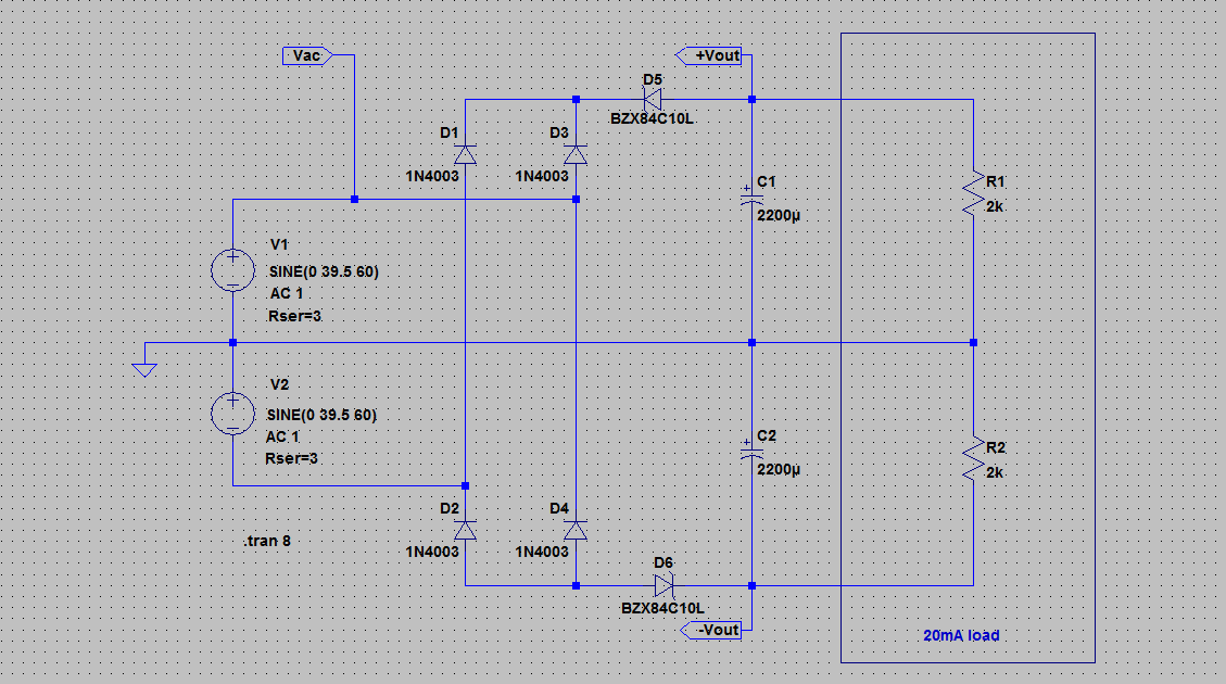

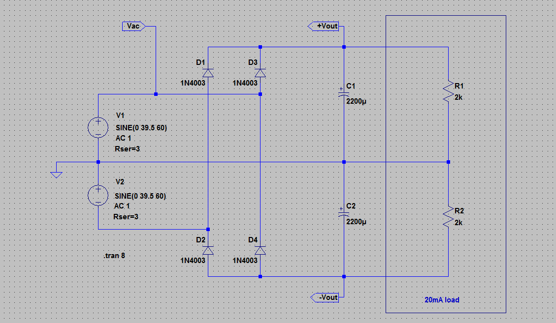

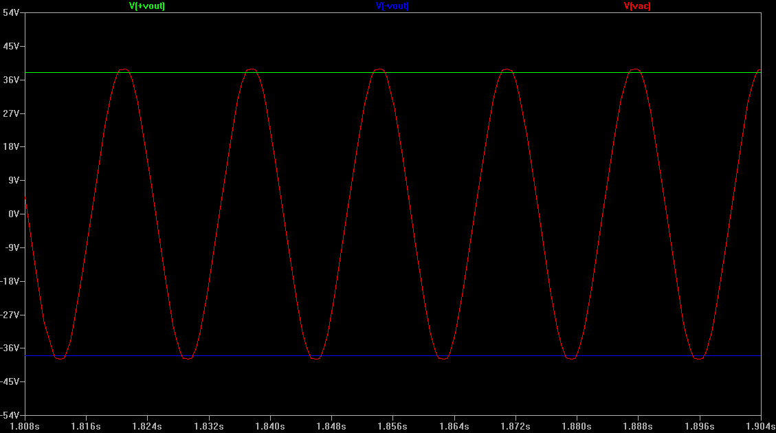

If you feed the +/-28VAC into the +/-15VAC terminal block on your board, here is what happens - pictures and plots below. The LM317/337 regulators on your board are good for an absolute maximum of 40VDC input, a bit more than the 7815/7915. The first plot shows that you get about 38V out of the rectifiers on your board into the regulators. If you change the caps to 50V, like sofaspud says, seems like it would be OK.
However you want to stay a few volts below that 40VDC max as good practice and the incoming AC line voltage can vary +/-10%. If it varies in the "up" direction during a lightly loaded condition the second plot shows what happens. Now you are up to 43VDC and the regulator chips are not happy. 🙂
If it were me I would add 10V 5W zener diodes after the rectifiers, like this one
Digi-Key - 1N5347BGOS-ND (Manufacturer - 1N5347BG)

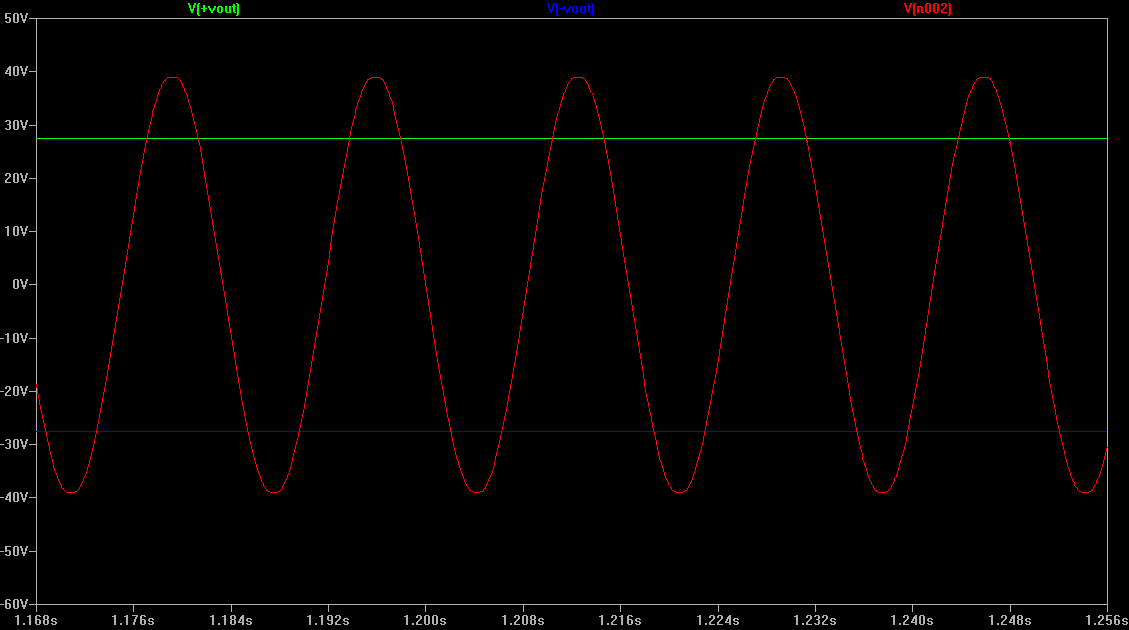

to knock the incoming DC voltage down by 10VDC. The second circuit and plot below shows what you get. The output voltage is now 28VDC nominal, as shown, or 33V max with a 10% line voltage fluctuation. With the change you would be OK with the existing 35V electrolytic capacitors. At 200mA that would only be 10VDC * 0.2A = 2W in the 5W zeners so they are happy too (I wouldn't recommend using a 2W zener, stay with 5W). Note that 10V zener part number on the simulation isn't the right wattage - just what I had in the database - sims don't care about smoke. 🙂
To add the zeners you would have to do a bit of "skywiring". Study my circuit diagram below and de-solder and pull out the two ends of the diodes that have the cathodes connected together. solder them together in the air along with the cathode of a zener. Then run the anode of that zener back into one of the holes where the diode leads went and solder. Then repeat for the other two diodes that have the anodes connected together. Pull out the anodes, solder them to together with the anode of a second 10V zener, then stuff the cathode of that zener into one of those two holes and solder.
The 317/337 regulators are good for 50 degrees C per watt with no heatsink, from the datasheet. With a max of 33V (with the two 10V zeners added) in and 200mA current draw max (a guess) that gives (33V - 15V) * 0.2A = 3.6W. That would be 3.6W * 50C/W = 540C, but most junctions max out around 150C. So you definitely need a heatsink. But like sofaspud said you may be able to slip one inbetween the two regulators if you use insulators.
This is incorrect.
LM317/337 are good for Vin-Vout<40VDC. In other words, the maximum input voltage is 40VDC greater than the output voltage. You can actually use them in high voltage supplies because of this (100+V, for example). They will have absolutely no trouble here, and are far lower in noise than LM78xx/79xx regulators.
True, they are floating regulators, but the problem comes at the instant of startup when the output caps are discharged, and also in the event of an output short. Then you are back to more than 40V across the regulators. Some extra work has to be done to protect against that. Good writeup here:
http://www.national.com/an/LB/LB-47.pdf
Edit: I should add - I would use the zeners, but that is just me. BrianDonegan is 100% correct that the regulators could be used as is, no zeners, and should work just fine. I've seen a lot of circuits >40V built up that way with the regulators floating and no added protection circuitry. So take your pick. 🙂

I'll run the 28v directly in using the 10v/5W zeners for the added protection... Am I correct in thinking that with the zeners in place, the 35v caps are sufficient?
