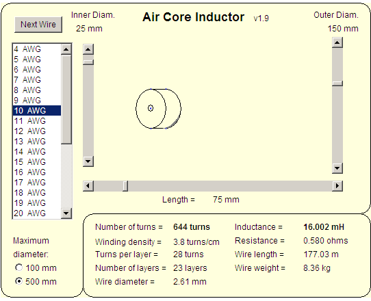

I am working on a project at the moment the would require a crossover at around 150-160hz, I am using a pair of Lowther DX3's in a small closed box and a pair of GPA 416-8A's in a ported design. individually both speakers sound great and it now an issue of crossing over.
I need to know what are the main issues with crossing over passively in this range?

For the frequency chosen a passive crossover is not a good option unless you are prepared to use massive air cored coils and capacitors that may well exceed the cost of an active system. A minimal series first order network ,8 Ohm_150 Hz would need a capacitor of 132.3 MFd and an inductor of 8.5mH.If it is intended that the xover is only for temporary use then an ironcore coil and a bi-polar electrolytic may prove adequate,initially.
If you decide to go 2nd order the inductor size jumps up to 16mH (for a text book 8 ohms)!! To give an idea just how big this would be with reasonable (still high) DCR have a look at the attachment!
You could try Jantzen Pcore coils, I've not used them, but they are supposed to be better behaved than standard cored coils, and are much smaller for the inductance/DCR than air cored. But I agree active is a better alternative at this low a frequency.
