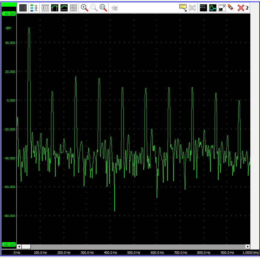

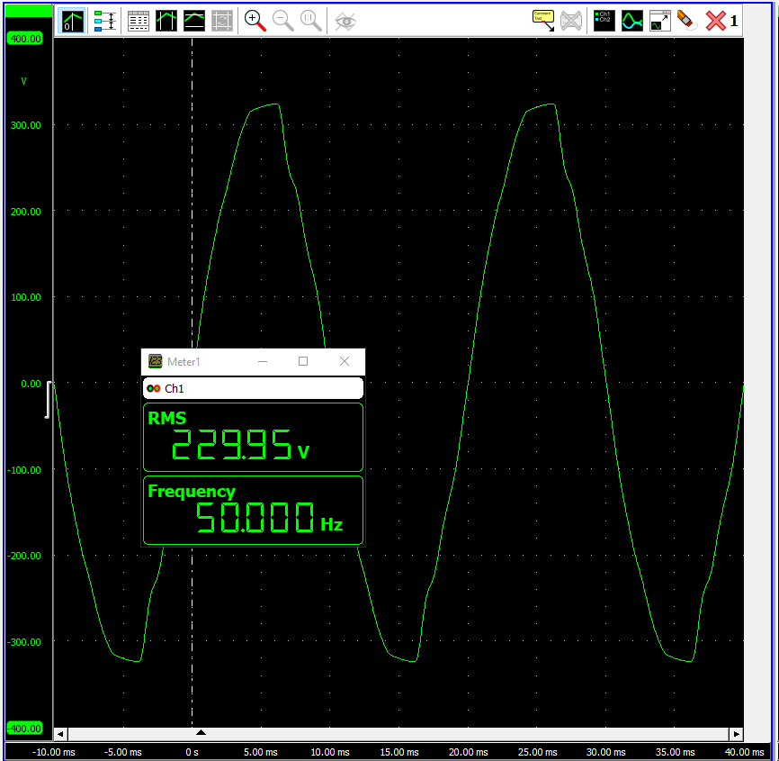

Typical? Do you have three phase rectification?
No, why? 3rd of 50Hz? 5th at 250Hz, 7th at 350Hz? Surely you have seen that many times?
You can also see it at the primary side due to the 'cut off' top on the primary due to rectifier diodes opening up.
All just as predicted.
But mainly my point was that it is MUCH easier to troubleshoot if you have an idea WHERE the problem is. Try to 'box it in' as it were.
Jan
