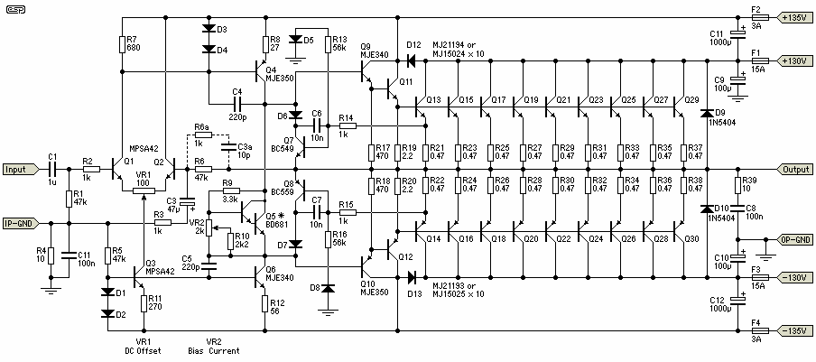

Good day to all! Any body here has built this amp from ESP Project 117? I am interested with this amp. I want to know if there are design stuff to be added or to be modified. Please share some experiences during building this amp. Please refer to attached file. Thank you.

That amp is intentionally left incomplete so incompetent amp builders wouldn't kill themselves or start fires trying to build it. With a few minor modifications it can be made to work. Q3 and Q6 require base stoppers, and C3a needs to connect from - input to the collector of Q6 (not output node, there is too much phase shift in the output stage). C4 needs to be set by experiment. A few other things are needed to make it sound as good as it can. If you don't know *why*, or don't know what I'm talking about then you don't really need to be working on anything this big yet.

The amp posted by djk has no power supply circuit. Would it be the same with the qsc supply- no large value filter capacitor? Can you give me some insights why those amp doesn't need a filter cap? What about voltage regulations? the ripples in the supply isn't a problem?

djk's circuit *is* the QSC amp - with some minor revisions. They do require big filter caps - the series connected pair is BOTH the filter and output coupling caps. They serve both functions simultaneously. At small signal, they're inside the feedback loop and don't affect bass response, but the bigger they are the better power you'll get at clip at 20 Hz.
The one catch with this circuit is that the power supply is FLOATING. You need one for each channel, although commonly it's a separate winding on the same transformer core.

If you really, really need this sort of output power, buy a Class D based power amplifier used for PA/stage work. It will be cheaper to buy than build, and to build any Class AB amp for this power level will be dangerous, and generate more heat than you could deal with.

A decent class H PA amplifier still costs around $1000. Class D more than that. And if you want to run 2 ohms in 95 degree weather in full sun you need to buy two. If you're actually up to the challenge of working with dangerous voltages and curents, and are any good at scavenging expensive hardware you *can* build one built like the proverbial brick s-- house for less. Any amp is more expensive to build if you go pay full distributor price for even half the parts. Anyone seriously considering building a multi-kW amp probably already has the transformer(s), heat sinks and caps or can get them cheap. If not, sticker shock would have already discouraged the idea.

If you actually want a working amp, don't even think about the ESP design.
What I would so would be to build the Super Leach and go from two output sets per side to six output sets per side. With the proper transistors and a couple of other minor changes it will run from ±135V.
The difference of why this amp will work, and the ESP will not work is the series connected output stage.

pls can someone assist me in the biasing of this circuit coz tome its working but does the mpsa 42 and mje340,350 on the biase side have to overheat any assistance willbe appreciated

there are 2 different cct of p117 one has 680ohms resistorwhile the other has 2.2 kohms on the bd681 transitor pls help for a genuine one
