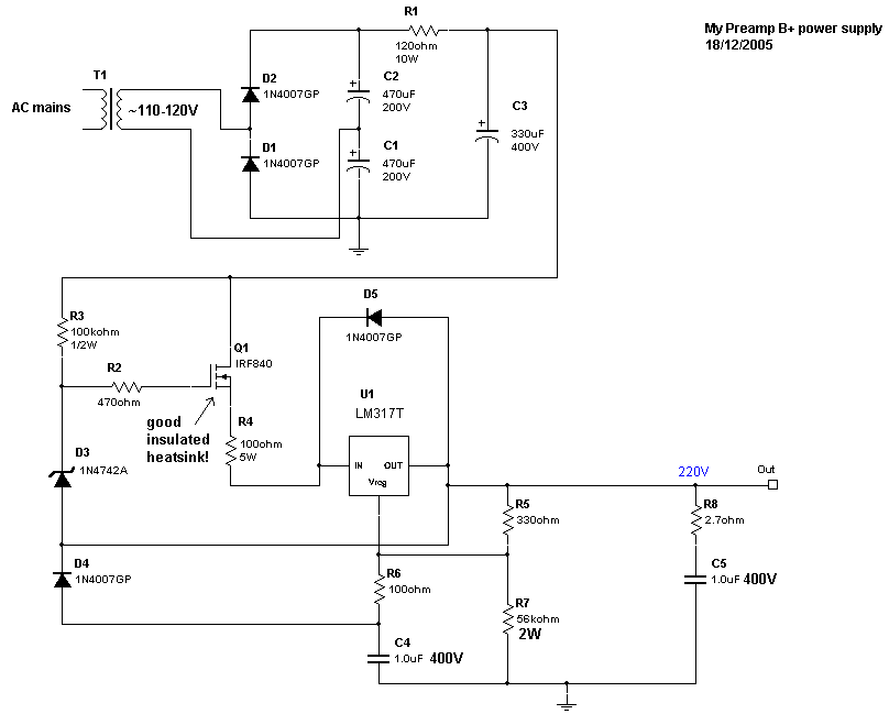

Hi Greg,
I'm not an expert so I don't know what's a c4s but a single 500v winding without center tap it's way too high for this purpose.
Bare in mind that after rectification you'll get something around 500X1.4 volts.I see on the transformer's specs that some pins are shorted I can not find out if you can do something with them.
Anyway I'll tell you what I use in my 12b4 pre.
Transformer is 225 v primary with 250-0-250 secondary @ 200ma
and a separate one with 15v @ 2a for the heaters.
High tension rectified through a pair of UF4007 followed by a simple CRC (220uf-120ohm-220uf) followed by the attached trimmed to give 255v.
2x10 k/5w in parallel on the plate and 500 ohm on the cathode bypassed with a good quality 470uf/25v cap paralled with a 0.22 uf good quality cap.The sound is something else believe me.
Michael

Hey guys thanks for your prompt reply.
The optimal B+ voltages with the C4S (type of CCS) is 300VDC. The Ripple needed should be very low due to the microphonic nature of the 12B4. The Lundahl can be used as a center-tapped 250-0-250 however they recommend using the 500v due to the double C core windings. The 4 6.6v windings I think can be configured to 2 12v supplies.
Thank you for your help
Greg
This is the max B+ above which the transistors will go up in smoke. I'd shoot for slightly less than 300 max without any load, and more like 250V or less with a load.
The CCS will effectively block all of the ripple, so getting it low is not that important. This is, after all, half the point of the CCS.
Using it as 250-0-250 is much better here. I'd use a tube rectifier (probably an EZ80 or EZ81 since you have 6V windings) to drop a few volts. Then, use a basic CLCRC filter, or a CRCRC. For the first C, keep it low, like 5uF to keep voltage down. For the next two C's, anything from 100uF to 220uF is fine. The bigger, the more ripple you'll get rid of. The choke can be just about anything. I simmed with a 9H and 5H, and both seemed fine. The resistor, again, can be just about anything. I ran a sim with a 220R as that was what the software used and up to 500R. The point here is that with the CCS the PS is not that important.
So, with EZ80 -> 5uF -> 9H (100R) -> 220uF -> 500R -> 220uF @ 40mA, I got a nice ~275V with 0.0005V of ripple, which is way overkill.
