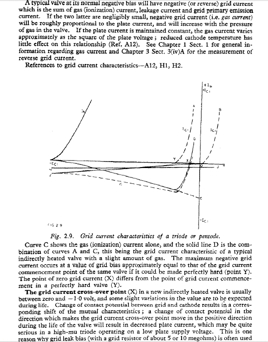

Dave, may I add to your comment, that some tubes start grid current in the negative voltage?. Also, all high µ triodes and most high gm pentodes are critical in which biasing respect. Not only the 12AX7 , as µ is the ratio between δEb/δEg, there is a small range of values in which it is effectively biased at class A amplifier, as a difference with medium or low µ.

(Look at this page extracted from Langford-Smith "Radiotron's" book, chapter 2, page 19).

Yes, I said:Osvaldo de Banfield said:Dave, may I add to your comment, that some tubes start grid current in the negative voltage?
Sorry if that was not clear. Grid current starts at negative voltages, especially for high gain valves. Worse, high gain valves then cutoff at only slightly more negative grid voltages.DF96 said:Grid current can occur if the grid gets more positive than about -1V with respect to the cathode - although this varies from sample to sample
