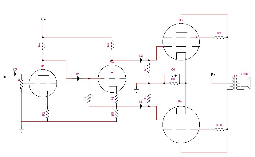

I am wanting to start building my first valve amp. As a first project I would like something around the 20watt mark, and do it cheap! I have found this website that uses a 100volt impedance matching transformer as the output tran. http://www.alphalink.com.au/~cambie/6AN8amp/Grant_Wills_6CM5amp.htm
I would like to do something similar but I want to use valves that I have avaliable from local electronics shops. As stated in the website the transformer is 8k:8ohm.The valves I have avaliable are 12AX7, EL34 and 6L6. I assume the design would be PP. So if you have a design for such an amp please post it!

Somrthing like this?
I just whipped this up as an example of a super simple circuit. It uses a concertina (split-load) driver with 1 gain stage before it, and runs the 6L6's in cathode bias/triode connection...simplest design I could thing of in the push-pull realm. You could use a 12ax7 as the driver/splitter, but the output impedance would be a bit high, a 12au7 would be a bit better, but either will function.

I will be using it for home stereo. A pre amp is not 100% nessary, but if there is a simple all in one solution then great. I can buy a vavle preamp as a kit from a local electronics store so I could go that route for the preamp.
Thanks for making that schematic! Since I am new to valves and their design do you have component values?

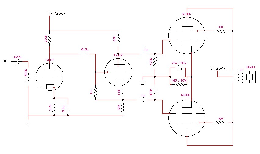

Try this out
Hey man,
I ran a little math and here is what I came up with. It uses no gobal feedback, otherwise the specs would chance. There is some local feedback in the form of the first stage cathode resistor...and I suppose you could add some high value resistors from the plates to the grids of the output tubes for some local feedback there is you want, but I wouldn't worry about that right now.
The potentiometer at the input WILL alter your input freq response as it is turned down, so either take it out and replace it with a fixed resistor if youe source has an output control, OR experiment with the input DC blocking cap value until you like the sound...or take out the cap and lower the value of the input pot...but that will change the gain of that stage...just stuff you can try.
You will probably want to put some grid resistors on he output tubes...I forgot to draw those in...just to be safe if the tubes start drawing crazy current. 1K should be cool. Just run them from the 470K resistors to the input grids instead of connecting them directly.
ALSO, I just did the load lines real quick for the output tube cathode bias resistor...i think it is cool, but you might want to check around or do the math yourself. You can err higher if you want to play it safe, take the mesurements when it is built and adjust accordingly.

Thanks alot for your help! With the volume control, why is it that varying the pot changes the freq responce?? What if I replaced that with a fixed value and added a 50k pot before the input? I might try for a bit more of a refined power supply. What sort of wattage would you expect for this thing to put out?? Hopefully once I get my 35mm projector back together and off my desk I can start on this amp!

Up to now nobody seems to have replied to your post#8, so let me try to help (I will explain simply and fully so this will be a little long.)
Firstly, the high frequency response will suffer with any appreciable input resistance. The main culprit is what we call Miller capacitance that is shunting your input. The highest input resistance with a 500K pot will be when the rotor is in the middle (resistance-wise). There you will have 250K to common in parallel with another 250K up top, also essentially in parallel with the first 250K, if the input source impedance is considered negligible for now. That brings us to 125K.
The main contributor to input capacitance is the 1.7 pF between anode and grid. This sounds low, but this capacitance is not to common, but to the anode, which for every volt across it from the grid side, has about 70V in the opposite direction on the other side from the anode (the amplification of the first tube will be about 70). The effect of this is that the grid "sees" an equivalent capacitor of 71 x 1.7 = 120pF. When this appears after the above 125K resistance, you will have a 3dB attenuation at 10KHz. If your source impedance is significant, this will be lower. There is also other internal capacitances acting here which I have ignored for simplicity sake.
You can now work out that at either end of the pot, the nett series resistance will be less and the frequency cut-off higher. Thus you will have worst attenuation of treble with the pot in the middle (resistance wise).
As an aside, this is why I am not fond of the high mu ECC83 as an input tube unless one can guarantee a low source impedance - and then not with a volume control in the way! Your best solution here is to use a 100K volume control if your input source is not shunted too much by that.
The expected output power will be about 8W into 8K transformer primary impedance. With only 250V applied the 6L6s are rather wasted. Once you get this to work, you can increase that to 450 - 500V with about 300 ohm common cathode resistor (10W). That should increase available output power to about 14W, depending on the output transformer.
Using the distributed load (UL) configuration can convert this circuit to give about 40W - a worth-while increase (at 450V h.t.). I must respectfully disagree with Amperex about the non-linearity - that is not what I have found or what my data shows (I have graphs from G.E.). UL allows one to mainatin about 80% of the advantages of triodes (low internal impedance and low distortion) but with about pentode output power. But perhaps that is for another day, if you want to start with the circuit as is.

Thanks for your replies! Johan Potgieter, thanks for the great explination. I might increase the 250volts, since I have a schematic for a power supply using 2 off the shelf transformers conected back to back. They are both 160VA, with the first supplying 25VAC to the 30VAC center taped secondary winding of the second transfomer. At full load that will produce 150VAC which feeds a voltage double cct. This produces +480V. Or is there an easier way? If I could increase it to 14watts approx to start off with thats about what I am after. If all goes well then I will want to to increase the power to 40watts as sujested and possibly make my home theatre setup run of these.

Yah. . . . know the feeling. I am at present in the last stages of finishing a 120W amp using a nett 520V anode and 460V screen voltage (4 x 6L6GC in the Quad II type output stage). Having become used to transistors I approach carefully - hope no smoke and "spitzensparken". Folks may have noticed that I was looking for extra genuine GE - 6L6GCs on another thread; if unavailable (as it is beginning to look) I will be going to Svetlana or ...EH - then my turn to be nervous.
So what do I need to modify if I want to increase the B+ volatge? Can I still use 12AX7's and a volatge of around 400volts? I ask this becuase the specs for a 12ax7 say a max plate voltage of 300volts? Or would a resisitor be used for their plates to drop the volatge? I am new to valve amps and their designs so bare with me, I am still doing reading on the subject. Thanks for all the help up to now!
Firstly you can certainly use the ECC..s with a supply of 450V (seems to be a popular voltage for this sort of thing, probably because that is a popular rating for high voltage electrolytic caps).
One manual I have gives absolute max. for ECC83 as 600V, operating as 330V. The max. voltage rating is somewhat coupled to the dissipation and other factors - it does not mean it will start sparking inside at 340V! The thing not to exceed is the maximum anode dissipation (apart from keeping the heater voltage within spec.).
Then also notice that voltage amp. stages are decoupled from the main supply by say 22K (and 16UF/450V cap), making the voltage there no more than about 350V - 380V. Then you still have the anode load resistors. This is a longer story, but one tries to put the final anode voltage where the maximum required sine wave will just fit in with say about 20V above the G1 = 0V curve on the anode voltage/anode current load line.
Sorry that this comes to you rather disjointed - at which circuit are we now - if it is post #3 by Aletheian, perhaps I can hook up a practical circuit in a day or 2 (if he does not come first) and give you ball park values.
