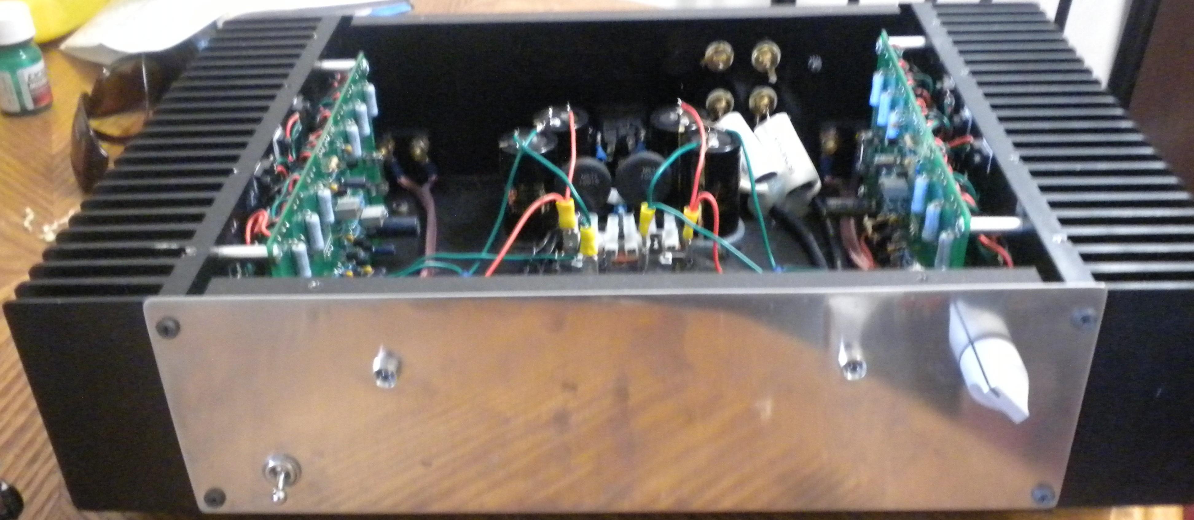

This is what I build and is realy easy.using Two led's
Lanchile, I like your project. Where did you get the LED's? Are they 120VAC.
Hearinspace, I bought the circuit board, TDK motorized pot, and learning remote. Somehow managed to solder it together, programmed the remote and it all works! I used a 9 volt battery but also considering:
* 4 AA batteries. Charge with a solar charger. Use an On-Off-On switch to go between off, charge circuit, and use circuit.
* 12 VDC Wall-wart.
* Umbilical from my Zamp to the pre-amp but Parasound doesn't like the 80mAh to run the motor and I can't read the schematic they sent for the Zamp.
Machining stuff is no problem. Just need the 120VAC LED's
