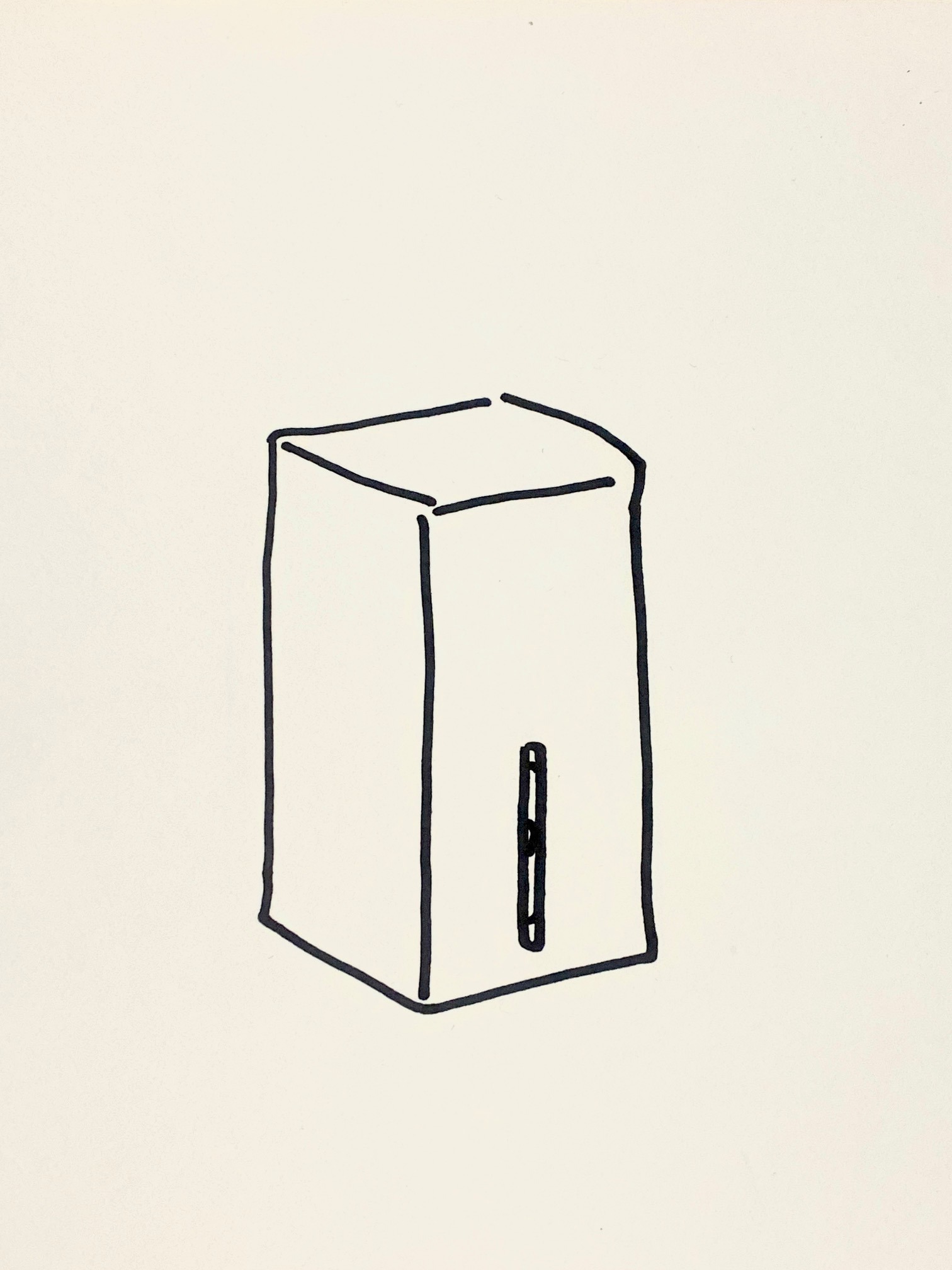

The driver could be mounted vertically in a slot if you don't want it visible.

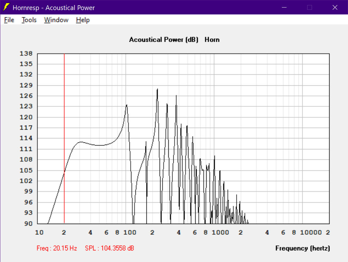

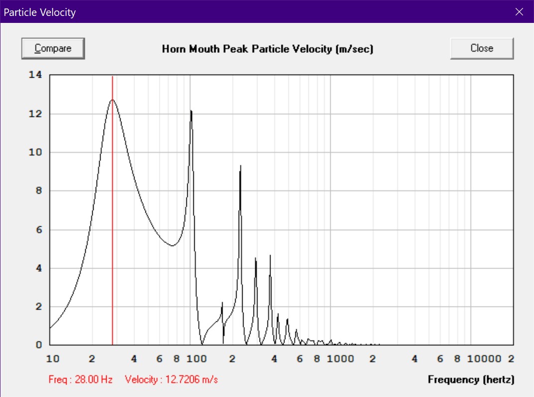

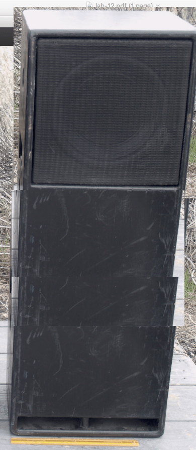

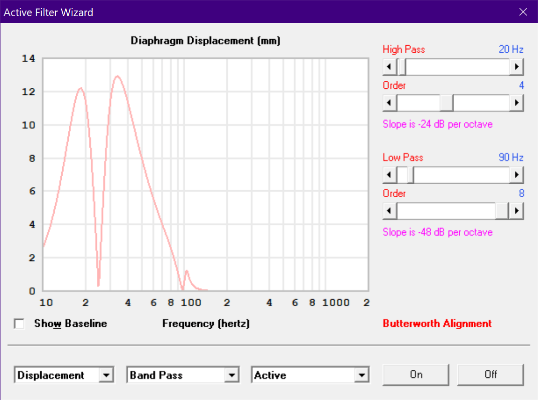

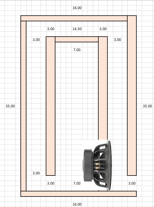

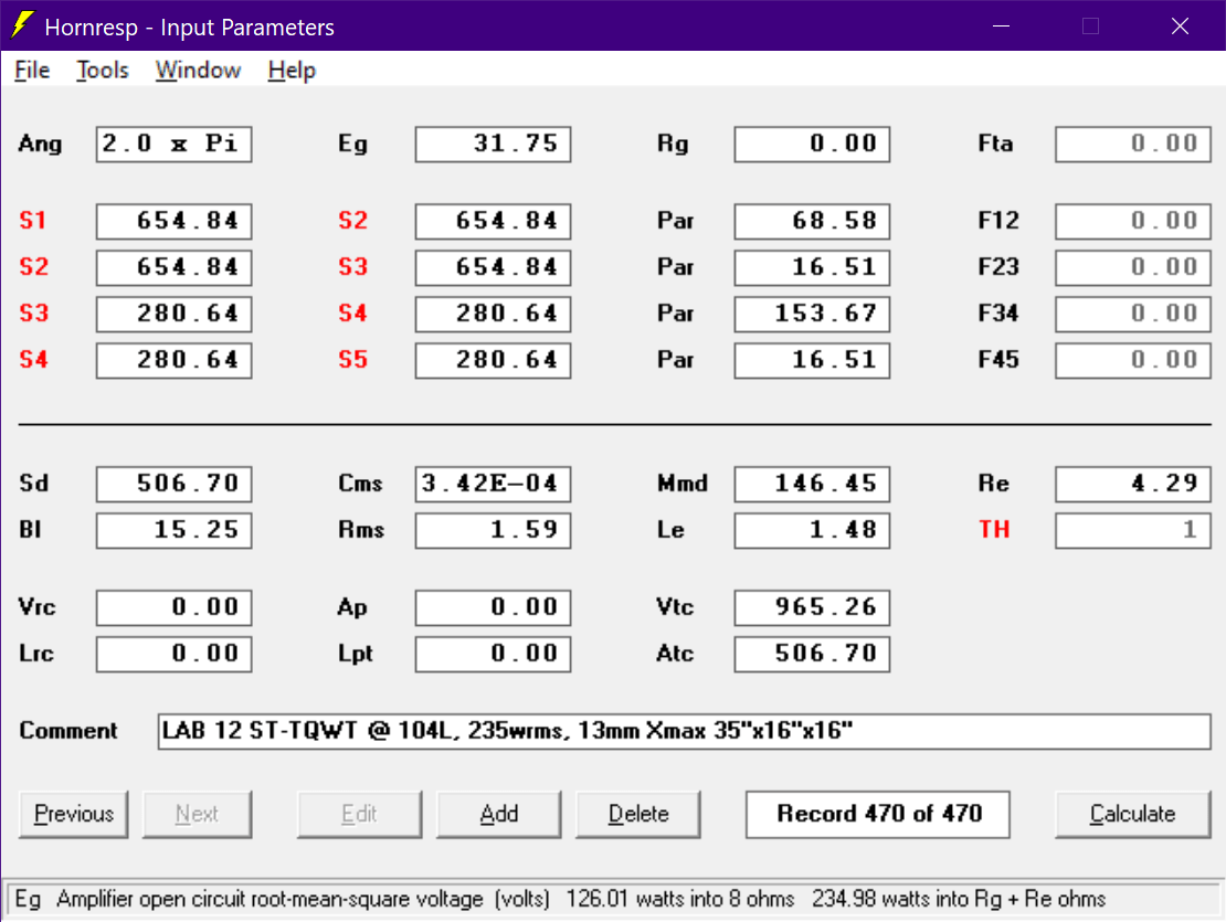

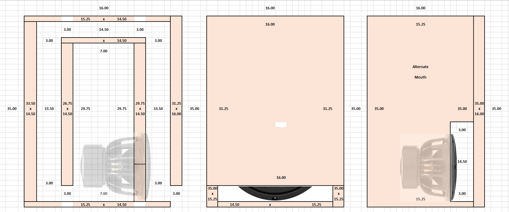

I need time to refine.

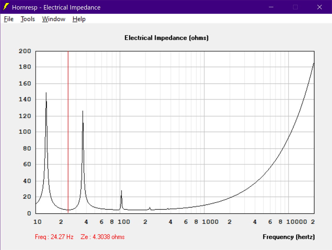

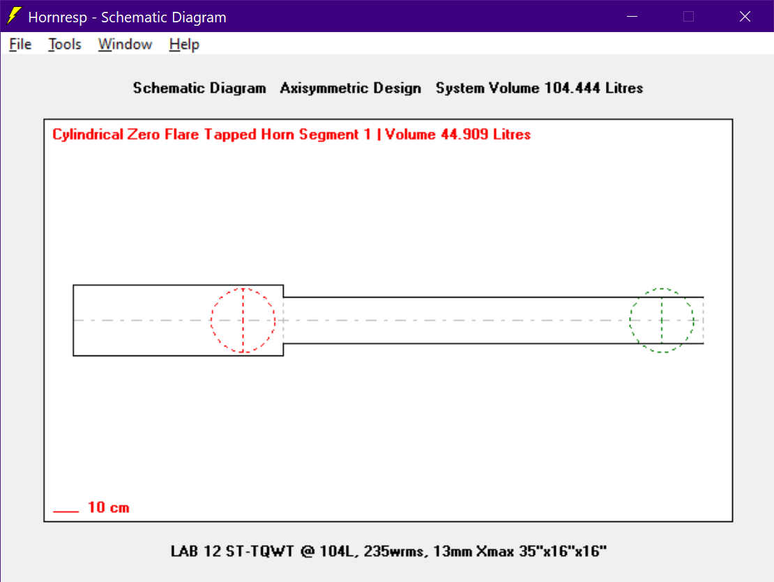

But, this is STEPPED negative flare tapped horn.
3 segments or chambers in the enclosure.
Chamber 1 = 33.5" high x 14.5" wide x 7" deep internal.
Chamber 2 = 33.5" high x 14.5" wide x 3" deep internal.
Chamber 3 = 33.5" high x 14.5" wide x 3" deep internal.

You suggest two options for the placement of the mouth, either on the front bottom horizontally or on the side vertically. Would it effect the output if I place a vertical mouth on the front baffle as in the drawing I posted?

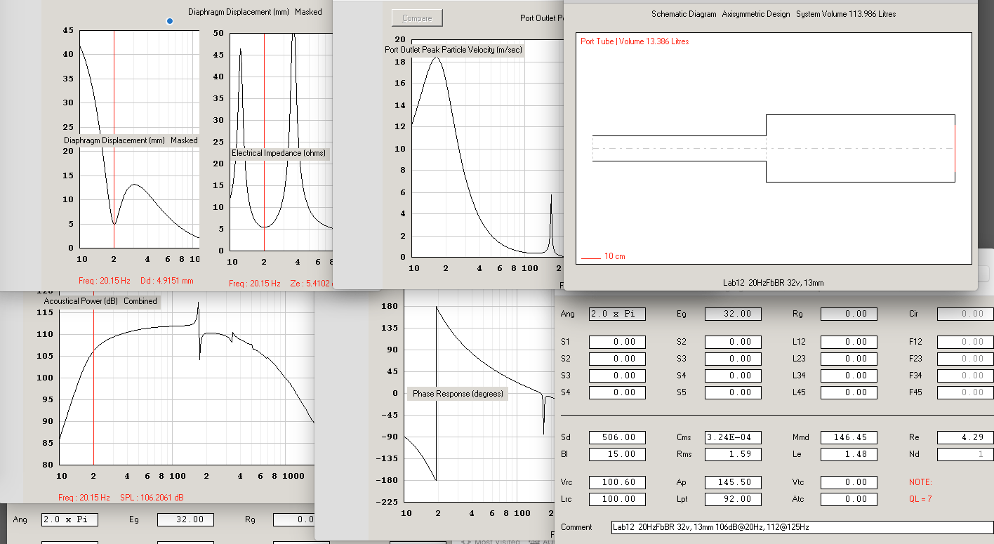

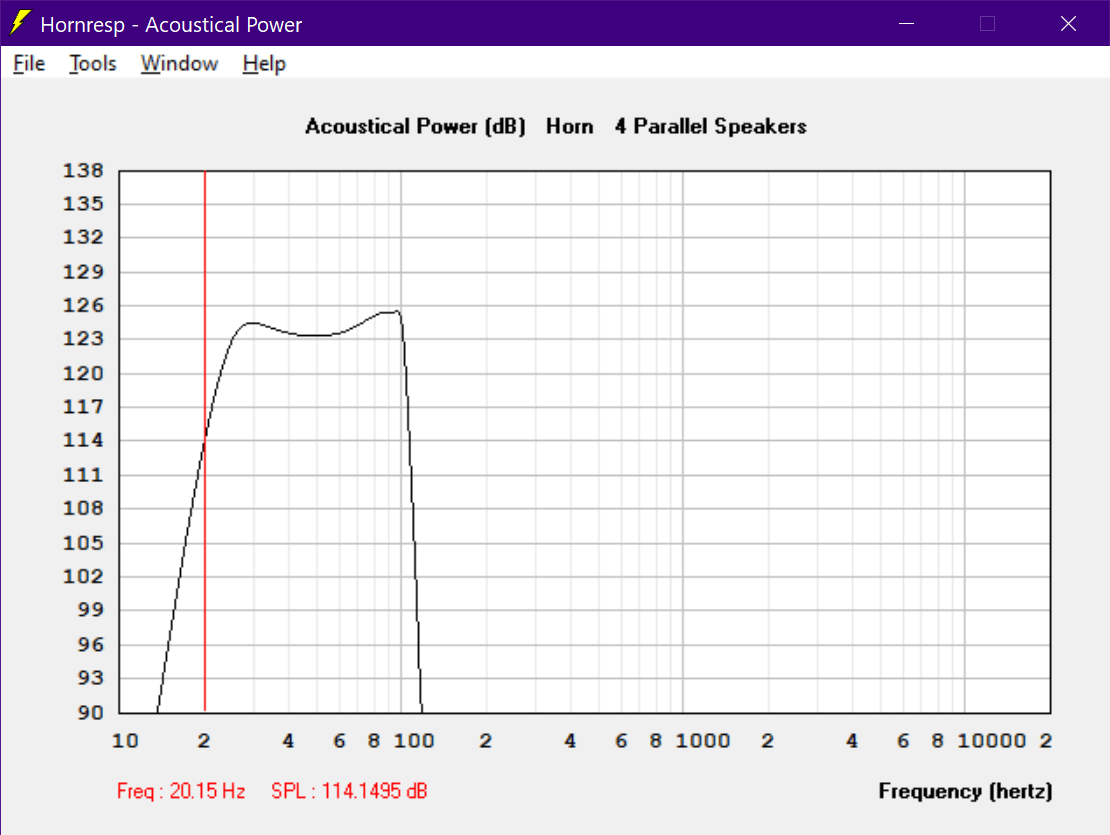

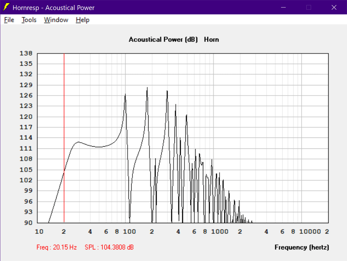

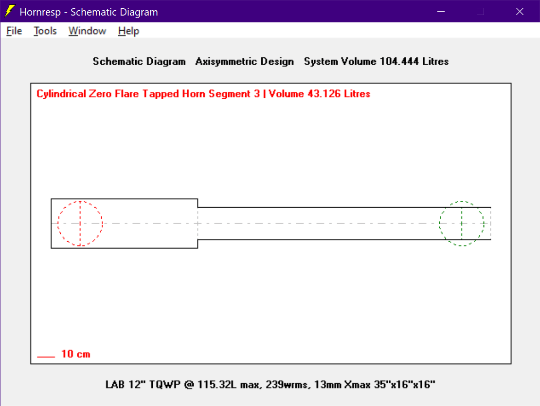

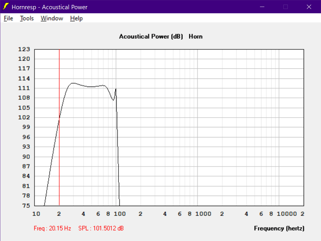

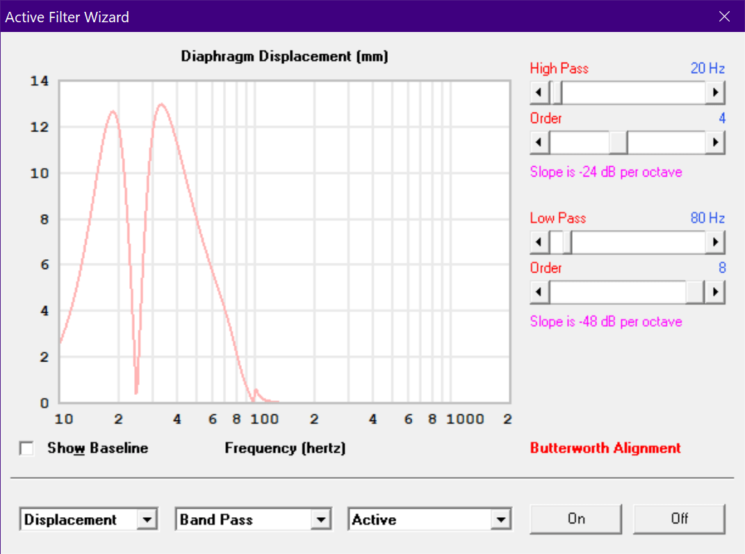

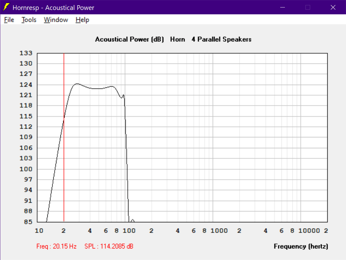

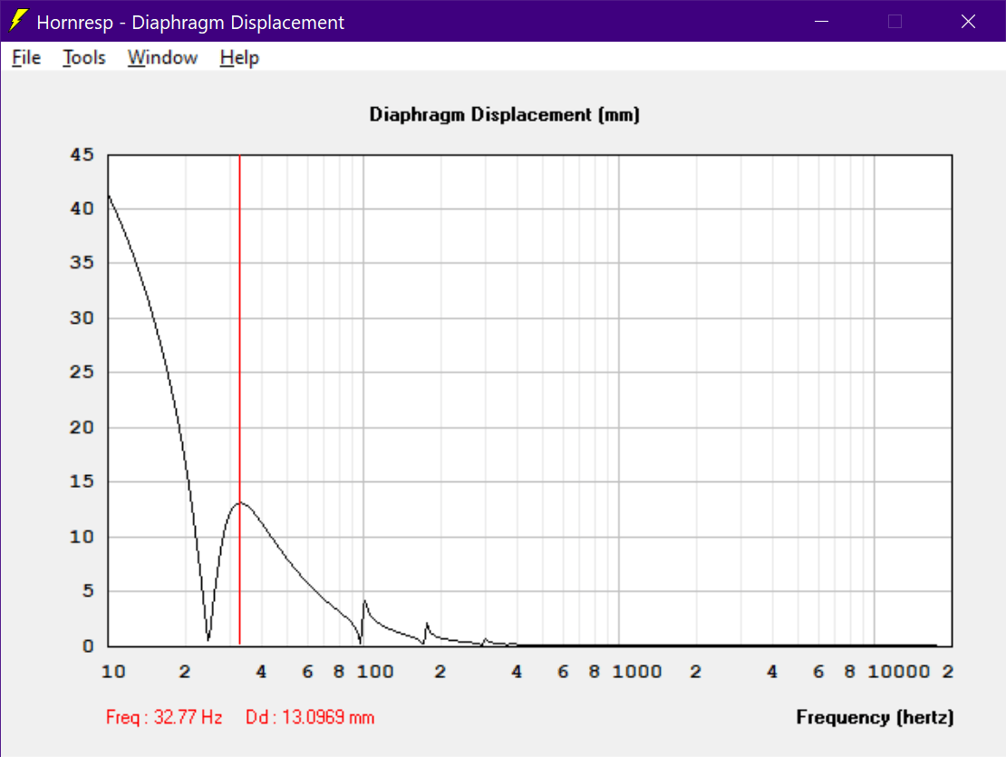

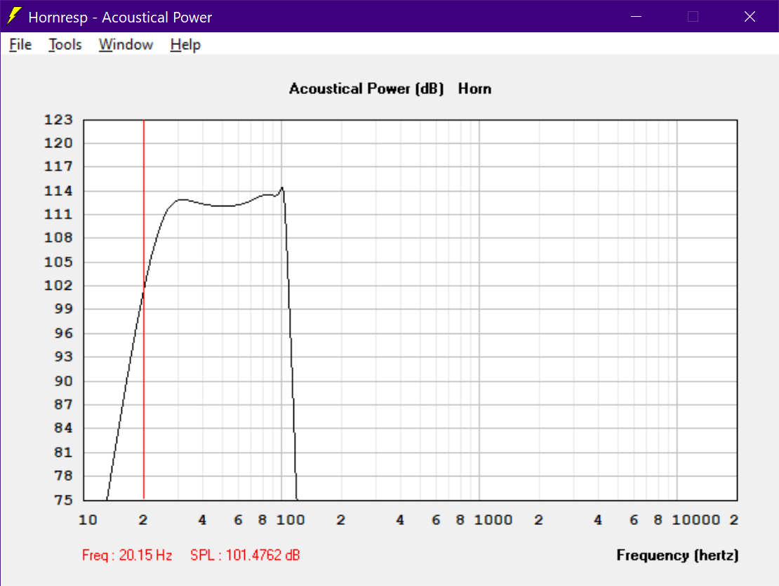

BP1Fanatic's 104L ST-TQWT is about -11dB down at 20Hz, about 1/4 as loud to your ears.
It is Xmaxed out at 101 dB, equal loudness to about 75dB SPL at 60Hz.
From my experience with different mouth exits on TH, I don't think a vertical exit compared to the horizontal would make much difference other than in the region of the 14dB peak around 100Hz. That peak won't actually be as sharp as the Hornresp sim shows, but may become a bit wider if the port is moved vertical.

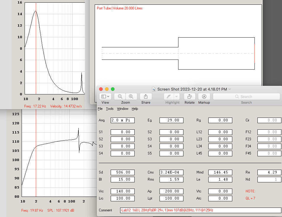

As a comparison, I ran a Hornresp sim of a standard bass reflex of about the same exterior volume, (114L compared to 104L, but fewer panels required inside).
It produces 106dB at 20Hz, about twice as loud using the same 32 volt input level, 190 watts at Fb. As the excursion is only 5mm at the 20Hz Fb, the response could be EQed flat to around 112dB level while still well within the LAB12's peak thermal capacity.
The port exit would be 22.5 square inches, 36" long, "L" shaped to fit the cabinet height you want.
As mentioned in post #2, the driver could be slot mounted vertically, though the sim does not show the effects of the slot, an upper peak and dip in the response.

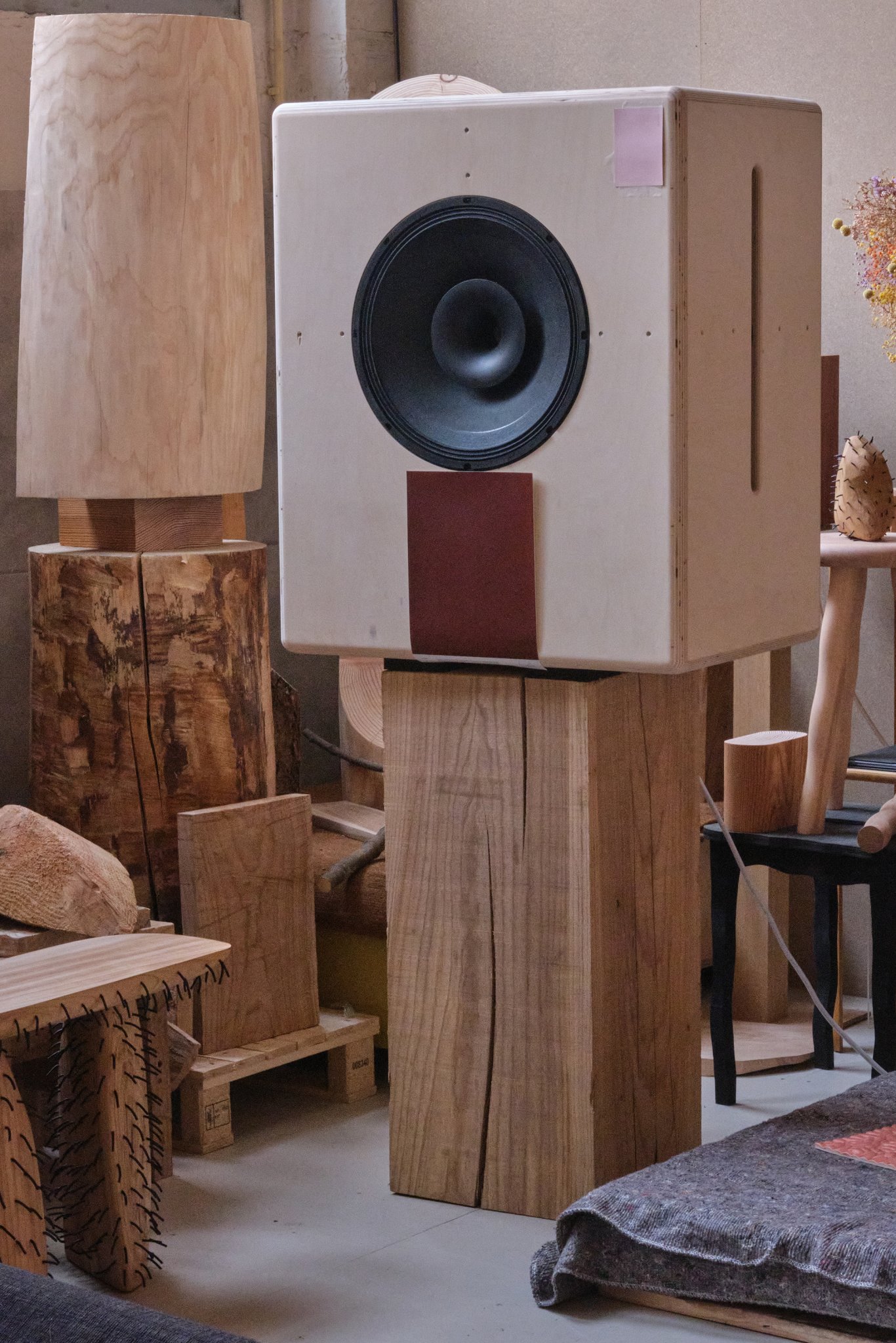

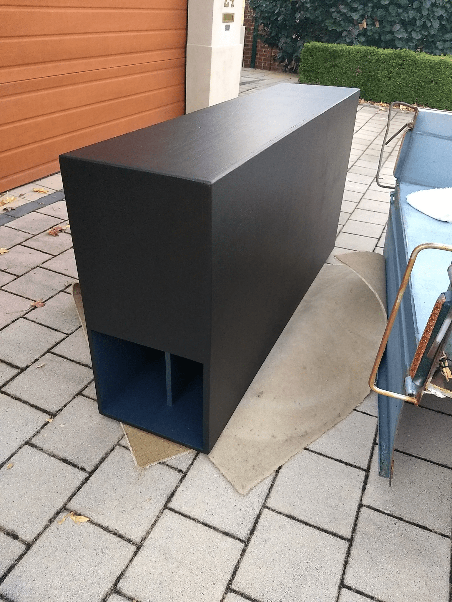

I'd probably put the driver at the top to minimize the distance between it and the co-ax, like this:
The cabinet the above composite photo was from did use a LAB 12, though a later iteration used a pair of slot loaded 10" .
In actual listening at Xmax or Fb, have not found the estimated port velocity of 18m/sec to be a problem with the port ends and "L" corner rounded over.
I also ran a 160liter cabinet, it is smoother and uses only 155 watts to do 107dB at 20Hz, though maxes out at about 108dB at 30Hz.
The smoother frequency and phase response through the crossover region with a BR will make alignment with the top cabinets easier than the TH. This is especially helpful when using a "loudness contour" response at low level listening, which effectively raises the acoustic crossover as much as an octave.

At 20Hz, a reduction of 5dB sounds around half as loud.

Probably not, but why alter the front panel with a vertical mouth when both enclosures have the same 16" wide by 16" deep dimensions?Thank you for the model! That is plenty of output down to 20Hz and within the size limitations. Super!
