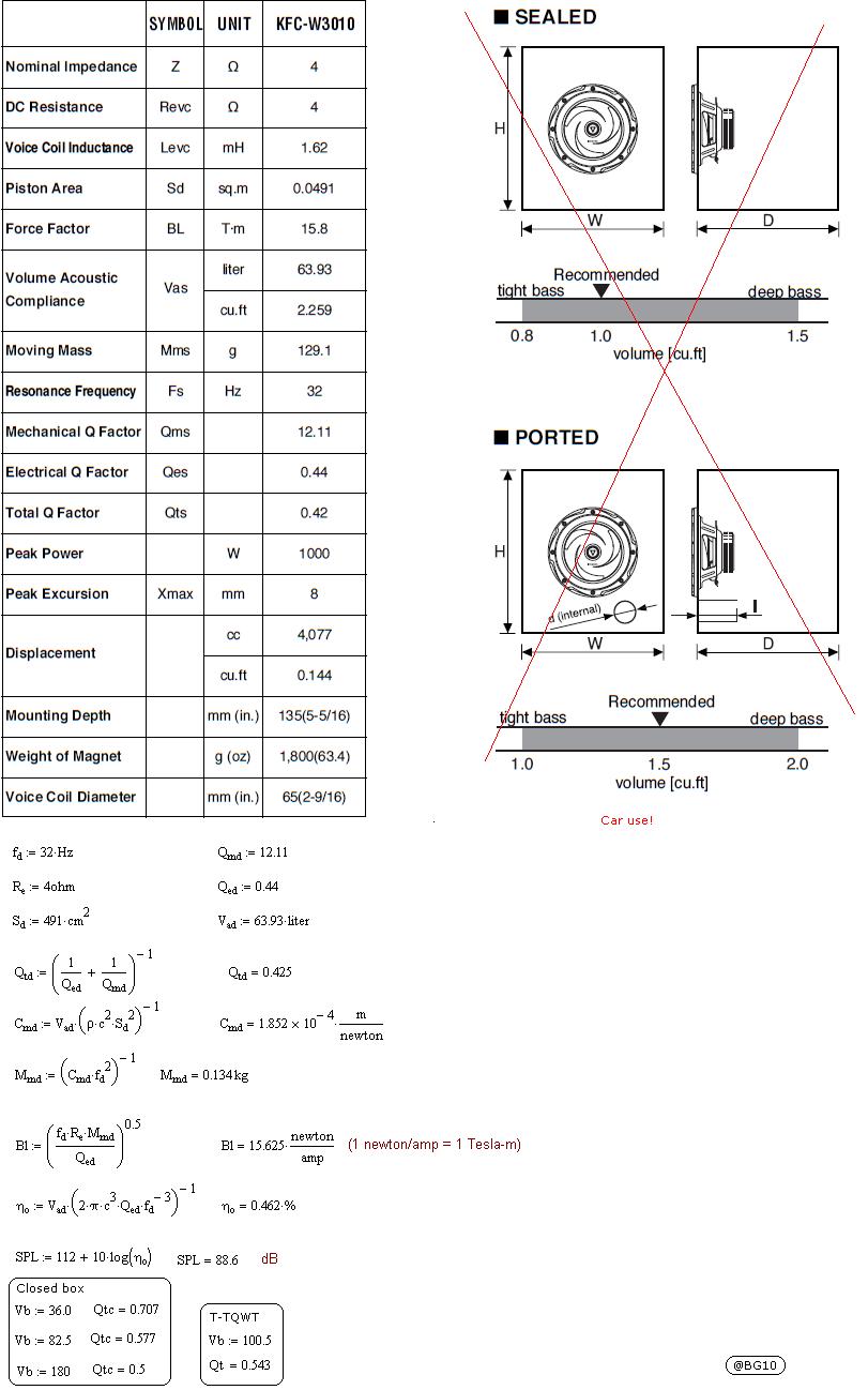

A ~flat response in-room is required, so it's a function of the room's Q summed with the cab's Q, ergo there's no set volume that defines it. A speaker setting on a large parking lot (half space loading) OTOH will need a Qtc (sealed) or Qtb (vented) = 0.707 or what's commonly referred to as a T/S max flat alignment.
From this we see that a < 0.707 Qt alignment is usually required in-room to keep it from sounding 'boomy'.
What are the driver's specs?

Thanks! As fate would have it, I Googled for it right after posting and found it immediately, but got sidetracked and all I got done was loading it into WinISD Pro which returned an 80.8 L net/28 Hz vented alignment with a 200 W peak handling to Fb. Even at this relatively low power it still needs dual 4" vents > 27" long, so as you know, some form of larger TL loading is required to make this driver 'sing'.

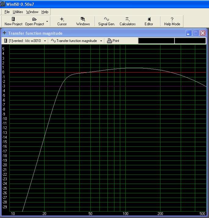

Thanks!I just installed WinISD Pro.I loaded the values but i seem to get totally different results.I've never used it before but i went through a tutorial step by step.
Let me describe it just after hitting the 'finish' button before any changes:
*80.35 litres
*Tuning freq 29.90 Hz
*4" dia 26.57 cm long port
*frequency response -3.033dB at 27.70 hz
0.006dB at 46.39 hz and peaks at 119.49 hz at 0.968dB before dropping.
I hope you get the picture.
My other concern is about the sensitivity,according to WinISD its 88.81dB/W/M but according to the datasheet its 93dB.Which is the real value?I thought sensitivity is a measured value rather than a calculated value?

The program returned an audibly insignificant alignment to mine, so at a glance it's a potentially viable design once damped. It chose too small a vent though due to it assuming a 1 W input, so in the SIGNAL tab, input 200 in the SYSTEM INPUT POWER window and check its REAR PORT-AIR VELOCITY plot with the understanding that you want it to be < ~17 m/s (and preferably lower) to keep it from audibly compressing and adjust the vent number/size as required to get predicted vent length. Note that it's a good plan to have all dims the same to avoid confusion (in, cm, etc.).
Its calculated sensitivity is a realistic one to design based on whereas a manufacturer's published measured one is often either a high inductance peak or break-up mode well above its intended pass-band, i.e. the audio industry's equivalent to the vehicle marketing horsepower 'race' of the '60s. Just like back then, 'when the flag drops, the B_S stops', so BW limit the driver to its nominally flat pass-band and its measured sensitivity in half space should be very close (if not spot on) to its calculated one.

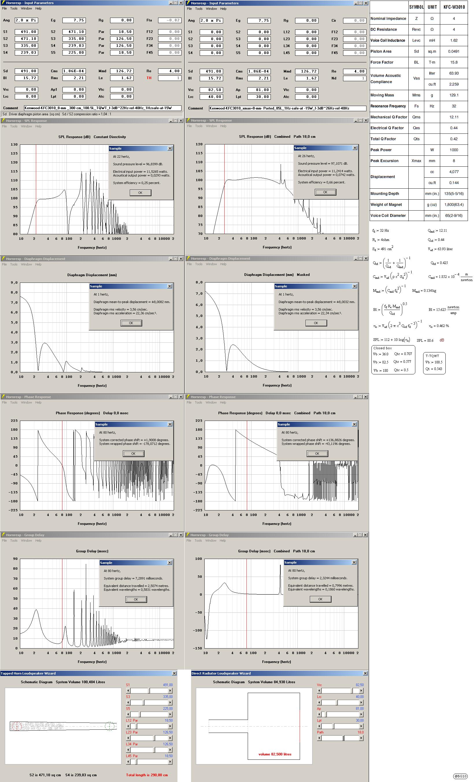

Transmission Line (TL) alignments encompass all 1/4 WL resonant pipe/horn layouts that don't have a well defined vent, so must be fine tuned with damping material for wide BW performance above its 3rd harmonic two octaves above its tuning (Fp), i.e. a 20 Hz Fp has a ~80 Hz 3rd harmonic dip and 'rippled' response above it.
Historically, an optimum TL alignment is stuffed until the driver's Fs impedance peak is ~completely flattened, ie. aperiodically loaded to present a ~matching impedance (DF = 1) to the low/power high output impedance amps of the day. Properly designed, it also flattens out the rest of the driver's response in its pass-band, so includes any mid bass hump in the response due to an excessively high voice coil (VC) inductance.
With the advent of ever increasing higher power and lower output impedance amps though, these alignments for the most part went the way of the Dodo bird and has only had a resurgence since MJK published his findings some years ago, then offering MathCad software to accurately design them and their mass loaded (vented) variants (MLTL, etc.).
Specifically to my remark though, today's mainstream drivers are designed to work in very acoustically small box volumes (Vb) with the trade-off being lower efficiency, so obviously more power is required to reach a given SPL which in turn means a larger, longer vent to keep vent compression low. At some point then, the vent becomes big enough in bulk that one might as well morph it with the box Vb to create a reverse tapered horn (TQWT) to increase loading/damping for a given bulk.
