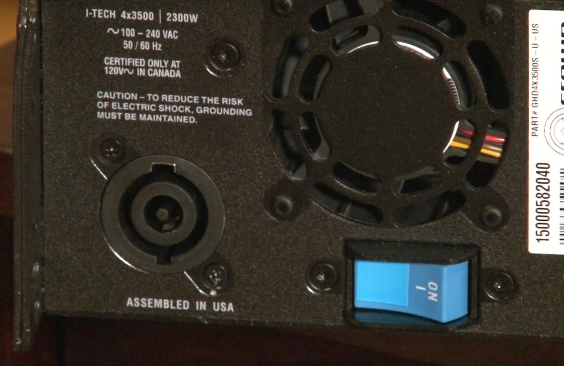

The iNuke12000 dosen't use an IEC, but a PowerCON. As far as fans go two fans according to the pictures:
For the thermal buildup, the iNukes are very good with low heat, I had my iNuke3000DSP running a 4 ohm channel at max power to a dual 18 (aprox 600w RMS) and a 2 ohm channel to 2x dual 10" Folded Horns (aprox 900w RMS) and I felt no heat on the amp.
The iNuke6000:
"USA / Canada 120V~, 60Hz (25A)
UK / Australia / Europe 220-240 V~, 50/60 Hz, (12A)
Korea / China 220-240 V~, 50/60 Hz,(12A)
Japan 100 V~, 50/60 Hz, (25A)"
it's not PowerCon i think..but it's like Crown 4X3500 mains connector.
anyway , that power rating is really a joke !! but it's not unusual from Behringer ! 🙄
