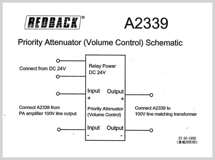

I have to do a 100v pa system with 10 speakers. Got plans about wiring but the plans weren't very specific on how to wire them so I ended up wiring individually 10 speakers which go to a networking rack where a mixer with amplifier should reside. The real problem is I just found out that the attenuator(volume pot) has a built in 24v priority relay which I believe should be to bypass the potentiometer(in case the rooms set the pot to 0 an emergency broadcast should bypass that, i think). The plans do not mention another wire except for the feed to the speakers. In fact in the plans, it says that main wire goes from the amplifier to the speaker, and from the speaker to the attenuator.
My experience with pa is absolutely 0. Can someone please tell me if the 24v relay should be powered from another wire?

there should be terminals on the amp marked for the priority function and yes you need a pair of wires for that
It’s hard to see as the documentation that I can find is vague but the amplifier 100V line output looks to be connected to the attenuator and the speakers are fed from the output of the attenuator. You do not mention the speaker ratings but a general rule of thumb is to choose speakers with a total power of no more that 90% of the amplifier power. In this case you should include the attenuator in the calculation, so maximum of 9 watts per speaker if they are the same power and a maximum total of 90 watts if they are of different power ratings. Depending on the efficiency of the speakers that will be quite loud at 100 watts.
