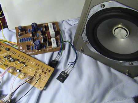

As promised friends I am posting the pics of the kit i tested
100 watt Amp kit i recently ordered.
Unfortunately there was no schematics with it so i am not able to post it.
I already requested the schematics from them , the kit is not costly so i am not bothered for schematics anymore.
The results were great .

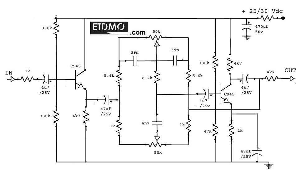

I have the Tone control schematics which i will post after i will get it scanned .
